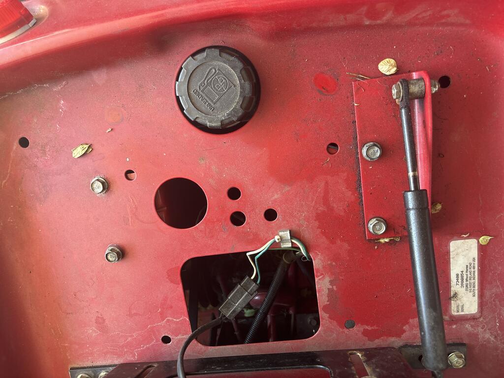

Lane Ranger 12,167 #1 Posted May 27 Did the c161 transmission have a dip stick under the seat to check fluid in hhe 8 speed transmission??? I know hydros had one but i dont recall seeing one on an 8 speed! 1 Share this post Link to post Share on other sites
ebinmaine 81,278 #2 Posted May 27 Yep. Theys there. 3 Share this post Link to post Share on other sites

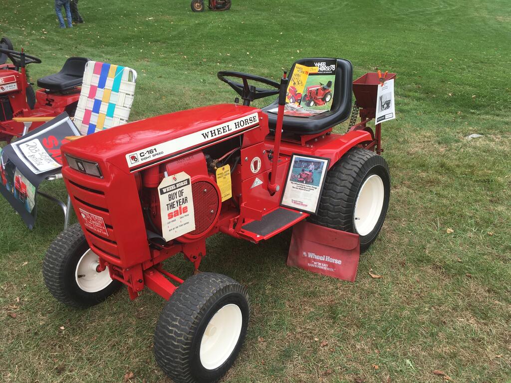

c-series don 12,751 #3 Posted May 28 (edited) I went looking for a photo of the seat pan on my C-161 8 Speed, I didn’t find one but I did find this picture of the whole tractor at @stevebo’s meet and greet 9 years ago! And yes all C-1_1’s had a dipstick in the seat pan. Nice thing about this tractor is that when you flip the seat up you will see Cecil Ponds signature he signed it at the last Big Show he attended. Edited May 28 by c-series don 4 Share this post Link to post Share on other sites

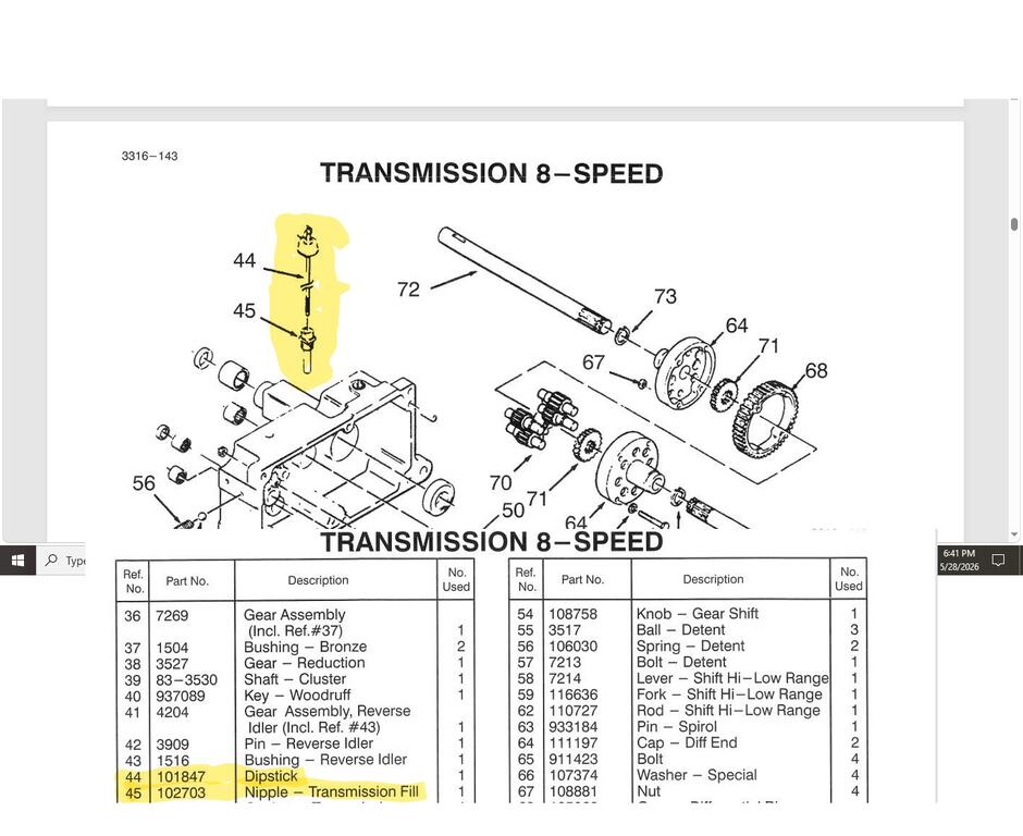

Lane Ranger 12,167 #4 Posted May 28 (edited) Yes i guess they did! Well i checked on the manual and now i do recall they had a fill tube at top of the 8 speed C-161 transmission. Edited May 28 by Lane Ranger 1 Share this post Link to post Share on other sites

Lane Ranger 12,167 #6 Posted May 28 So when did toro stop placing the rear dipstick in the 8 speed transmission in the toro models? My 314-8 does not have it. I think it is a 1993 model tractor. Share this post Link to post Share on other sites
Bill D 3,213 #7 Posted May 28 53 minutes ago, Lane Ranger said: So when did toro stop placing the rear dipstick in the 8 speed transmission in the toro models? My 314-8 does not have it. I think it is a 1993 model tractor. They started using the short ones. Look under the gas tank. 1 Share this post Link to post Share on other sites
kpinnc 19,105 #8 Posted May 28 (edited) 2 hours ago, Bill D said: They started using the short ones. Look under the gas tank. Or somebody broke it off and used a short replacement... Edit: Now that I re-read that it sounds like a personal problem but I have seen some crazy tractor parts swaps down here in the hillbilly side of the country. Edited May 28 by kpinnc 1 2 Share this post Link to post Share on other sites
953 nut 70,648 #9 Posted May 28 My 1993 310-8 has the short dipstick and nipple, what a PITA. Don't know when it all started but my 1987 312-8 had the long tube and dipstick. My guess is the bean counters at Toro figured out they could save a buck or two. 1 Share this post Link to post Share on other sites
