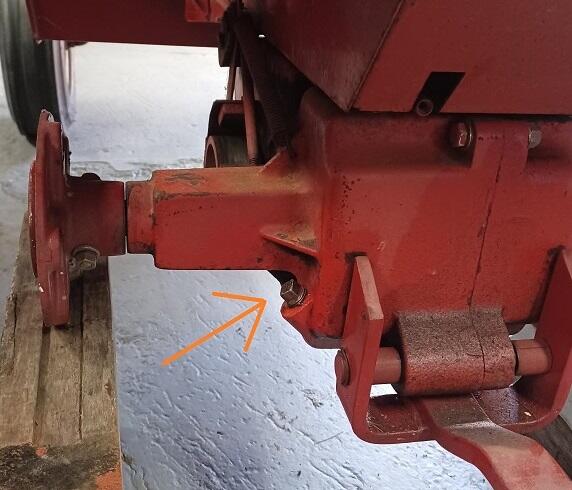

Digger 66 3,530 #8 Posted May 27 (edited) I hope this doesn't sound dumb and I'm only asking because there is another capped port under the fenders when you lift them but , is this the fill / level check ? It seems way too low to keep the axle seals lubricated. Edited May 27 by Digger 66 Share this post Link to post Share on other sites
ebinmaine 80,660 #9 Posted May 27 33 minutes ago, Digger 66 said: is this the fill / level check ? No 33 minutes ago, Digger 66 said: It seems way too low to keep the axle seals lubricated. Correct. That doesn't even get touched anymore. Drain from the very bottom of the transmission. There will be a plug right near the leg of that hitch, on the bottom. Lift the front of the tractor as much as you safely can while it is draining. That gets the oil over the hump in the bottom of the transmission case. Fluid capacity is 2 quarts. Plain and simple. 1 1 Share this post Link to post Share on other sites
Handy Don 17,467 #10 Posted May 27 Just to add on to @ebinmaine here... The arrow is pointing to the oil fill/level check port used on Unidrives before dipsticks came into use and there was an overlap for a few years before it was removed from the casting. With the plug out, oil should be just about to overflow out when full. Oil level at rest inside does not reach into the axle housing but in motion, oil finds its way through the inner axle bearings and to the outer bearings behind the seals. You might be surprised how close to the bottom of the case the internal gears are, i.e. the lowest edges are well submerged in the oil at rest, and they are very good at flinging oil all over the place in there 2 2 Share this post Link to post Share on other sites
