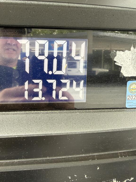

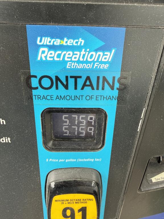

Sparky-(Admin) 26,890 #1 Posted May 23 Hit a show up in Mass with Tony @Docwheelhorse near Vermont which makes it an easy hop over into New Hampshire for some ethanol free fuel. Yikes! 3 1 1 Share this post Link to post Share on other sites
wh500special 2,474 #2 Posted May 23 With regular gas at $5, that’s not much marginal difference for your preferred flavor. I’m the odd man out on this forum: I avoid ethanol free gas… Steve 2 Share this post Link to post Share on other sites
Sparky-(Admin) 26,890 #3 Posted May 23 9 minutes ago, wh500special said: With regular gas at $5, that’s not much marginal difference for your preferred flavor. I’m the odd man out on this forum: I avoid ethanol free gas… Steve The 87 octane regular gas was $4.36. So I’m curious…why do you avoid it? 2 Share this post Link to post Share on other sites

squonk 48,427 #5 Posted May 23 1 hour ago, Sparky said: The face says it all! 1 3 Share this post Link to post Share on other sites
