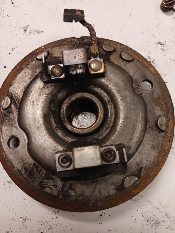

My starter was struggling on my lawn ranger,  so I removed it from the tractor for cleaning/ inspection.  What I found was that the brushes were worn.20260502_162908.jpg.17a55a15f919fa11bda7c1b8c6c70e9e.jpg
I cleaned everything,  put it all back together and tried it again, while I sourced parts. Performance was less than ideal. Once I got the brushes,  opened it up again and installed. When bench tested, the starter now functions as intended.

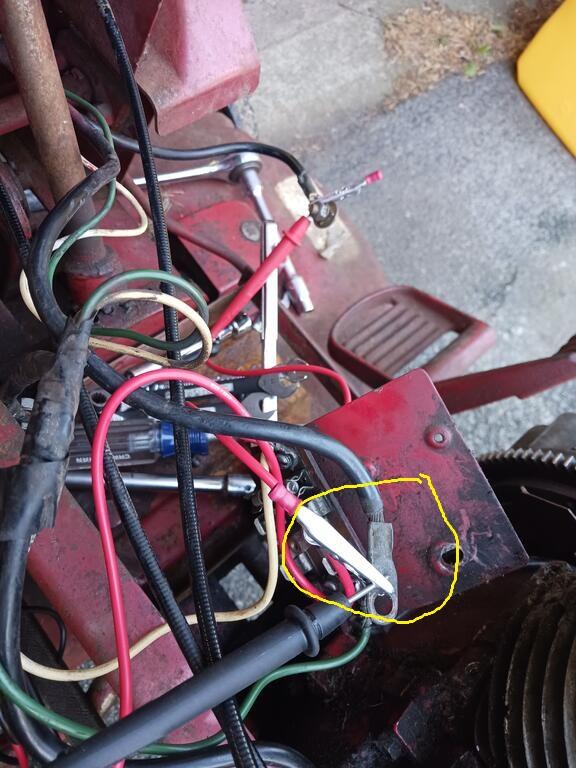

So I pulled out the multimeter and started testing pathways. Without a third hand,  I attempted to test continuity from the positive cable through the switch to the starter (cable). 20260510_102128.jpg.0b0d72a2b17db566a01aaaa47b21080b.jpg

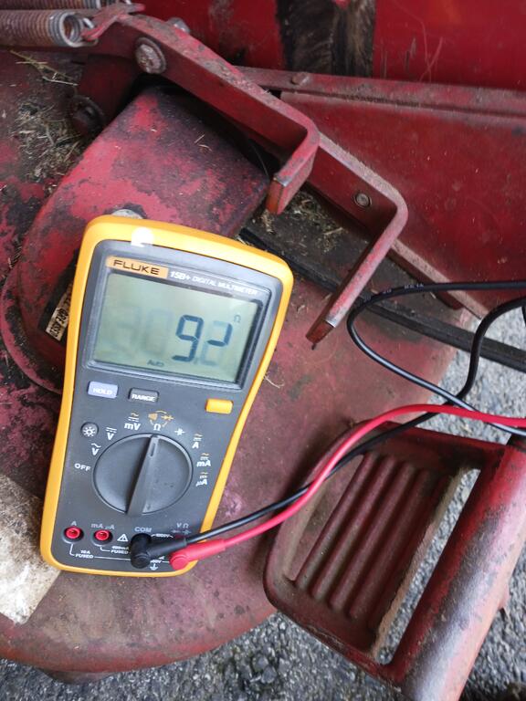

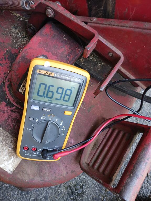

When I turned the key to the start position,  the meter spiked up,  then dropped,  not quite to open. 20260510_102218.jpg.294a4344956b647dfaf7db8cc74ee824.jpg20260510_102216.jpg.8aa31da20163ecb88224afbe08e44a67.jpg
That just doesn't seem right to me.  It was very difficult to get a picture while turning the key,  but it was repeatable.
Before I go further,  I thought it best to ask.  Is my logic sound? Is there something I am missing? And the ultimate question,  do I bite the bullet and replace the switch?
