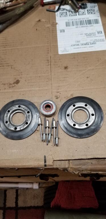

gt14rider 1,278 #1 Posted May 7 Hi all, trouble finding a good 1623. Can get the bearings local. My question is can I use these pop rivets or get solid rivets and peen them over? Thanks Share this post Link to post Share on other sites

peter lena 10,065 #3 Posted May 7 @gt14rider regular reference to this bearing issue , personally always go for the WIDE RUBBER SIDE SHIELDS , thats what you want ? unknown grease in there , small flat pocket screwdriver or small flat putty knife , easy removed with no damage at all , pop off both sides , Walmart , lucas x-tra heavy duty green chassis grease , wipe out all original grease , carb cleaner aerosol , flushing , hand pack bearing , reinstall seals , lube is 550 deg flash point , also polyurea rated , so it stays with the issue , done this in every related , pto driven bearing , guess what ? NO WHYINING BEARING NOISE , or related failures , @Razorback , personally love repetitive failures , track it down and kill it , make a change . mule drive bearings also re lubed , no belt squealing , just easy smooth wind up , that pto lever start up area is a GOLD MINE , for operational delight , heim joint end swivel , pete 1 1 Share this post Link to post Share on other sites
Ed Kennell 47,320 #4 Posted May 7 I use small bolts ,lock washers, and nuts....cause I have tons ofem. 5 4 1 Share this post Link to post Share on other sites

ri702bill 13,057 #6 Posted May 7 28 minutes ago, Ed Kennell said: I use small bolts ,lock washers, and nuts....cause I have tons ofem. I agree... I mill off the heads of the rivets and drive the body of the rivets out. Replace the sealed bearing with a new one. Buff the halves on a wire wheel before assembly. I use #5-40 Button head screws - 1/4" or 5/15" long with a dab of blue Loctite on the threads and then the hexnut. This way, they are easily rebuildable later on instead of riveting. a light coat of Rusty metal Primer and a spritz of red - better than new... 3 1 Share this post Link to post Share on other sites

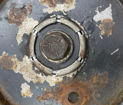

JoeM 10,267 #8 Posted May 7 There is nothing in those pulleys that has a high level of accuracy. Just a stamping with a bearing in the middle. I did the drill and bolt thing, just to time consuming. Now I take a grinder with a cut wheel and cut 6 slots. I started out using a chisel to bend the tabs but use the press to just push through the tabs. Pop in the new bearing and bend the tabs over. I have done at least a dozen with no problems. Just another option from an old bush mechanic. 4 3 Share this post Link to post Share on other sites

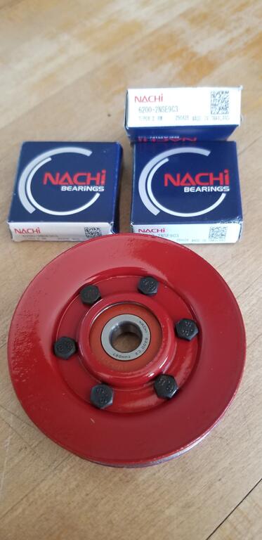

gt14rider 1,278 #12 Posted May 8 @Razorback, got the bearings, turned out to be metric, Nacho, bearing 6200 - 2NSE9C3. $7 and change. Had some 4mm bolts and lock washers and nuts, just had to wait for the paint to dry. 3 Share this post Link to post Share on other sites
