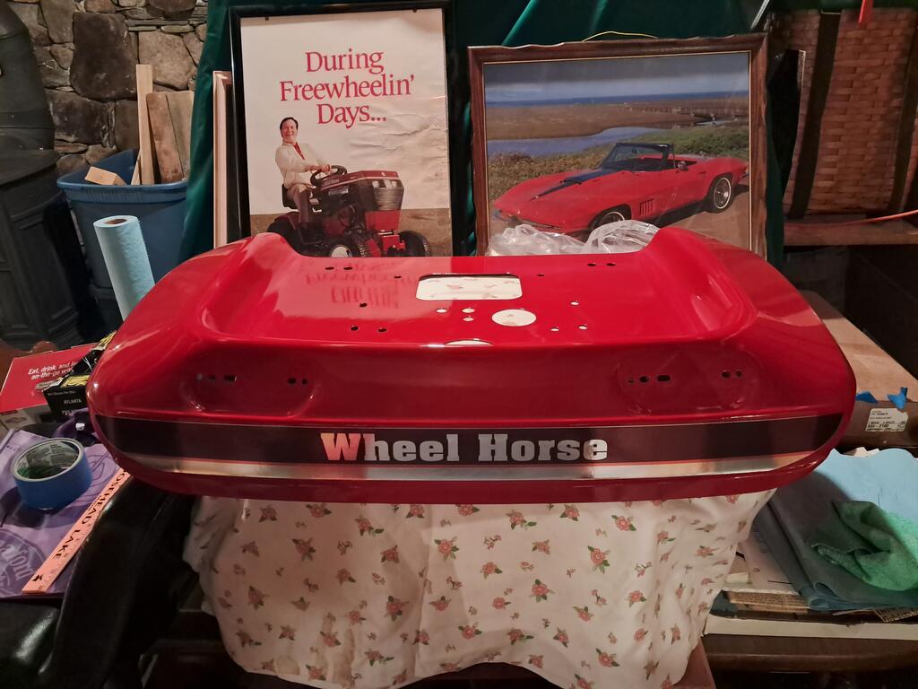

Bar Nuthin 3,642 #6 Posted May 5 (edited) If they're going over a fresh paint job, it's important to sand any dust nibs out of the paint with some fine wet-sand paper (like 1000 grit). I applied my neighbor's decals dry, but I have 50 years of bodywork experience. If you're not sure, use the soapy water (just a little soap in a spray bottle of water) technique with a squeegee (use a squeegee wet or dry). Also helps if you keep your fingers wet when handling the decal. I've installed my share of Trans Am chickens! A clean smooth surface is the #1 priority. Edited May 5 by Bar Nuthin 4 4 Share this post Link to post Share on other sites
