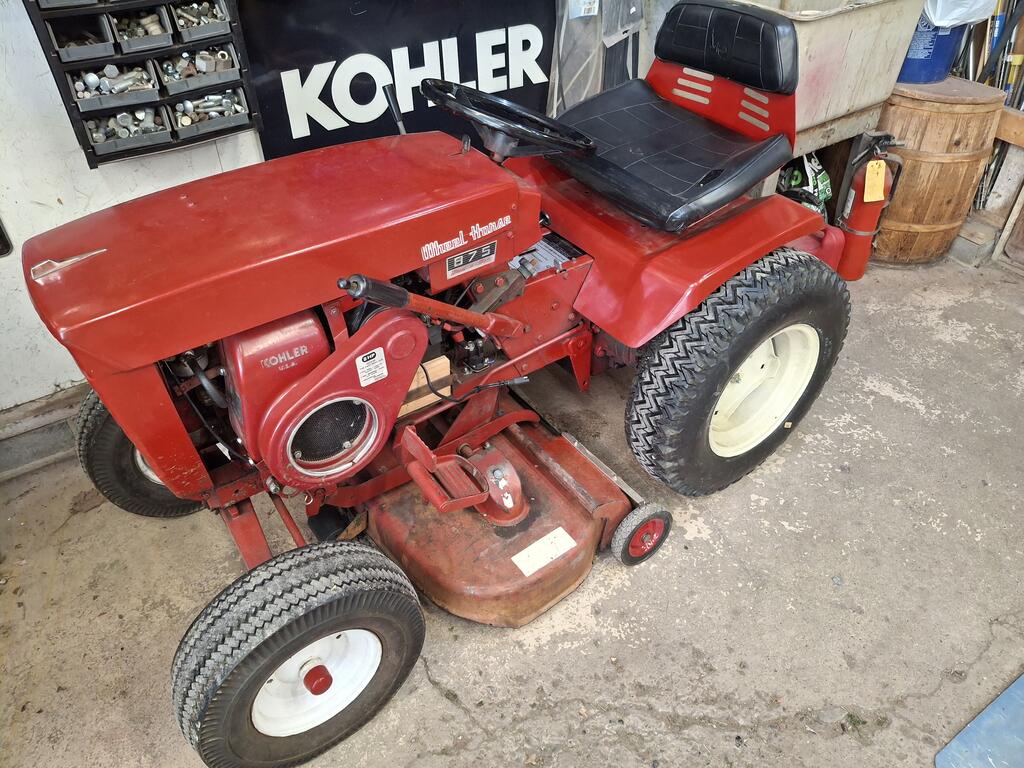

squonk 48,119 #2 Posted April 30 Yes. If you want the complete Start /Gen look you will have to either remove the ring gear from the flywheel or get the correct flywheel to use the non hump shroud. Same thing with the small blocks. This 875 has an engine from a B 80 2 2 Share this post Link to post Share on other sites

squonk 48,119 #11 Posted April 30 The starter and genny brackets bolt to the same 2 holes. I don't think there will be room for both, Never mind the electrical nightmare. The 8 HP genny and big block gennies are the same size. Only that 161 gennie is short. 2 Share this post Link to post Share on other sites

Sparky-(Admin) 26,359 #15 Posted May 1 Just to clear up the confusion in this thread. He has a 1057 with a Kohler 10 start gen that he feels the motor is “all-done”. The Kohler 12 he is considering is gear start and he wants to eliminate that and swap over all the start gen components from his 10 to the 12. 6 Share this post Link to post Share on other sites
