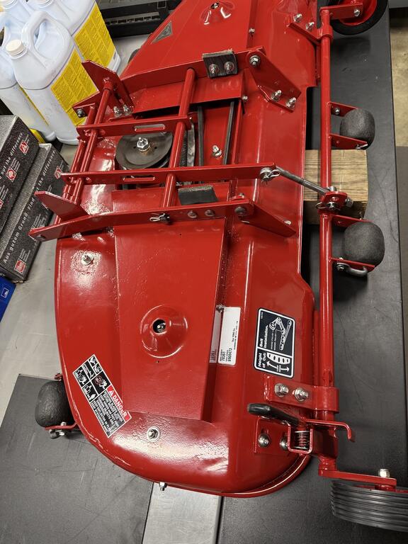

TractorEd
On a ‘79-ish C series with hydraulic lift, do we really adjust the lift lever chain/bar trunnion so that the rubber bumpers on the mower deck draft arms touch the bottom of the foot rests?
The geometry doesn’t seem like it would work since I’d have to raise the chain up a couple/several links to get the bumpers to touch the foot rests.  And that would cause other issues with removing/installing the deck as well as not being able to lower the deck enough to cut shorter.
There isn’t much lift with the hydraulic version.  My other C series has the manual lift and it has much more lift and making the bumper touch the foot rest is no problem and it will still be able to be lowered all the way to the ground.

c-series don
@TractorEd are these bolts at the top of the slot that they are in? That will help raise the rear of the deck when lifting.
  • Excellent 2
TractorEd
Posted (edited)
Well, I will check when I get home, but based on a photo I just looked at, after restoring this deck, I think I forgot to put those back in.  :crying-pink:
That’s probably it.  Thanks, @c-series don!

TractorEd
Posted (edited)
Those bolts were not installed and I misplaced them, but they are found along with the collars/sleeves.
Edited by TractorEd
  • Like 1
TractorEd
Posted (edited)
@c-series don
Bolts, collars & nuts installed.
and that did the trick!
Thanks again
Edited by TractorEd
