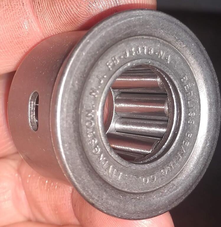

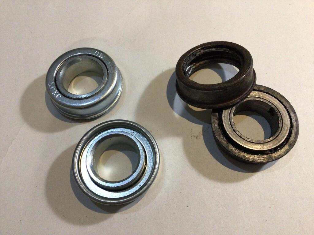

andrewLL 31 #1 Posted April 13 Hi, I’m just starting to restore a black hood and thought if I fix one of the front wheel bearings it will be easier to push around whilst I do other things. I’ve bought some new bearings but they’re not a patch on the original. Seem to be made from pressed steel rather than solid turned metal and also the bearings appear much smaller. Can’t see them lasting 40 plus years like the originals. 1 Share this post Link to post Share on other sites
wallfish 20,744 #2 Posted April 13 The pressed steel bearings are not as durable 6 Share this post Link to post Share on other sites

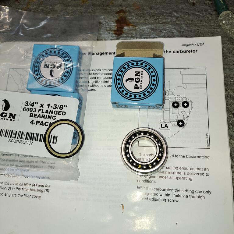

Achto 32,963 #3 Posted April 13 I like to use the sealed bearings. Usually get a couple hundred hours out of them. https://www.amazon.com/Pack-PGN-Flanged-Ball-Bearing/dp/B08HR2JNGJ/ref=sr_1_2_sspa 6 1 Share this post Link to post Share on other sites
sqrlgtr 4,225 #4 Posted April 13 i use the ones in the link Achto posted above. I like the sealed because it keeps the grease off of them newly painted wheels . 3 Share this post Link to post Share on other sites
WHX?? 58,388 #5 Posted April 14 It's been suggested before to pick the seal out, clean the grease out and repack with quality grease. Never used the ones above so don't know if that's required. Those bearings are a dime a dozen and I went thru a few of them until I found ones that were even half way decent quality. 14 minutes ago, sqrlgtr said: keeps the grease off of them newly painted wheels Trailer queens yes I leave the seal in. If I'm gonna stick it in the dirt I leave the seal out and re-grease. Those nifty hub caps Lowell sells helps keep dirt out. 3 Share this post Link to post Share on other sites

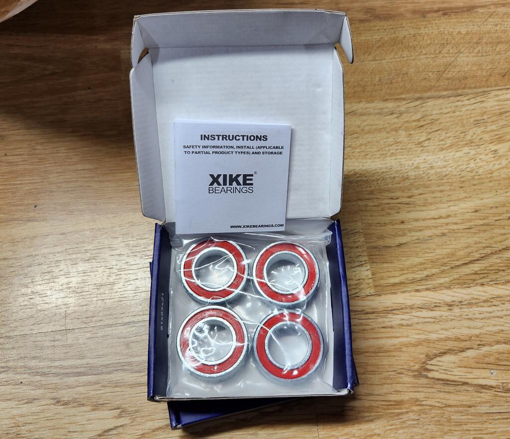

DLF 74 #8 Posted April 14 (edited) I have had good luck with the Xike wheel bearings. Put a set in the 312-8 in 2015 and a set in 1989 520 in 2019 .Might be time to pull the seals and grease them. I'm Lee 1977 Edited April 14 by DLF 2 Share this post Link to post Share on other sites

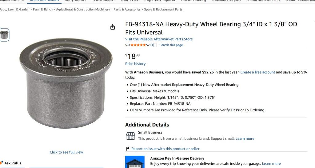

kpinnc 19,107 #9 Posted April 14 5 hours ago, andrewLL said: Can’t see them lasting 40 plus years like the originals I've kept a handful of those stamped bearings just for "get back to the shed" emergencies, but that is all they are good for. If, and only IF your spindles are in good shape then you can use Stens heavy duty bearings (see the pic below) and grease caps. Some folks prefer sealed bearings, I do not. A shot of grease every few months makes a mess but it will make a bearing last for decades. If I have to use sealed bearings, I remove the inner seals and make use of the grease fittings. 4 Share this post Link to post Share on other sites
WHX?? 58,388 #10 Posted April 14 8 hours ago, kpinnc said: Stens heavy duty bearings Source or PN KP?? 1 Share this post Link to post Share on other sites
kpinnc 19,107 #11 Posted April 14 1 hour ago, WHX?? said: 10 hours ago, kpinnc said: Source or PN KP The last ones I got from the jungle site. They aren't cheap. Just search for 3/4 wheel bearings. 1 Share this post Link to post Share on other sites
pfrederi 21,342 #12 Posted April 14 $80.00 to do the front of one horse...Ouch!! But if I was running a FEL might be worth it. 1 Share this post Link to post Share on other sites
WHX?? 58,388 #13 Posted April 14 5 minutes ago, pfrederi said: $80.00 to do the front of one horse...Ouch!! But if I was running a FEL might be worth it. Ouch is right I'm out ... I was thinkin for a plow mule they see some abuse too. Nice to know they are out there tho. 1 Share this post Link to post Share on other sites
sqrlgtr 4,225 #14 Posted April 14 Those Achto linked to above are the best ones I've seen for the money. I have also used those like @andrewLL has pictured just because I could get them local and haven't had any trouble out of those either, but they were almost twice as much money. @andrewLL I think you would be just fine using the ones you have, might not go 40yrs but still. 2 Share this post Link to post Share on other sites
kpinnc 19,107 #15 Posted April 15 7 hours ago, pfrederi said: $80.00 to do the front of one horse...Ouch!! But if I was running a FEL might be worth it. WOW they were expensive when I bought them but less than half of the current price. 1 1 Share this post Link to post Share on other sites

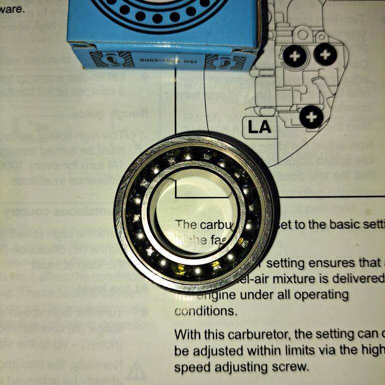

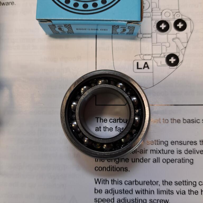

WHX?? 58,388 #17 Posted April 17 (edited) So I pulled the trigger on the bearings @Achto posted since i have a set to paint. They look pretty good ... fairly tight and only maybe a couple thou of wiggle. Picked a seal and yah very little grease in them so they will get repacked with greasy Pete. Edited April 17 by WHX?? 3 4 Share this post Link to post Share on other sites

sqrlgtr 4,225 #19 Posted April 17 10 hours ago, WHX?? said: Picked a seal and yah very little grease in them so they will get repacked with greasy Pete. Do you reuse seal or use new one? I figured I would ruin seal if I tried this . 1 Share this post Link to post Share on other sites
WHX?? 58,388 #20 Posted April 17 (edited) 19 minutes ago, sqrlgtr said: Do you reuse seal or use new one? I figured I would ruin seal if I tried this . Just reuse the old one. You won't ruin it use a a dental pick. Carefully get under the outside edge and it will pop right out and snap right back in. Leave it out if you intend to grease through the zerk. Only problem with this is the grease gun can pop the outside seal right out if too many pumps on the gun. Use Lowell's hubcaps then. https://wheelhorsepartsandmore.com/product/109154-2816-red-dust-caps-wheel-horse-qty-2/ Edited April 17 by WHX?? 2 Share this post Link to post Share on other sites
peter lena 10,125 #21 Posted April 17 @sqrlgtr like a small flat putty knife / flat pocket screwdriver for careful seal removal , wipe out original lube , spray carb cleaner for flush, then hand repack , reinstall seal , regularly buy bearings with the wide easy to remove seals , been doing this for years , no related failures or noise . the lube and seal combination , swap , has eliminated bearing issues for me , combine that with a pto lever start , detailing , and it has worked issue free for years . pete 1 1 Share this post Link to post Share on other sites
