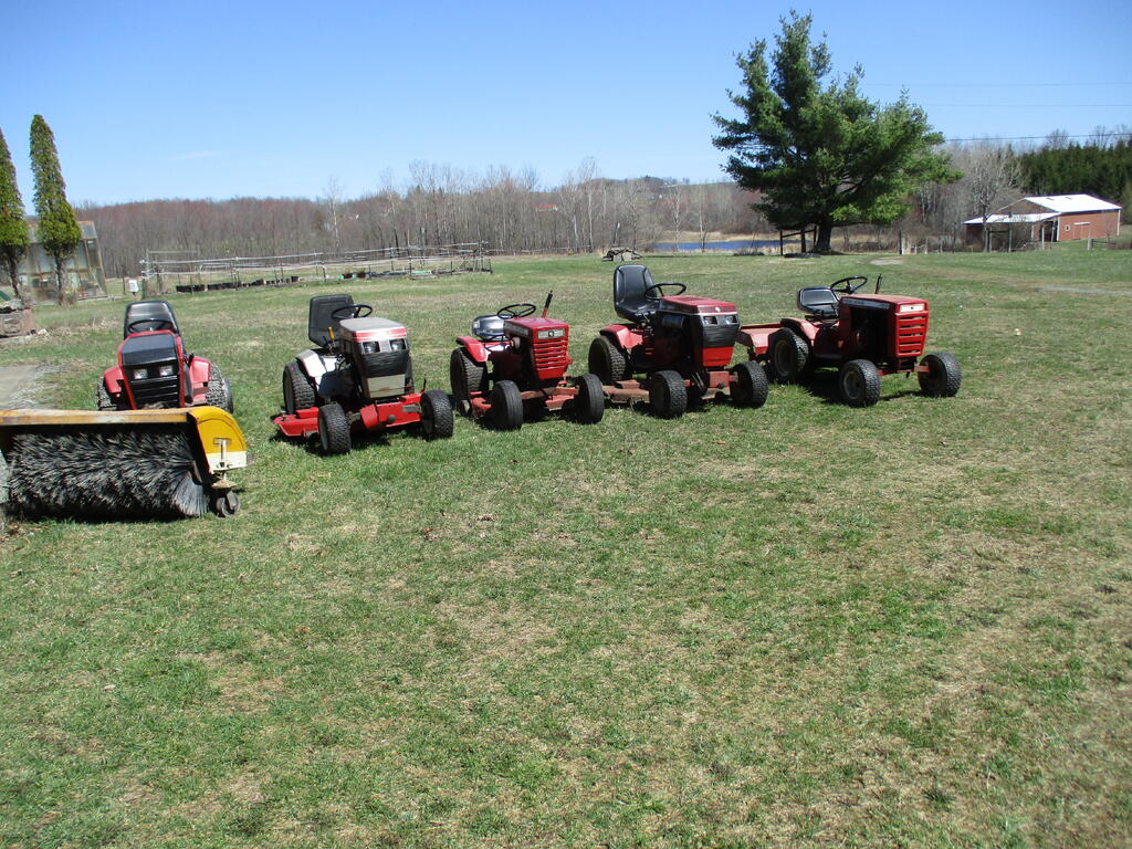

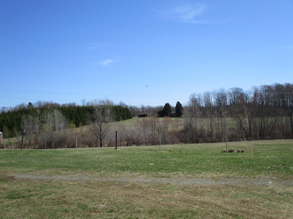

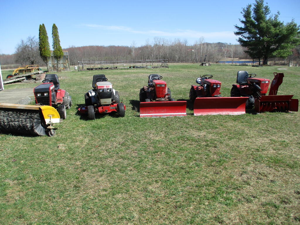

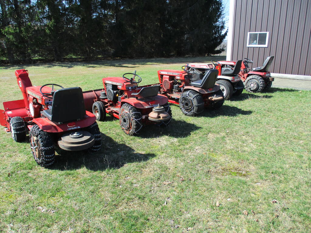

pfrederi 20,819 #1 Posted April 9 I do not change attachments any more to much bending reaching lifting etc. So today it was time to swap out the snow horses for the grass horses. Sweepster came down yesterday, no wind, got some the TWP road out of the yard and back on the road also the driveway, have some more to do but too windy today. Storage shed is in the distance up the hill. 2 17 Share this post Link to post Share on other sites
Wishin4a416 2,597 #2 Posted April 9 Nice herd! I agree. Changing attachments isn't for us seniors. 3 Share this post Link to post Share on other sites

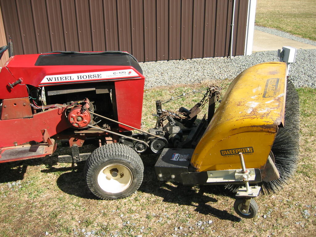

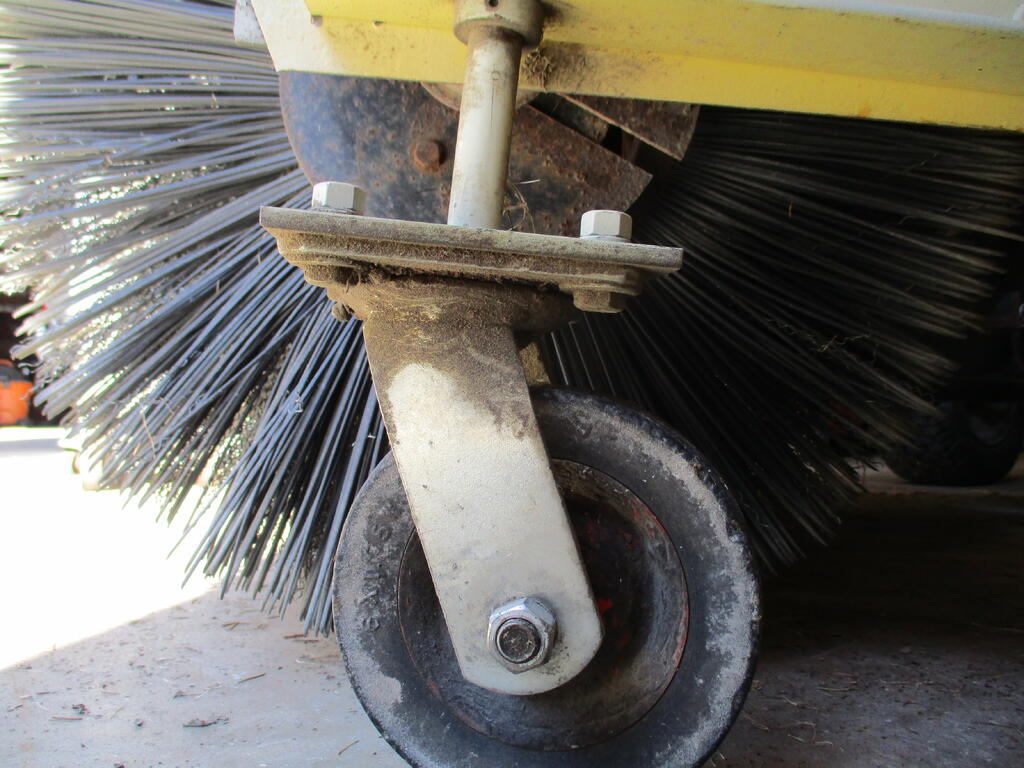

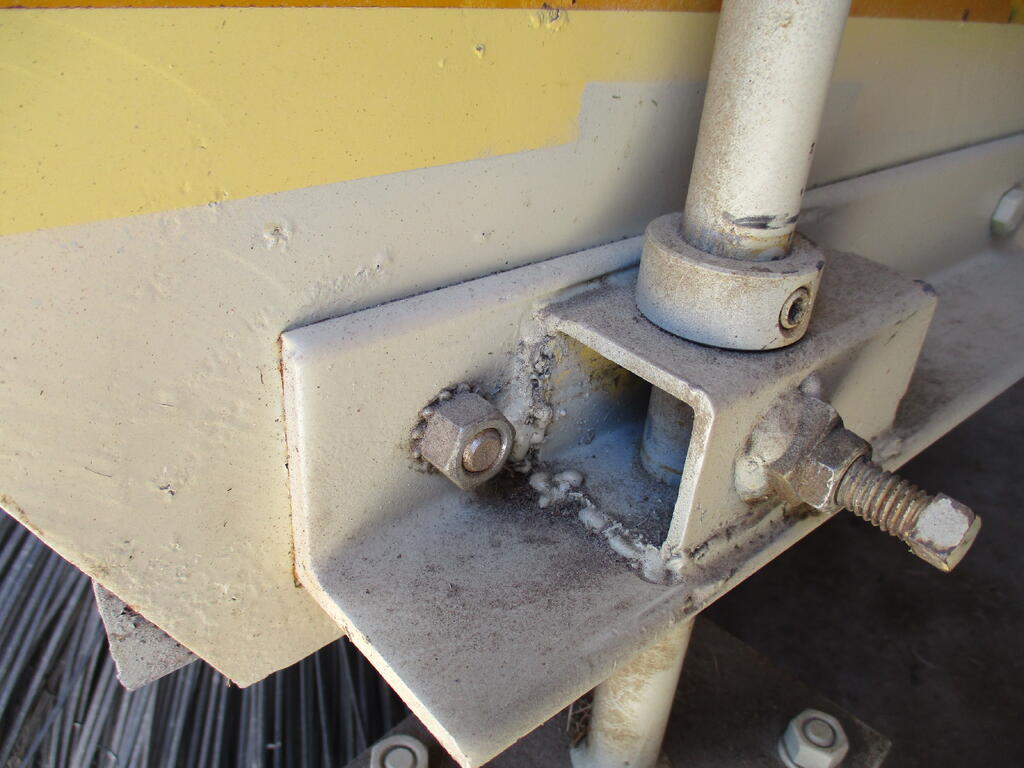

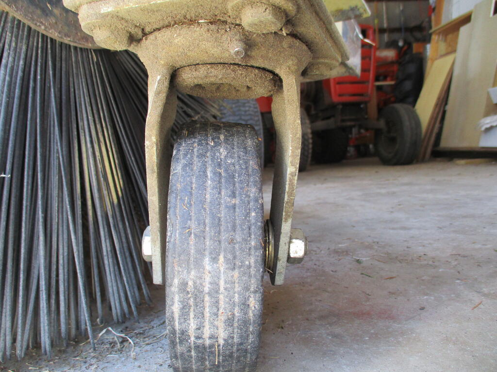

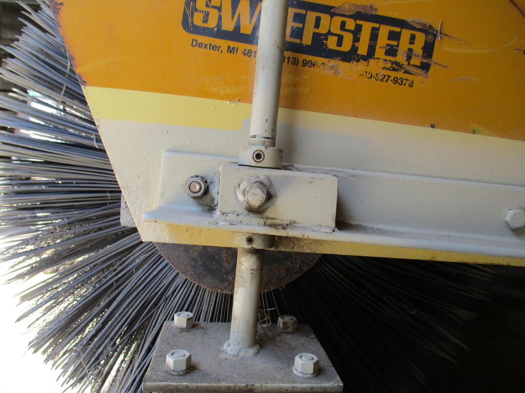

c-series don 12,045 #4 Posted April 10 @pfrederi Is that a C-48 or a C-60 Sweepster Broom ? It looks bigger than my C-48. Also I’d like to see better pictures of your caster wheels on the broom, mine doesn’t have any and I’d like to add some to maybe do a little de-thatching of my lawn. Share this post Link to post Share on other sites
pfrederi 20,819 #5 Posted April 10 1 hour ago, c-series don said: @pfrederi Is that a C-48 or a C-60 Sweepster Broom ? It looks bigger than my C-48. Also I’d like to see better pictures of your caster wheels on the broom, mine doesn’t have any and I’d like to add some to maybe do a little de-thatching of my lawn. I will take some pics in the morning I find the casters to be a necessity I have tried different set ups The pneumatic tires failed (Cheap Chinese tires ) 5 1 Share this post Link to post Share on other sites
pfrederi 20,819 #6 Posted April 10 Some pics Angle iron and sq tube 3/4 rod welded to a square plate that you can bolt the caster to. I had pneumatic tires but the kept going flat or ruptured the side walls. Using old deck wheels now. They sink in more when it is soft but at least they hold up. I live on a hill and have near constant breeze my annual sweep the rocks back on to the road should take an hour or so but usual spread over a couple days waiting for the wind to die or be in the right direction even so the thatch it picks up blows all over mostly back on me. It is 48"wide The electric lift is glacially slow 2 1 1 Share this post Link to post Share on other sites

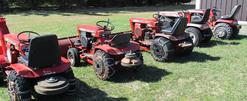

JoeM 10,070 #7 Posted April 10 Got any weights? I like weight too! especially in winter. @Pullstart can help if you have an issue lifting them! 1 3 Share this post Link to post Share on other sites

Goldnboy 1,126 #10 Posted April 12 Curious why the workhorse doesn't get snow duty? Share this post Link to post Share on other sites
pfrederi 20,819 #11 Posted April 12 (edited) 1 hour ago, Goldnboy said: Curious why the workhorse doesn't get snow duty? I got her as she had a nice deck and as a hydro wanted to use her with the cyclo-vac in the fall. Also I prefer Sunstrands for snow horse duties. They are not finicky about warming up before the hydro lift will work as some eatons are. The 418A was removed from snow duty years ago as she had to warm before she would raise tha snow blower to drive it out of the shop. And the Sunstrands have the 10 pinion LSD. Edited April 12 by pfrederi 3 Share this post Link to post Share on other sites
