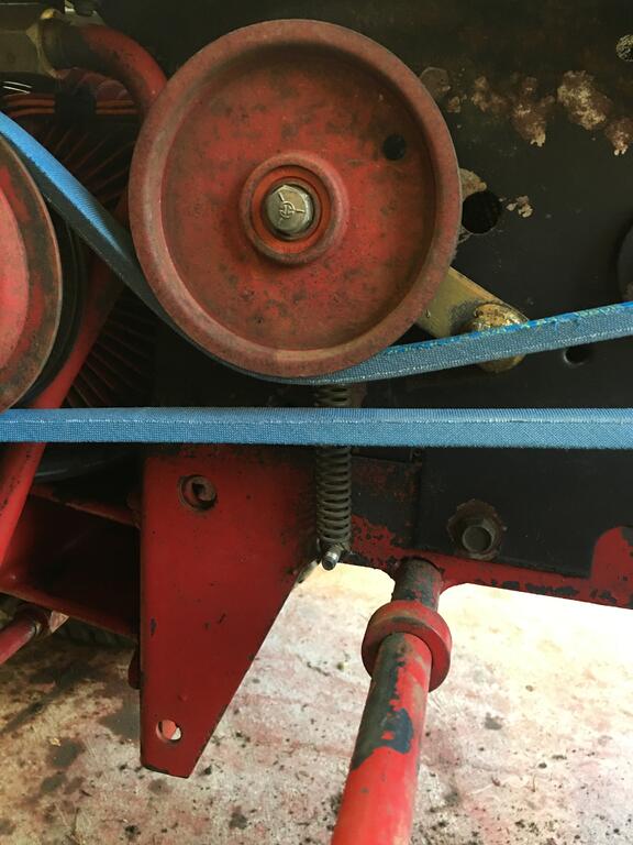

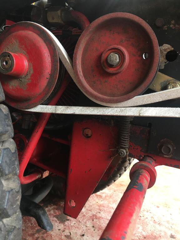

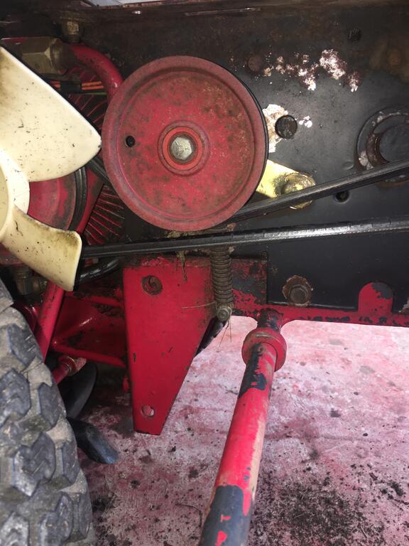

sqrlgtr 3,573 #1 Posted April 1 Ordered a new belt for the 520h that I had been working on but it seems a tad to long to me. Here is pics of new belt vs old belt. What y’all think run it or not? Im thinking not. Share this post Link to post Share on other sites

Ed Kennell 46,782 #3 Posted April 1 That new belt appears to be much wider than the old one? 1 Share this post Link to post Share on other sites
squonk 47,648 #4 Posted April 1 2 minutes ago, Ed Kennell said: That new belt appears to be much wider than the old one? Old belt was worn enough to sink down in the pulley. Share this post Link to post Share on other sites
squonk 47,648 #5 Posted April 1 1 hour ago, sqrlgtr said: Ordered a new belt for the 520h that I had been working on but it seems a tad to long to me. Here is pics of new belt vs old belt. What y’all think run it or not? Im thinking not. What year is that tractor. Probably doesn't make a difference but a 1990 model takes a Toro 114895 that crosses to the 5L7830. Any #'s on the old belt? Share this post Link to post Share on other sites
sqrlgtr 3,573 #6 Posted April 1 (edited) 28 minutes ago, squonk said: 1990 model takes a Toro 114895 that crosses to the 5L7830 @squonk That is the number (114895) I used to order this belt. No legible writing on old belt but it seems to be shorter when you hold them together in one hand and stretch them out. 35 minutes ago, Ed Kennell said: That new belt appears to be much wider than the old one? @Ed Kennell It seems to be same width across the top but it is thicker from top to bottom if that makes sense. It is indeed a 90 model. Edited April 1 by sqrlgtr Share this post Link to post Share on other sites
squonk 47,648 #7 Posted April 1 Go to Tractor Supply and get a 5L820 and a 5L810. Use the one that fits best and return the other and you'll be fine. It's a Hydro so you don't have to worry about clutching. 2 2 1 Share this post Link to post Share on other sites

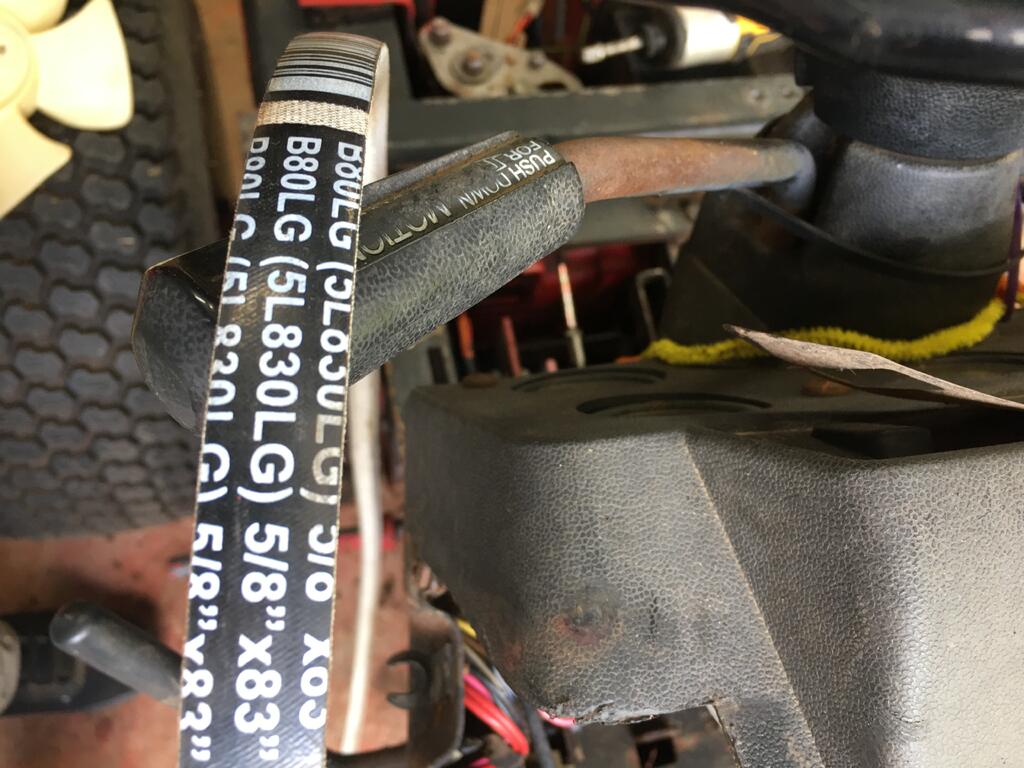

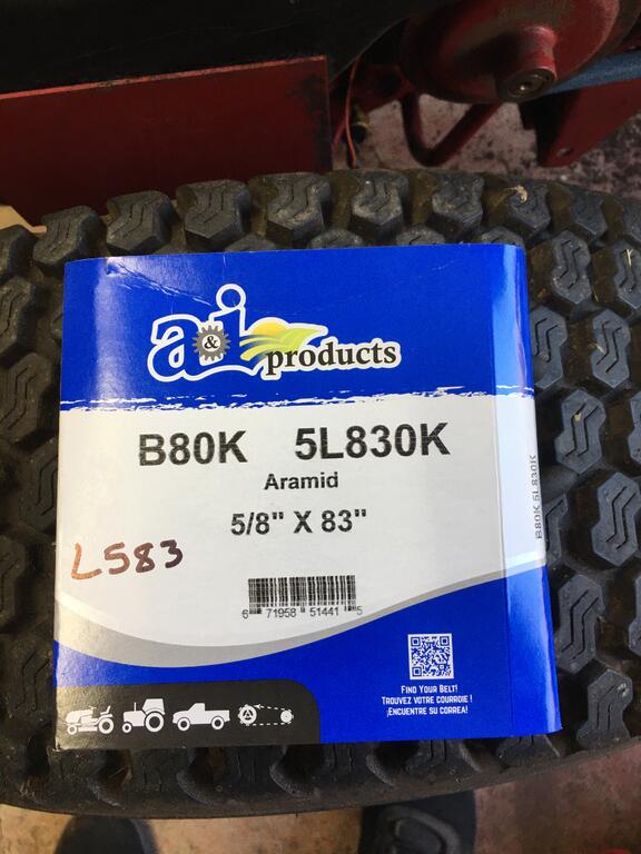

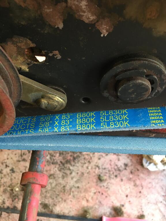

sqrlgtr 3,573 #8 Posted April 2 22 hours ago, squonk said: Go to Tractor Supply and get a 5L820 and a 5L810. Use the one that fits best and return the other and you'll be fine. It's a Hydro so you don't have to worry about clutching. Tried both belts and too short finally found one at auto parts store that actually used to be a WH dealer . And got the one below. Same size as white colored belt but has B80K in front of 5L830 while the white belt has B80LG in front of 5L830LG both 5/8x83”?????? Any way hope this may help someone in future. Looks close to idler pulley but has more clearance than the belt I took off of it and an inch shorter would just not go on. Share this post Link to post Share on other sites
squonk 47,648 #9 Posted April 2 25 minutes ago, sqrlgtr said: Tried both belts and too short finally found one at auto parts store that actually used to be a WH dealer . And got the one below. Same size as white colored belt but has B80K in front of 5L830 while the white belt has B80LG in front of 5L830LG both 5/8x83”?????? Any way hope this may help someone in future. Looks close to idler pulley but has more clearance than the belt I took off of it and an inch shorter would just not go on. Technically that belt should have been identical to the one you already had. Either it was stamped wrong or just a crappy belt mauufacturer Share this post Link to post Share on other sites
sqrlgtr 3,573 #10 Posted April 2 18 minutes ago, squonk said: Either it was stamped wrong or just a crappy belt mauufacturer My thoughts also, I ordered the first belt from a pretty good source, but I guess it could happen to anyone. Share this post Link to post Share on other sites
