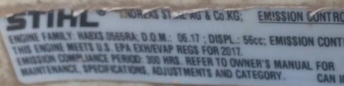

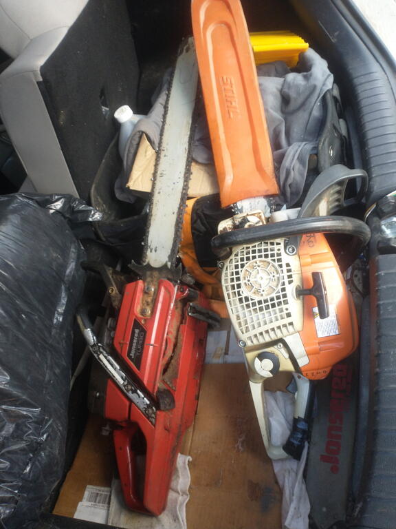

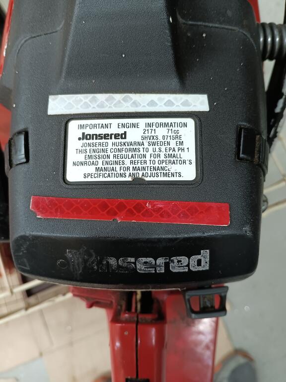

ebinmaine 79,493 #1 Posted March 29 Several months ago one of the other drivers at work mentioned he'd been given an old chain saw by his neighbor. He already had a newer one and his first thought was how Trina and I harvest our own firewood. He's been here to help and take some home in the past. Never even tried to start it or compare it to his current saw. He's not normally a person who keeps extras of anything so he offered the saw to us. That saw is a 1990 something Jonsered 2054 Turbo. The numeric designation back then meant Jonsered installed a 20" bar and the saw has a 53.6 cc engine. Round up to 54. No pics of it yet because I took it straight to my favorite small engine repair place. They'll check it over and advise. Likely (hopefully) just needs a tune-up and a bar & chain. I got to texting back n forth with @Stepney about it and he mentioned that he had another Jonsered that maybe I oughtta own. He came up for a visit yesterday and we swapped some machinery around. He showed up with TWO saws & left with a tractor. The Workhorse GT1800. The saws are a Jonsered CS 2171 and a Stihl MS291. Pics below. The label pic is of the Stihl. The 2171 is a 70.7 cc. Currently outfitted with a 24" bar. There's also the original 20" bar. That may end up on the 2054 if it'll fit. Interesting thing about this 71 cc saw is that I've occasionally wanted a larger more powerful saw than my current 49 cc Echo CS490. That's a great saw but every once in a while we tackle a larger tree. This year we're clearing more land and felling several bigger hardwoods. Excellent timing. The Stihl is a 2017 Model year. 56 cc. It'll need a repair to the spark plug threads and a tune-up, at minimum. I'll post follow up info as the repairs are done. With any luck I'll have three saws larger than the 49 cc. 7 2 1 Share this post Link to post Share on other sites

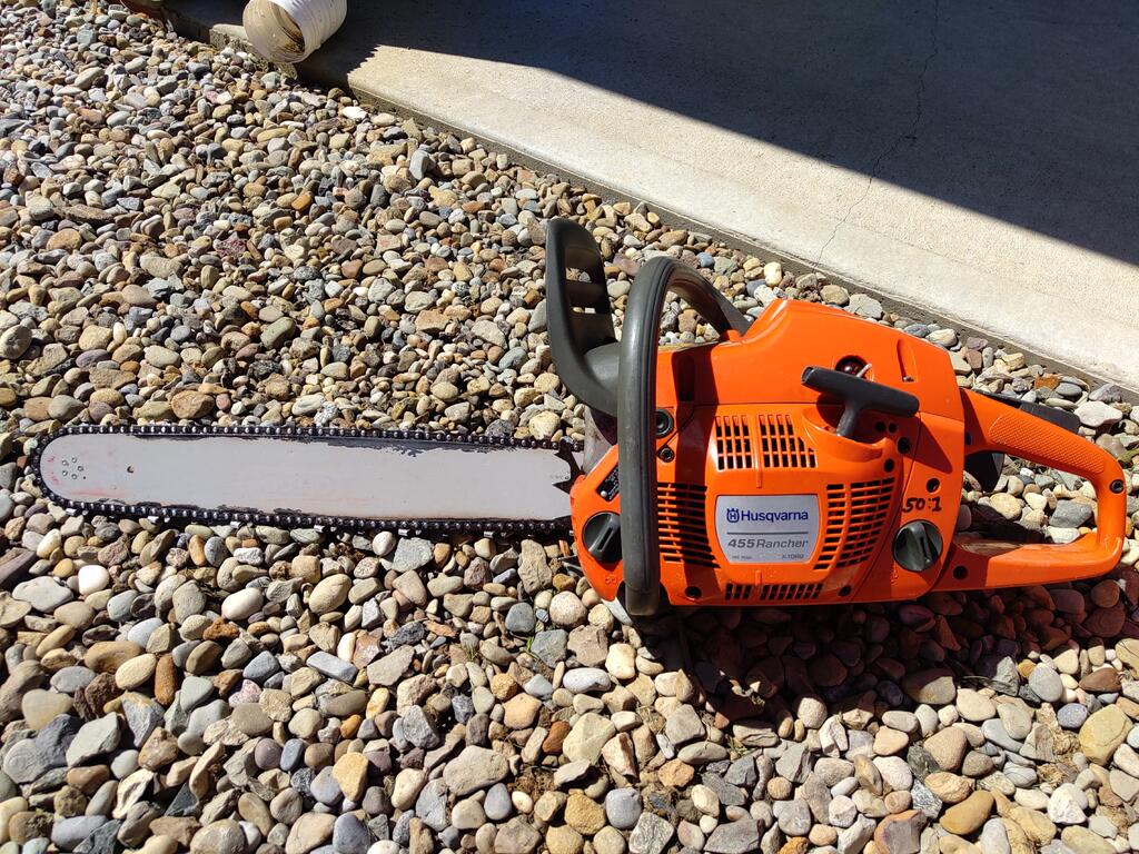

ML3 2,372 #13 Posted March 29 Nice score of saws! Although I no longer heat w/firewood I still keep my Husqvarna 455 Rancher. Have a carbide chain installed & its best $$ I spent. Ported & polished the head & matched/smoothed exhaust @head. Made a big difference in performance. Its definitely a handful & not for a novice. Cut a lot of wood for about 15yrs with this saw. My last house we would burn 7-10 cords of wood a winter. 2 1 Share this post Link to post Share on other sites

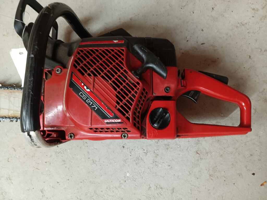

ebinmaine 79,493 #17 Posted April 1 Update on the two chain saws. As suspected, the Jonsered CS 2171 needs a cylinder and piston. The shop is looking for options for both OE and aftermarket. That'll very likely be fixed right and put to use here even if it's several hundred dollars. Those are highly regarded pro grade pieces. The Stihl MS291... also needs a cylinder and piston. That's a high-end homeowner type saw. It's not likely worth fixing. More details in the next few days. 2 Share this post Link to post Share on other sites

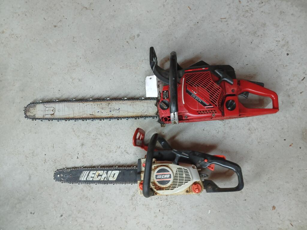

ebinmaine 79,493 #20 Posted June 24 Update! A few days ago I finally took the time to get the smaller Jonsered fired up and working and properly adjusted. That gives me two good solid 49cc saws. The Echo CS490 will keep the 18" bar. The Jonsered 2054 49cc will have the 20". Today I was finally able to get my Jonsered CS 2171 back from the small engine repair place! Basically a completely rebuilt engine. Crankshaft bearings and seals. Piston and cylinder. Rebuilt carb. Fresh tune. That currently has a 24" bar. I'm ordering a longer bar. 28" or 32"...(?) Depends what good deal I find. Here's my smallest chainsaw with my largest. Echo 33cc 16" bar. Jonsered CS 2171 71cc 24" bar. 1 Share this post Link to post Share on other sites
