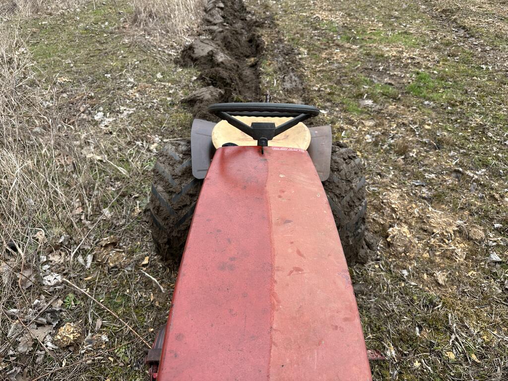

Pullstart 70,983 #1 Posted March 24 @peter lena this post is for you! I fed the paint and it’s wild seeing it spread over a couple days. Keep some oil on that old machine, it’ll keep making you happy. I rubbed some used motor oil on my 1445 Auto the other day. It’s about an inch wider now! I’ll eventually rub the whole thing, but I want to see how far it reaches. 11 2 Share this post Link to post Share on other sites

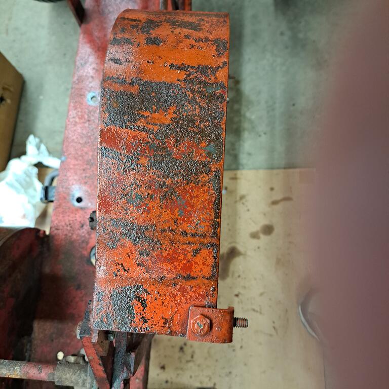

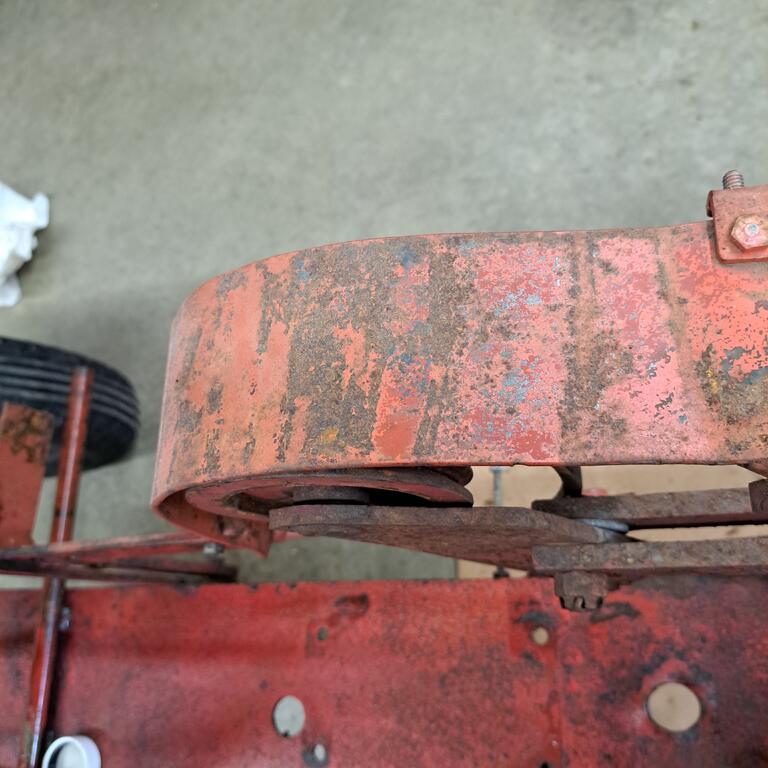

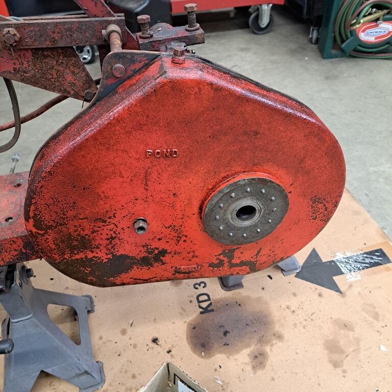

WHX?? 57,628 #17 Posted March 25 (edited) Chain case done with BLO. It's the only thing i would ever use. I tryed Marvel MO and it just don't cut it. BLO drys a bit glossy and dust on it rinses right off. It. It brings out the best patina. Cons are kind of a pain and messy to apply. Have to try a spray bottle. It also should be reapplied every so often. On 3/24/2026 at 8:55 AM, Lane Ranger said: Boiled linseed oil- ! Make sure to say that as it does matter Jim! Absolutely Lane That 60 yo paint just pops. Pics don't do it justice. Before and after. Edited March 25 by WHX?? 2 5 Share this post Link to post Share on other sites

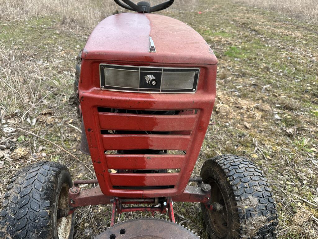

squonk 47,697 #18 Posted March 25 Rear fenders done with Penetrol. This pic is after a year of application. No slime and any dust blows off with a leaf blower. This is a pic after a month after application. Here's what they looked like before anything was done. 2 4 Share this post Link to post Share on other sites
