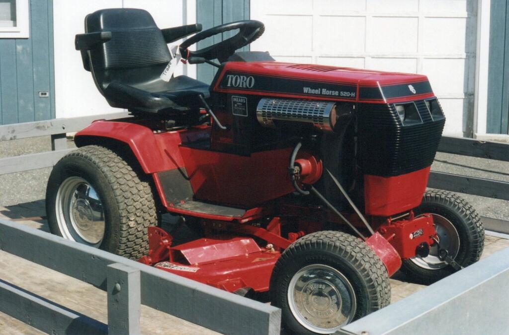

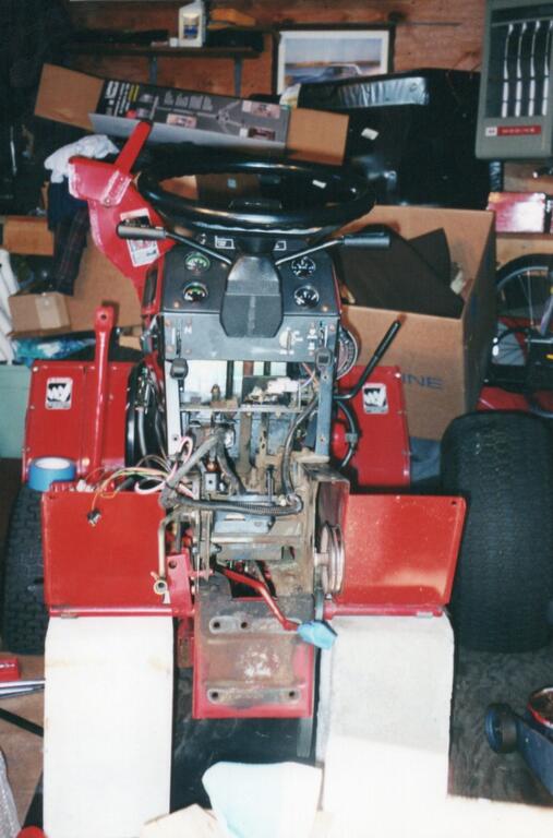

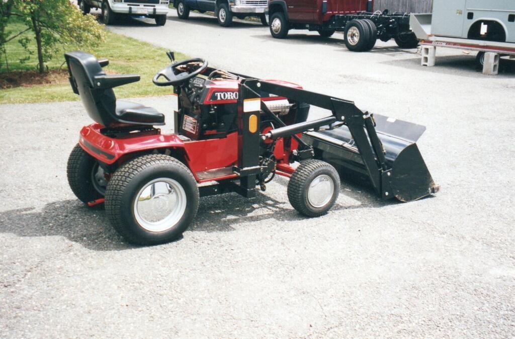

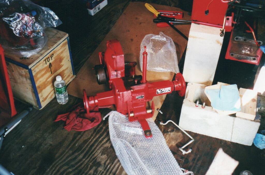

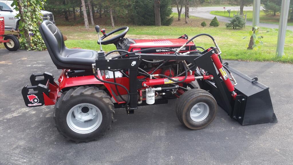

JCM 11,415 #4 Posted March 24 Bought my first 1993 520-H around 2001 from a dealer that took it on a trade for a Kubota for $ 2750.00. Then ended up taking the Eaton 1100 apart and sending the Pump out to have serviced. Strap it to a tree and make sure the rear tires spin in both directions. It was blowing the Hydro oil filters up to make them look like a frozen soda can. Kept it and sold it 3 or 4 years after to 2 friends, one still owns it. In 2002 I bought a one owner 1991 with 400 ish hours on it, still have it. The one in the picture with the Kwik-Way loader in the background is the 1991 I still own. Awesome tractors Good Luck 2 Share this post Link to post Share on other sites

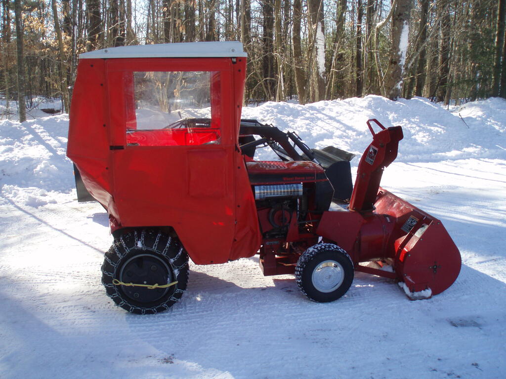

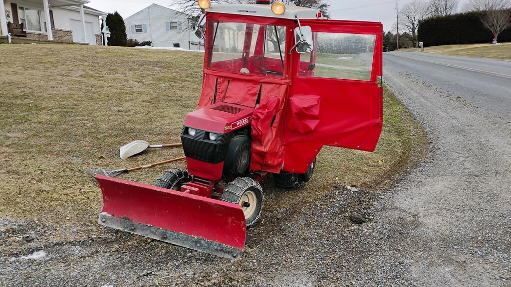

Ed Kennell 47,346 #5 Posted March 24 Think I paid $400 for my '88 about 10 years ago. It was neglected 900 hour horse with a badly surging engine. Three carb cleanings cured the surging. Decarboned, set valves, new RR, efuel pump, and replaced leaking gasket under oil filter base. Raised seat and fender pan 2" for better tire chain clearance and operator( comfort. Installed and altered the cab that I bought from @roadapples (rest easy Jay) to collect the heat from the rear cylinder thru the vented belt guard. Added a foot pedal motion control. The cab stays about 30* warmer than the outside temp in this dedicated snow plow/dozer machine. 2 2 Share this post Link to post Share on other sites

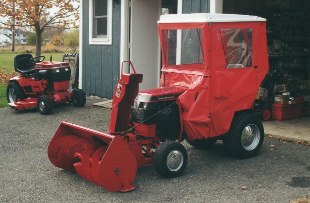

WHX?? 58,136 #10 Posted March 24 I'm on the way too high boat no matter where you are. I paid 1800 and came with a cab, snow blower, nice deck, tiller, leaf vac & genny. 4 1 Share this post Link to post Share on other sites

sqrlgtr 3,932 #12 Posted March 24 (edited) 10 hours ago, JCM said: It was blowing the Hydro oil filters up to make them look like a frozen soda can. @JCM Care to elaborate I have seen hydro filters done like this and never knew the reason/reasons. 12 hours ago, clip said: Asking price is $3000 way to rich for me but the 2 key words in that sentence are "asking price" Edited March 24 by sqrlgtr Share this post Link to post Share on other sites
JCM 11,415 #13 Posted March 24 1 minute ago, sqrlgtr said: @JCM Care to elaborate I have seen hydro filters done like this and never knew the reason/reasons. way to rich for me but the 2 key words in that sentence are "asking pricde" Pressure was too high. Sent it out to Michigan from MassachusettsThey told me what to check and report back before shipping it out. Had to buy a special guage and hose's to check it out. Once they knew the pressure they told me to ship it. That was 25 years ago. Still in service by another owner now. I found orange colored silicone inside pump housing someone messed with it before I bought it. 1 Share this post Link to post Share on other sites
