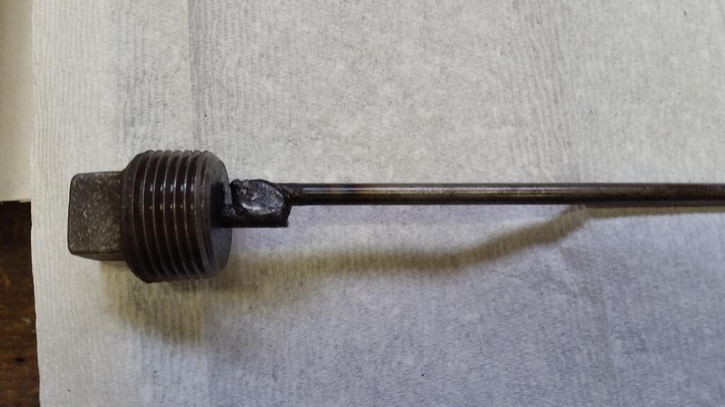

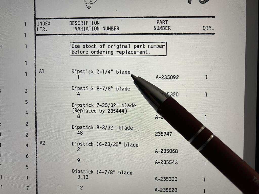

Retired Wrencher 6,989 #1 Posted March 23 (edited) How many of you fill to F mark? I was looking through the manual section on Kohler motors. I found out something interesting about how much oil to put in your engine in the manual for K241 it states to put 2 quarts. But another manual that has an update is an add to the full mark. So that’s what I’ve been doing. Also, I’ve heard that stored oil being new should be used within 3 to 5 years of purchase. That’s a new one on me. I guess it pays to read. Back in the early days I just did a quick scan and never really read the fine print. so I guess it pays to read more. Also lately I can’t seem to get a tan or brown on the spark plugs. Any thoughts on that? I’m running 93 octane E free fuel enjoy your day. PART #2 THIS IS MY DIP STICK. THIS DOES NOT JIVE. THE ONE I HAVE IS 9” LONG. THAT IS NOT IN THE MANUAL. I HAVE A 1057. HOPE SOME ON CAN CLEAR THIS UP. I WILL TAKE A PICTURE OF IT. I DID EARLEYER BUT DID NOT GO THREW.wi IMG_1089.mov Edited March 26 by Retired Wrencher 3 Share this post Link to post Share on other sites
Achto 32,699 #2 Posted March 23 (edited) I always fill to the full mark on the dip stick. I did know that oil has a shelf life, did not know how long that was. I never seem to have a container around long enough to cause concern. Edited March 23 by Achto 6 Share this post Link to post Share on other sites
702854boy 1,149 #3 Posted March 23 (edited) I usually either fill to the full mark or just slightly above since these are splash lubricated, it wouldn't hurt to have an extra half ounce to ounce of oil in them. Edited March 23 by 702854boy 4 Share this post Link to post Share on other sites

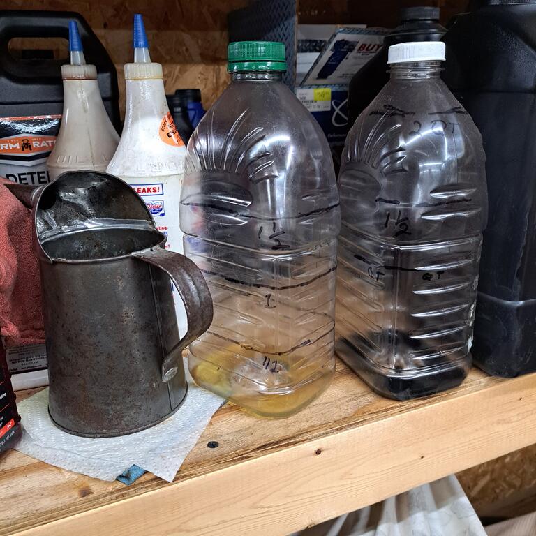

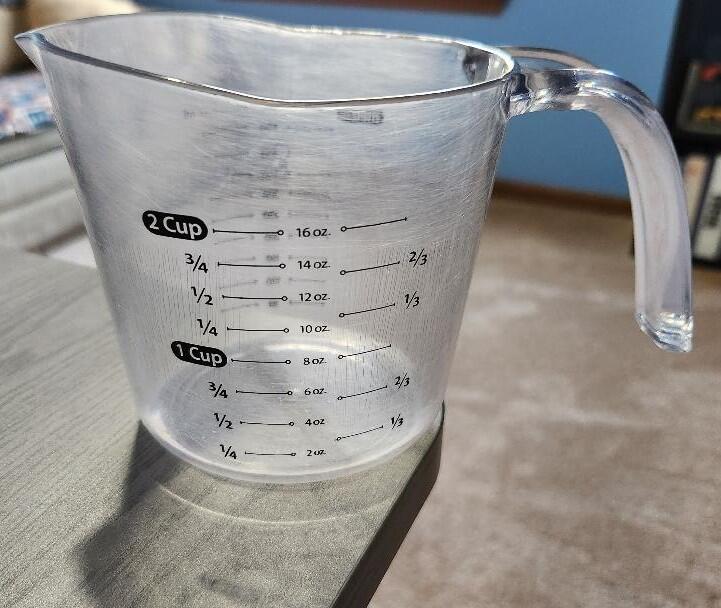

WHX?? 58,126 #4 Posted March 23 48 minutes ago, Achto said: container around long enough to cause concern. On the comment about dipsticks Its kinda hard to go by dipsticks when one looks like the one below. Given that most of our motors have been through many hands it's entirely possible the original stick has been replaced or modified. There was a post not long ago, Think it was from @rmaynard about more oil coming out than what was put in a motor. @Racinbob posted about measuring how much comes out comes out during a oil change and how much goes in using old juicy juice bottles calibrated by your wife's favorite measuring cup. Of all of Bob's crazy ideas this one seems to hold oil. In other words measure what you put in per the manual or published reading and see how that reads against the dipstick. Yeah I know a bit more PIA than just dumping a quart in and calling it a day but now you know how much is in it. 4 1 1 Share this post Link to post Share on other sites

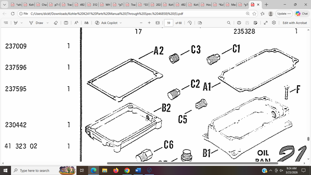

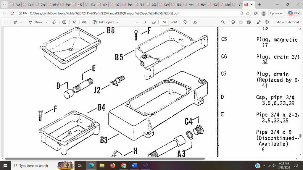

953 nut 69,312 #6 Posted March 23 Not all K-241s take two quarts of oil. The short oil pan units take 1 1/2 Quart and many industrial units take more than two quarts. 5 Share this post Link to post Share on other sites
WHX?? 58,126 #7 Posted March 23 4 minutes ago, 953 nut said: Not all K-241s take two quarts of oil. True Richard ... then there are these things called typos or fat fingers. 2 1 Share this post Link to post Share on other sites
953 nut 69,312 #8 Posted March 23 Plenty of K-241 oil pans to choose from. 3 Share this post Link to post Share on other sites
WHX?? 58,126 #9 Posted March 23 1 hour ago, 953 nut said: Plenty of K-241 oil pans to choose from. Just talking about that yesterday. Ford had one where the front axle went thru the oil pan. 2 Share this post Link to post Share on other sites

Retired Wrencher 6,989 #15 Posted March 24 (edited) 9 hours ago, C-85 said: I just changed the engine oil in my C-105 and it took about 1 1/2 qts, which is what the paper manual I have calls for. One thing to note, I believe this is checked by not screwing in the dipstick. C-85 Pull out the dip stick wipe clean then lay on the block next to the fill hole. A true way to check your oil. Edited March 24 by Retired Wrencher 1 Share this post Link to post Share on other sites
Retired Wrencher 6,989 #16 Posted March 24 21 hours ago, WHX?? said: On the comment about dipsticks Its kinda hard to go by dipsticks when one looks like the one below. Given that most of our motors have been through many hands it's entirely possible the original stick has been replaced or modified. There was a post not long ago, Think it was from @rmaynard about more oil coming out than what was put in a motor. @Racinbob posted about measuring how much comes out comes out during a oil change and how much goes in using old juicy juice bottles calibrated by your wife's favorite measuring cup. Of all of Bob's crazy ideas this one seems to hold oil. In other words measure what you put in per the manual or published reading and see how that reads against the dipstick. Yeah I know a bit more PIA than just dumping a quart in and calling it a day but now you know how much is in it. Jim good info there.I usually use a measuring cup. That way you know it’s correct. 1 Share this post Link to post Share on other sites
Retired Wrencher 6,989 #17 Posted March 24 21 hours ago, 953 nut said: Not all K-241s take two quarts of oil. The short oil pan units take 1 1/2 Quart and many industrial units take more than two quarts. Richard I believe my 64 k 241 has that short pan. So I’m assuming that takes 2 quarts? Share this post Link to post Share on other sites
pfrederi 21,150 #18 Posted March 24 (edited) If you know the spec number of your engine we can figure out what dipstick it is supposed to have and how long it is. Then you can be sure without resorting to a measuring cup....I seriously doubt a couple ozs one way or the other will make any difference in operation Edited March 24 by pfrederi Share this post Link to post Share on other sites
953 nut 69,312 #19 Posted March 24 3 hours ago, Retired Wrencher said: 241 has that short pan. So I’m assuming that takes 2 quarts? The short pan takes 1 1/2 quarts, the regular pan uses 2 quarts. 1 Share this post Link to post Share on other sites

Racinbob 13,192 #21 Posted March 24 On 3/23/2026 at 8:06 AM, WHX?? said: On the comment about dipsticks Its kinda hard to go by dipsticks when one looks like the one below. Given that most of our motors have been through many hands it's entirely possible the original stick has been replaced or modified. There was a post not long ago, Think it was from @rmaynard about more oil coming out than what was put in a motor. @Racinbob posted about measuring how much comes out comes out during a oil change and how much goes in using old juicy juice bottles calibrated by your wife's favorite measuring cup. Of all of Bob's crazy ideas this one seems to hold oil. In other words measure what you put in per the manual or published reading and see how that reads against the dipstick. Yeah I know a bit more PIA than just dumping a quart in and calling it a day but now you know how much is in it. Now if you're gonna tell these hairbrain stories about me ya gotta get it right. I was changing oil in a known 2 quart capacity engine. The hose was run into a 2 quart juice container. I opened the valve and went inside for some lunch. I came back out to find oil all over the floor. I was concerned about gas being pumped into the crankcase but didn't smell any. THAT'S when I took the bosses favorite measuring cup to check the capacity of that juice jug. Hmmmmm.......60 ounces. That being said, if there any question concerning the dipstick I'll dump the specified amount in the engine and, if needed, knotch the stick at the full mark. BTW, Boss lady ended up buying a new measuring cup and gave me the old one. 5 Share this post Link to post Share on other sites
WHX?? 58,126 #22 Posted March 24 (edited) Bob's not so patented juice bottles. One for dirty oil one for clean. I just marked them with a sharpie. But should come up with something better. I transfer the clean to the old school can on the left to dispence. Picked at a flea market for a buck. My only goal at this stage of life is to do an oil change and not spill a drop. Never gonna happen so now I purposely knock a can over and get the mess over with. Edited March 24 by WHX?? Speeling 2 Share this post Link to post Share on other sites

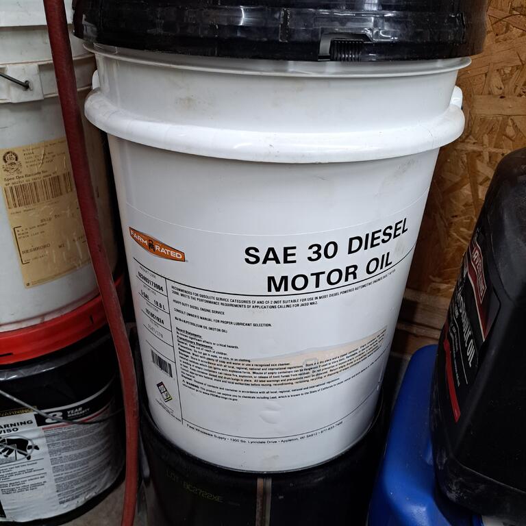

WHX?? 58,126 #23 Posted March 24 I buy it by the 5 gallon bucket since @Achtohas 20 tractors. I also use diesel in some tractors since it's designed to deal with soot better in some girls that have less than desirable rings. 3 Share this post Link to post Share on other sites
