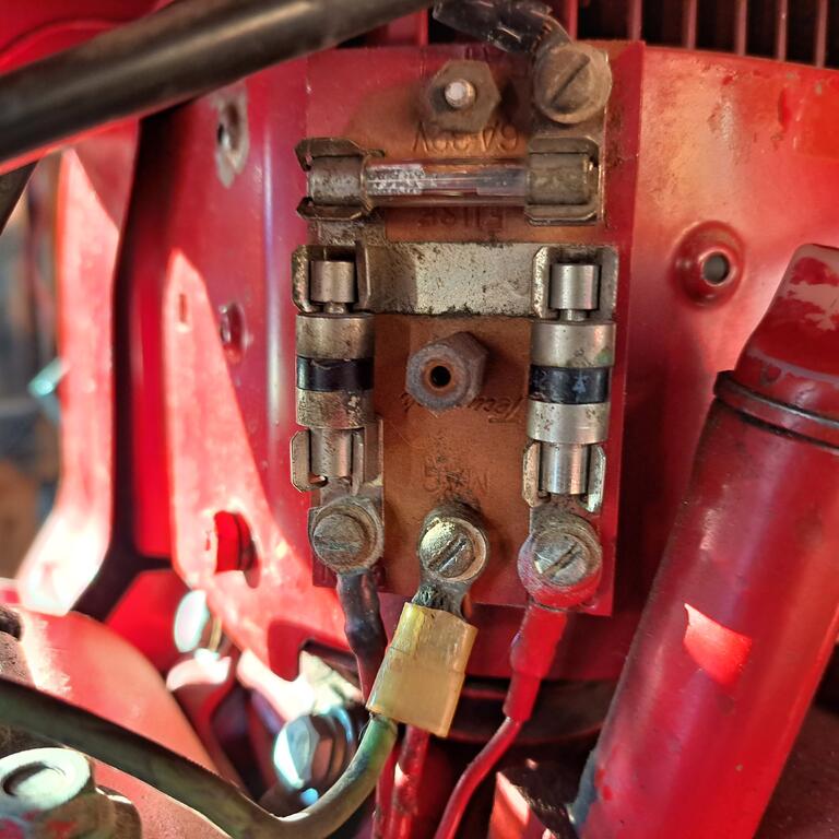

sqrlgtr 2,917 #1 Posted March 3 When installing didoes back in a 551 I assume i need them oriented were the juice flow toward battery correct. I smoked one or both this morning but I may have them installed wrong. Also had juice when unhooking Pos battery cable with key off or on. @squonk @Achto @WHX?? @953 nut Posted this in resto forum also but thought may get more attention here. 1 1 Share this post Link to post Share on other sites
Achto 31,792 #2 Posted March 3 1 hour ago, sqrlgtr said: When installing didoes back in a 551 I assume i need them oriented were the juice flow toward battery correct. Remove the diodes, hook your battery up. Use a multi meter to determine which terminals are hot or which ones have continuity to the positive battery terminal. The stripe on the diode should be towards the positive terminal on the battery. This allows the positive AC wave go to the battery but prevents the negative AC wave from going to the battery. Simple rectifier. Changing AC voltage to DC voltage. 3 Share this post Link to post Share on other sites
sqrlgtr 2,917 #3 Posted March 3 5 minutes ago, Achto said: The stripe on the diode should be towards the positive terminal on the battery. Thx that was what I was looking for I know I had seen this in Tecky manual before but could not find it anywhere for some reason. In my on defense I had a tooth pulled Friday and hadn't been myself for a day or two 1 Share this post Link to post Share on other sites

WHX?? 56,588 #6 Posted March 4 3 hours ago, sqrlgtr said: I smoked one Smokem if ya got em ... Read trough them with a multi meter. Usually they go in only one way because of the notch. Notch end or cathode up feeding the fuse and the battery. 4 1 Share this post Link to post Share on other sites

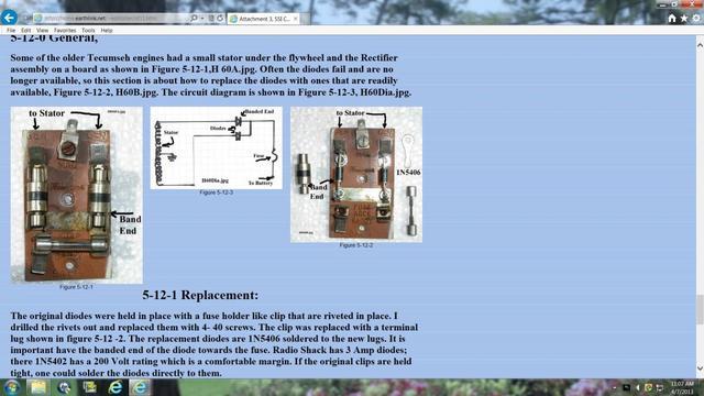

Lane Ranger 11,962 #8 Posted March 4 The posting Bill Allert made is the avenue I took with my Lawn Ranger Tecumseh motors. I rebuilt three rectifier boards with the 3 amp diodes from Radio Shack and the other parts that Ed Stoller mentioned. They work and do the same thing the original diodes did and they will produce the same electrical output! Ed Stoller did three articles in the Lawn and Garden Tractor Magazine a couple years ago that highlighted this issue. The bigger HH 100 Tecumseh 10 HP electronic coils are also an issue that many Tecumseh motor owners have dealt with. Ed Stoller came up with a solution for that one too! 1 1 Share this post Link to post Share on other sites
