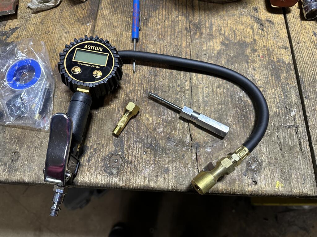

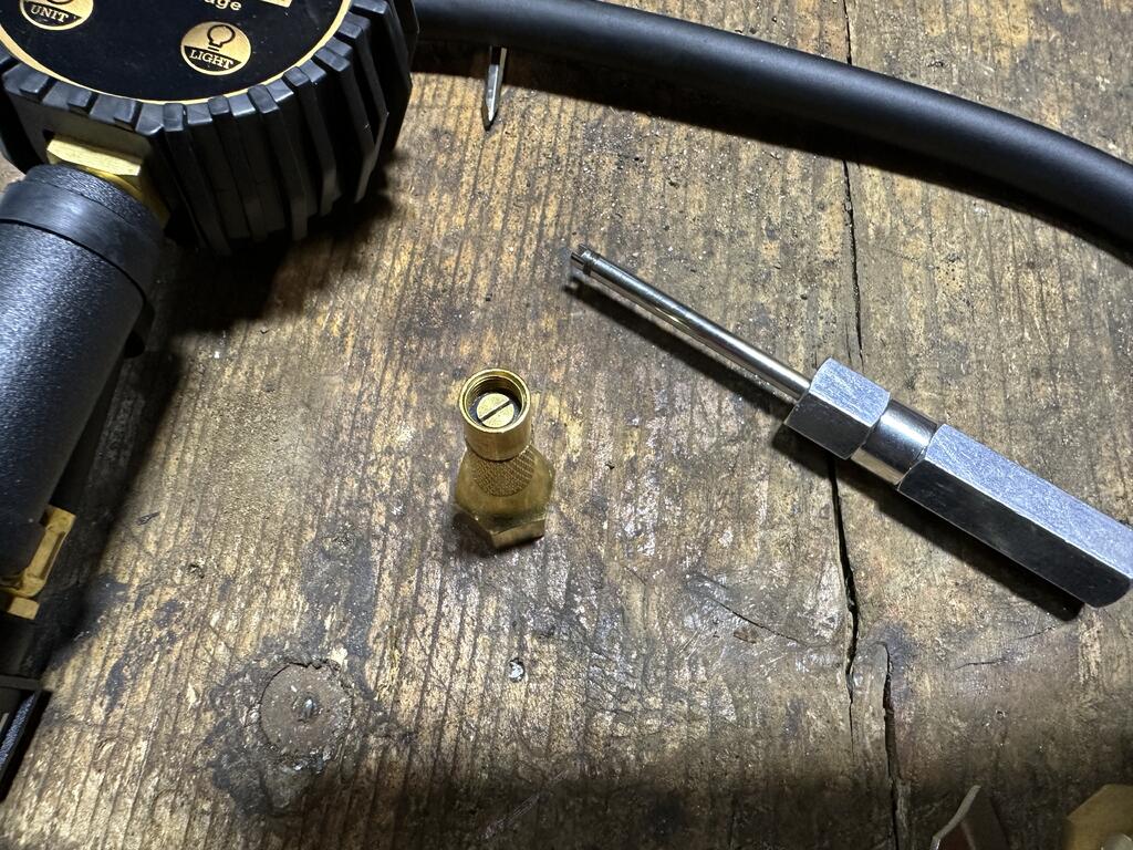

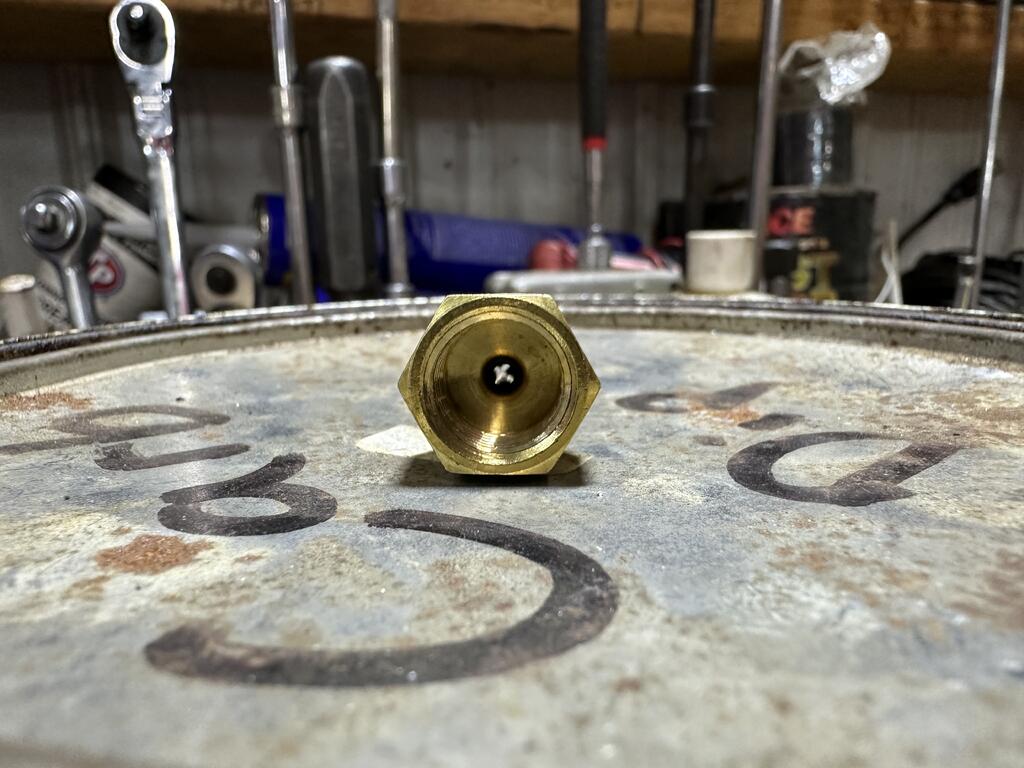

Pullstart 70,989 #33 Posted February 23 I got a new digital air gauge and filler upper combo deal. Putting the accessories away, I found what looks like a fluid putter inner! 3 Share this post Link to post Share on other sites
WHX?? 57,629 #34 Posted February 23 3 minutes ago, Pullstart said: I got a new digital air gauge and filler upper combo deal. Same one I got Kev but I didn't get the filler upper hooby doo. I got robbed For what I paid figure it lasted a year don't owe me anything. Going on two now. 2 Share this post Link to post Share on other sites

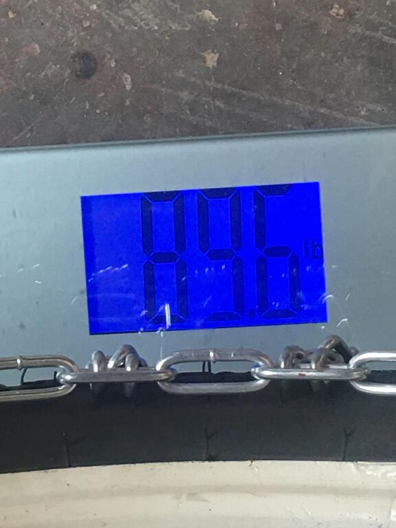

sqrlgtr 3,583 #36 Posted February 25 Finally got around to weighing wheels/tires after adding the RV antifreeze, wish I would have remembered to weigh them before adding . Figured it added at least 45/50 # to each side maybe a little more than that. 2 Share this post Link to post Share on other sites
ebinmaine 80,068 #37 Posted February 25 1 hour ago, sqrlgtr said: Finally got around to weighing wheels/tires after adding the RV antifreeze, wish I would have remembered to weigh them before adding . Figured it added at least 45/50 # to each side maybe a little more than that. At 6.5 gals per tire and usually around 8.5 to 9 lbs per gallon you'll have an additional 55 to 58 lbs per tire. Share this post Link to post Share on other sites
sqrlgtr 3,583 #38 Posted February 25 3 minutes ago, ebinmaine said: At 6.5 gals per tire and usually around 8.5 to 9 lbs per gallon you'll have an additional 55 to 58 lbs per tire. yup your probably right I was figuring weight of water, but the antifreeze is a little heavier. 1 Share this post Link to post Share on other sites
