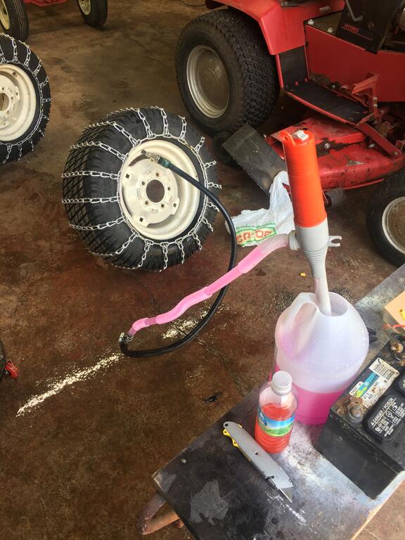

sqrlgtr 4,225 #1 Posted February 20 Got these chains wheels and tires in a trade the other day and thought I would make up a set of wheels/tires for snow. Used my cheapo fuel transfer pump, RV antifreeze and cheapo bleeder valve and it worked great. Pay no attention to the wet floor because that’s where I dropped and busted a gallon of antifreeze Wouldn’t have been much of a mess if I hadn’t done that. Wished I would have weighed them before adding antifreeze but will try and weight them before mounting to tractor. Got 6.5 gallon per tire and might have been able to get a little more but was one gallon short 😂 (23-9.50s). 2 10 Share this post Link to post Share on other sites

sqrlgtr 4,225 #5 Posted February 21 Running 11psi at the moment but will adjust if need be. Must have been pretty full because it didn't take much air to get 11psi in them. No tubes in these didn't want to break um down just to install tubes . This is second set I've went tubeless with the rv antifreeze; I May regret it later on but haven't had any trouble with first set so far.. Now the ol calcium ballast is a different animal. 3 Share this post Link to post Share on other sites

sqrlgtr 4,225 #22 Posted February 21 33 minutes ago, squonk said: It contains corrosion inhibitors so I'm not worried about a rot hole. Just start out with decent rims to begin with. @squonk My thoughts also. The little fuel transfer pump worked great for this. I keep filling and bleeding off until nothing but antifreeze was coming out, so they are pretty full. 2 Share this post Link to post Share on other sites
