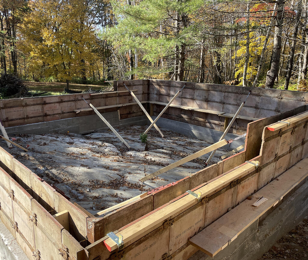

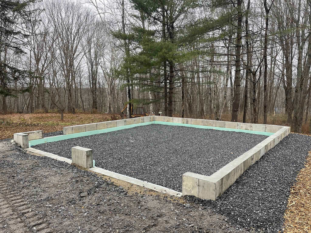

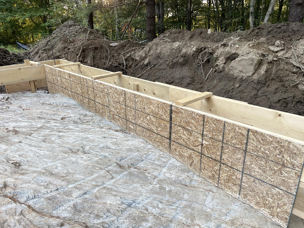

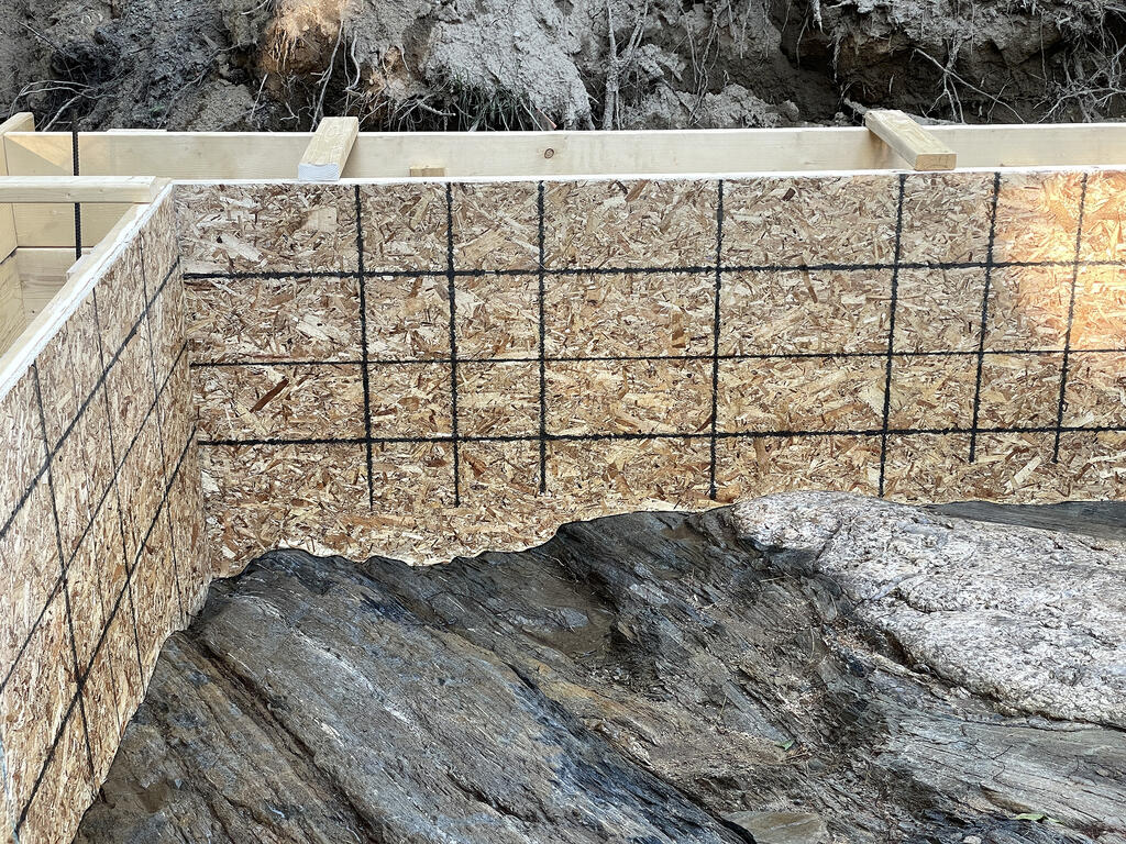

Blue Chips 822 #81 Posted February 10 (edited) On 2/10/2026 at 6:55 AM, ebinmaine said: Remember the mountain. I don't live on flat ground like most of you do. I literally live on top of a pile of Boulders and they are CONSTANTLY MOVING. On 2/10/2026 at 7:07 AM, ebinmaine said: In my area you cannot dig into the land for the installation. Likewise, where we are, it wouldn't be easy to dig very far into the ground, as ledge is protruding from many places in our back yard. Relating to the thread topic, the type of subsurface under a shop/garage/home can have an effect on one's heating and cooling costs. We've pulled some big boulders out here and there, but for the most part, our land is solid ledge, with areas of shallow soil and clay. Our current house was built directly on solid ledge, and the floor of the basement is the ledge itself. Even though the basement is not heated, and there is an open vent to the outside (our rather old boiler draws its air from the basement, which draws outside air into the basement), the ledge acts as a massive, high-density heat sink that helps keep the basement much cooler in the summer and warmer in the winter than if the floor was just typical concrete over gravel and deep soil. If/when we replace the boiler with a more efficient one that uses outside air for combustion, the basement will be even cooler in the summer and warmer in the winter than it is now. Likewise, the foundation of our new garage was poured directly on ledge, which made it a challenge to fit the forms to the rock. As an aside (pardon any interruption), I made a custom scribing tool to mark the forms accurately. Here are a few photos of the forms for the footings that went under the foundation walls of the new garage. Examples of footing forms scribed to fit the convolutions in the rock: Edit: I should add that when we poured the footings on the ledge, the surface of ledge had been thoroughly pressure washed and vacuumed to prepare it for pouring to assure a solid bond. Here's the garage foundation after pouring the foundation walls on top of the concrete footings, installing interior and exterior perimeter drains, backfilling, insulating the inside of the foundation walls, and filling with compacted crushed stone: Ledge/bedrock extends all the way down to our shore on the river (photo taken about mid-tide). Edited February 15 by Blue Chips 1 5 Share this post Link to post Share on other sites
ebinmaine 80,084 #82 Posted February 10 7 minutes ago, Blue Chips said: the foundation of our new garage was poured directly on ledge, which made it a challenge to fit the forms to the rock. As an aside (pardon any interruption), Not to get too far off topic but just out of curiosity. Were you required to have the bottom of your concrete a certain amount of inches below the surface? We were told before we started the barn project that the final ground surface would need to be a minimum 36 inches above the bottom of any concrete. Bed ledge or not. Share this post Link to post Share on other sites
Blue Chips 822 #83 Posted February 10 (edited) On 2/10/2026 at 1:57 PM, ebinmaine said: Not to get too far off topic but just out of curiosity. Were you required to have the bottom of your concrete a certain amount of inches below the surface? We were told before we started the barn project that the final ground surface would need to be a minimum 36 inches above the bottom of any concrete. Bed ledge or not. If you're talking about the garage foundation, if I recall, since 100% of the footing was poured directly on solid ledge, the freeze depth requirements didn't apply, and I cleared the plans with the building inspector prior to pouring. All phases of the project were inspected and signed off. Edit: Just to clarify, while it was my understanding that freeze depth didn't matter if the footings were poured 100% on solid ledge, the bottoms of the footings did end up deeper below finished grade than the impression one might get from the previous photos, since after the footings were poured, we erected another layer of forms for the foundation walls on top of the footings, so the tops of the foundation walls are higher than the tops of the footings. The foundation was inspected prior to backfill and approved. It was then backfilled after installing the perimeter drain system. Here's a photo of the next layer of forms on top of the footings just before installing the top courses of rebar and anchors: BTW, @ebinmaine, I don't know what the inspector would have said if the footing was only partially on ledge and partially on soil. Edited February 15 by Blue Chips 2 1 Share this post Link to post Share on other sites

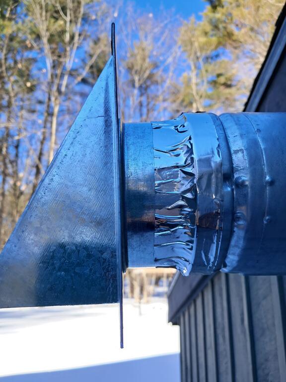

JCM 11,342 #87 Posted February 15 (edited) Keeping my promise Jim @WHX?? you wanted pictures of the 2 in 1 vent for the Modine heater with concentric on the outlet side. I used black aluminum screening with good ole aluminum tape. I had to make 2 vertical cuts on the storm collar to make it fit between the Battens on either side. Cheers Edited February 15 by JCM 2 1 Share this post Link to post Share on other sites
WHX?? 57,642 #88 Posted February 15 10 minutes ago, JCM said: pictures of the 2 in 1 vent Interesting Plunge. Yep I could see mud daubers going in there in the off season just like a camper. Lady bugs in the fall ... Some control boards cycle the exhaust blower on every few days without firing the burners to roust them out and it really does work. Nice the way you cut that storm collar in between the R B & B for trim. A true pro & we are definitely cut of of the same cloth! 2 Share this post Link to post Share on other sites

Blue Chips 822 #94 Posted February 15 (edited) 1 hour ago, WHX?? said: Some areas there are. The glaciers did some pretty cool things here. Got a trail at the cabin looks like your mountain. I call it rocky road & huge bolders & rocks. A very cool trail on the SxS. I lived in Minnesota for six years and did some work in Appleton, WI on and off for a couple of years, and while not as rocky overall as Maine, there are definitely a number of very scenic rocky areas, such as the Baraboo Range in WI and the rocky coast and cliffs along the North Shore of Lake Superior in MN, to name just a couple. As to the use of local rocks here in Maine, the basement of the antique Federal Period house that we restored and sold a couple of years ago had some pretty hefty stones in its foundation, and these weren't the largest ones. Unlike our current residence, which was built directly on bedrock/ledge, the antique house was built on sandy glacial till, and these stones would have been hauled in from some distance away. "Power equipment" in those days would have been a team of oxen. We didn't want to cover up the beautiful stonework in the foundation, especially after going to so much work to clean, grout, and re-point it all, so we insulated the outside of the foundation walls below grade instead of the inside, which also provided an opportunity to install a perimeter drain system. Unlike many basements in old Maine houses, this one is now dry. Edited February 15 by Blue Chips 1 2 1 Share this post Link to post Share on other sites
Handy Don 17,193 #95 Posted February 15 1 hour ago, Blue Chips said: install a perimeter drain system. So little incremental cost on a new build, but very dear as a retrofit, sooo valuable. The ONLY time we’ve had a water incursion was when the pump failed and we didn’t notice. Duh. Shoulda had an alarm in the first place! 2 Share this post Link to post Share on other sites
Blue Chips 822 #96 Posted February 15 1 minute ago, Handy Don said: So little incremental cost on a new build, but very dear as a retrofit, sooo valuable. The ONLY time we’ve had a water incursion was when the pump failed and we didn’t notice. Duh. Shoulda had an alarm in the first place! Yes, very much worthwhile. I already had to excavate around the entire foundation of the house for doing the extensive foundation repair work, so the only extra excavation that was needed for the perimeter drain system was a long (and deep) trench that led to a daylight exit on the side of a slope maybe 200 feet from the house, so the system drained by gravity...no pump needed. I have a loader/backhoe, so I did all of the excavation and backfill work myself, which saved thousands. Share this post Link to post Share on other sites
