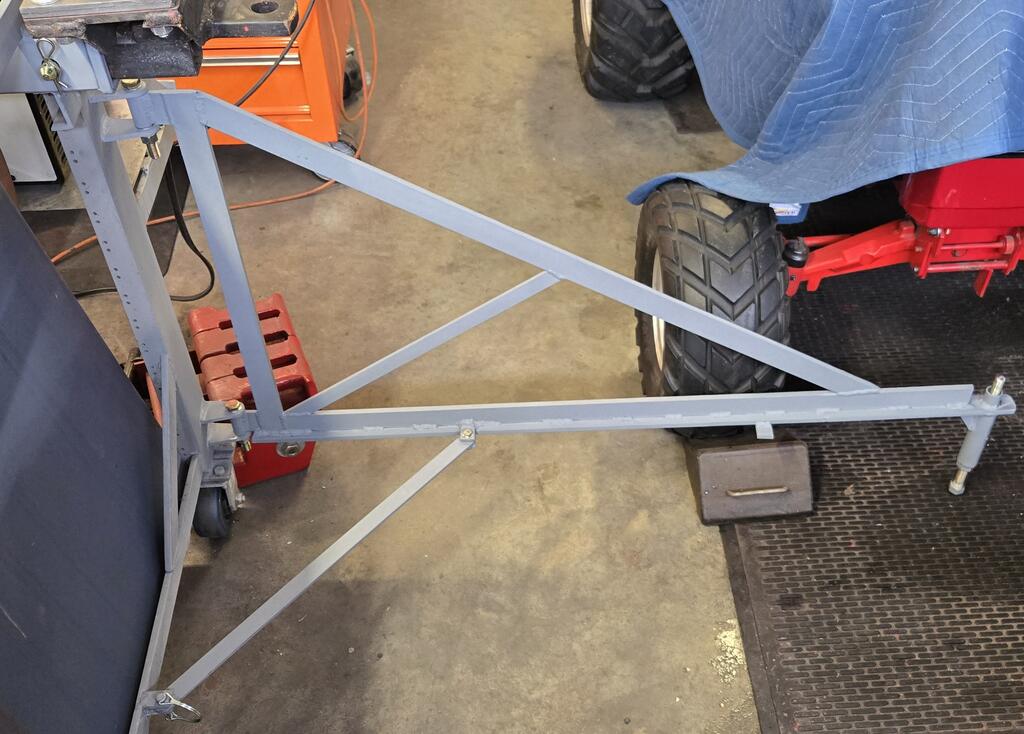

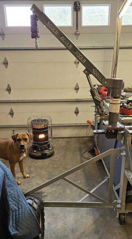

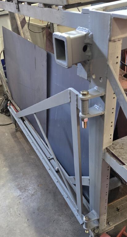

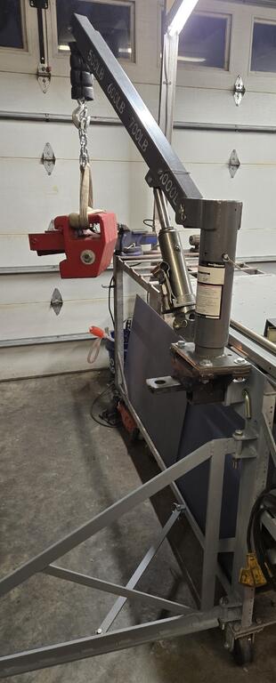

kpinnc 19,023 #1 Posted February 3 (edited) Firstly, forgive my mess because I'm stuck indoors and I'll clean up when I can open the garage again. I welded a hitch reciever to my welding table for using my mini crane and for using my tire changer. But I got to thinking that it wouldn't take much weight on the crane to tip the table. So I made a folding outrigger to support it. I won't lift anything heavier than a Kohler or Onan, and I'll stay inside the 90 degree space formed by the outrigger. My back just won't tolerate moving an engine from the tractor to the table. We'll see how it works soon. At least it looks neat... and Rubble approves! Or maybe he just likes the heater... Edited February 3 by kpinnc 6 18 1 Share this post Link to post Share on other sites

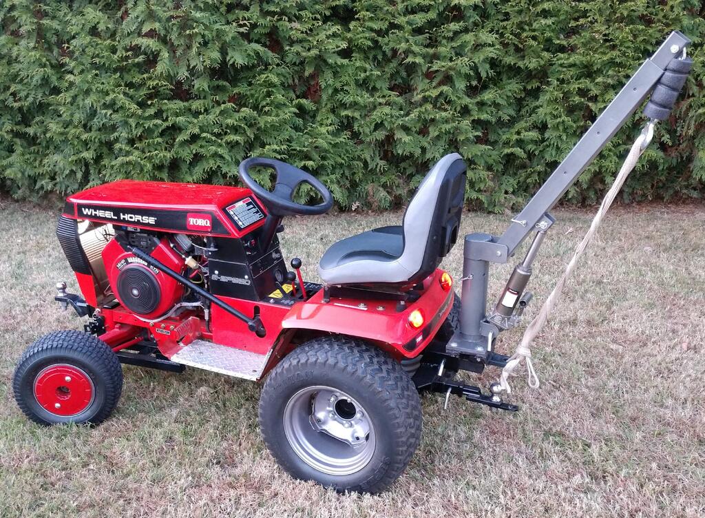

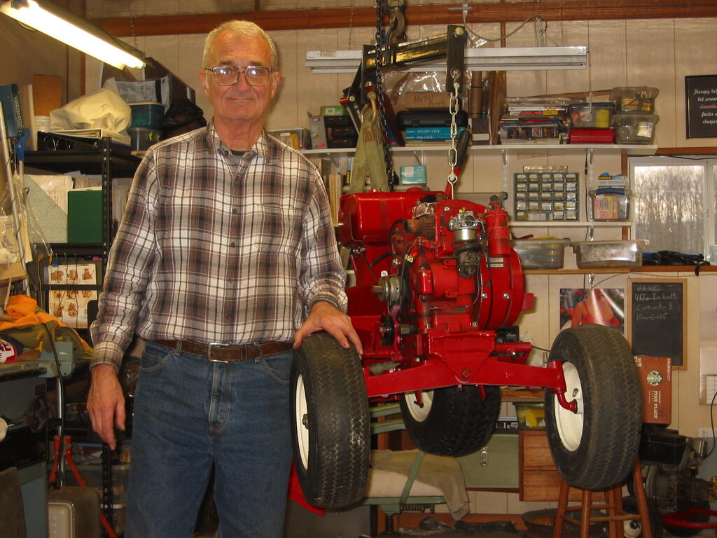

kpinnc 19,023 #5 Posted February 3 (edited) 39 minutes ago, ri702bill said: Next best thing in lieu of an overhead hoist on a trolley..... Thank you! I'd love to have an overhead setup but my garage doesn't have support big enough in my opinion, and I don't have the avaliable steel currently to build one. There is a decent one at Harbor Freight but it's outside my price range at the moment. I got the idea of making the crane setup from Don @Lee1977. I can move it to the tractor whenever needed outside. Edited February 3 by kpinnc 8 1 Share this post Link to post Share on other sites

8ntruck 9,356 #14 Posted February 4 7 hours ago, SylvanLakeWH said: They are very handy!!! Lifting, OK. I would not pulled on anything too hard - that is a really long lever arm to pull the tractor over backwards with. 1 Share this post Link to post Share on other sites
kpinnc 19,023 #15 Posted February 4 46 minutes ago, 8ntruck said: Lifting, OK. I would not pulled on anything too hard - that is a really long lever arm to pull the tractor over backwards with. With mine, and I think @SylvanLakeWH as well, I place a trailer behind me for the heavy stuff and lift the object onto the trailer before pulling too much weight. You can also lower a heavy object down to only an inch or two off the ground as well before pulling. You might drag it, but it helps keep the leverage lower. I said all that to say this: I agree with you 100%. And also there are ways to move things safely with this setup. I've been thinking of making a large Caster setup to use for that very reason, almost like a wheelie bar. Project for warmer weather! 2 Share this post Link to post Share on other sites

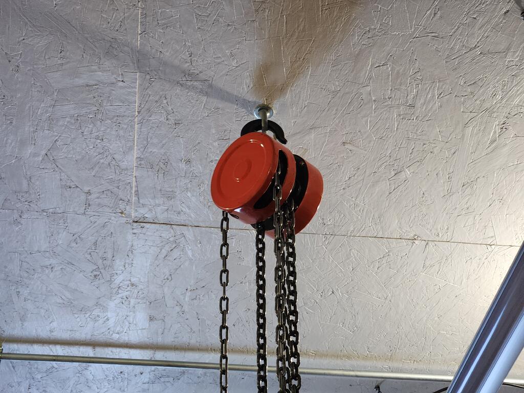

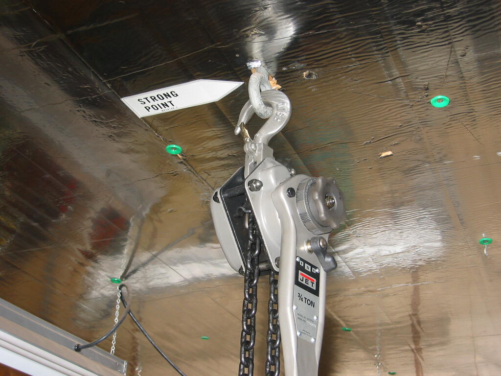

Racinbob 13,228 #20 Posted February 4 With 10' ceilings I had plenty of height to install a chain hoist. The welded eyebolt exceeds the capacity of the hoist and runs up through a 4x4 spanning the trusses. Just for giggles I reinforced the trusses with additional web runners tying in the top and bottom chords. I figured it would be handy but didn't realize just how handy. Just cuz I'm a chicken I wear a hard hat while actually cranking on it. I'm not worried about the mounting but the cheap chain hoist maybe. 2 Share this post Link to post Share on other sites
Treepep 1,151 #21 Posted February 4 @kpinnc, How do you get the welding mask on Rubble? sweet setup sir! Share this post Link to post Share on other sites
kpinnc 19,023 #22 Posted February 4 35 minutes ago, Treepep said: How do you get the welding mask on Rubble? Oh he has a frosted plastic shield over the end of his kennel. He only grumbles if I'm out there very late at night. I guess I'm interrupting his beauty rest.... 1 Share this post Link to post Share on other sites

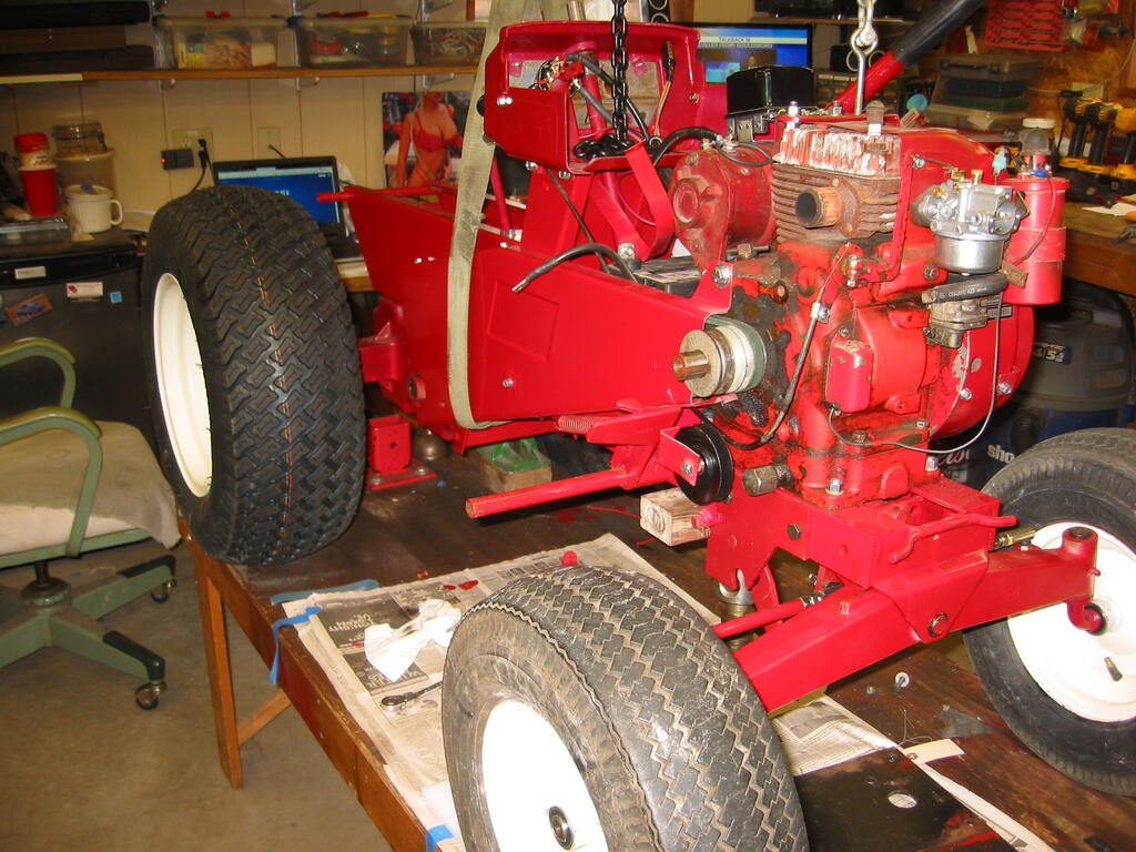

Handy Don 17,599 #23 Posted February 4 You guys are so right about not risking ones back. A couple of years ago I transplanted a P218 from a 518 to a 520-H chassis. Trolley hoist? I wish. Rigged a solid fixed point and used a come-along to get the engine up off the donor and then wheeled the donor away, wheeled the 520 chassis under the engine and lowered it. If I couldn’t have done that I’d have needed a helper. 1 Share this post Link to post Share on other sites

kpinnc 19,023 #25 Posted February 5 Gave the crane a test run today. Only lifted about 120lbs but it's a start. I hung as much of my own weight on it as I could and it was stable. I'll be lifting a K321 over the weekend. Hopefully it'll stay upright! 1 Share this post Link to post Share on other sites
