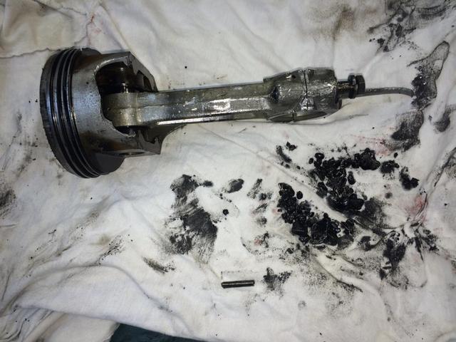

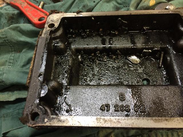

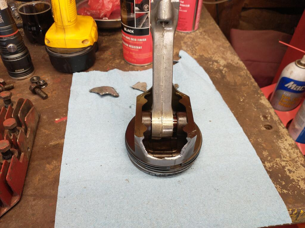

squonk 48,126 #35 Posted January 30 21 hours ago, oliver2-44 said: @Joker72 Here's some pictures of the C161 I picked several years ago. It was parked for many years as the balance gear destroyed the side of the piston. You can see a needle in the oil pan and piston picture trash. If you keep the balance gears, when you replace the bearings you also have to check the short polished shafts they ride on. As I recall, the shafts have a very tight wear allowance. Had the exact same thing! Share this post Link to post Share on other sites
ebinmaine 80,714 #36 Posted January 30 9 minutes ago, Joker72 said: @ebinmaineI'm not arguing against but I do want to consider that it runs, what seems to be near perfectly, with the exception of consuming oil. ?? ....... for now. The gears wear. The gear's bearings wear. The shafts wear. Combine those and it doesn't go well. Here's a video of one of my own C160 K341s from several years ago. I get your logic. If it ain't broke.... But REALLY check your own gears when you have the engine apart. They WILL be out of spec. Again ... I will NEVER go into another Kohler big block without removing the balance gears. 1 1 Share this post Link to post Share on other sites
