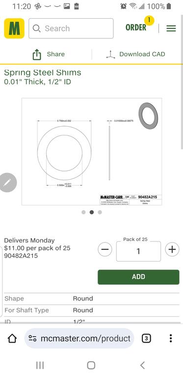

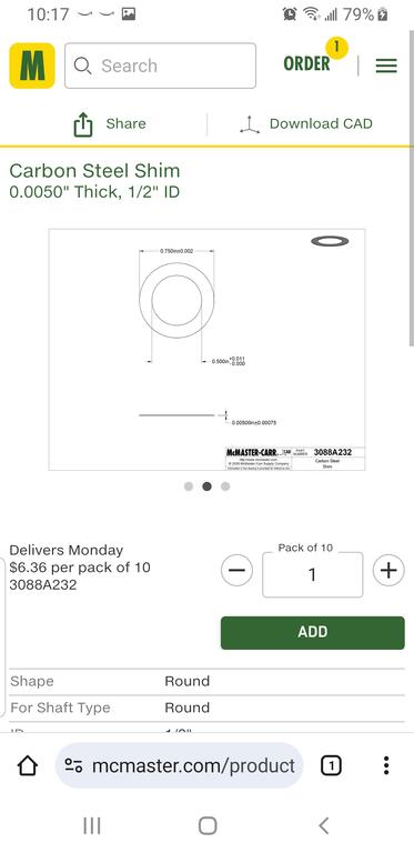

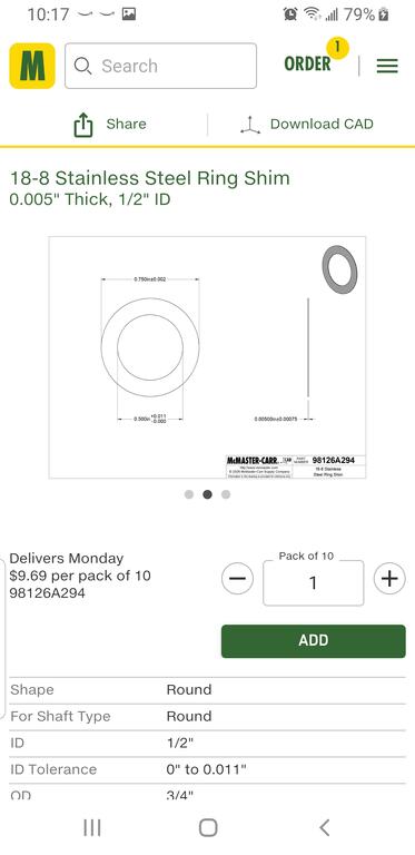

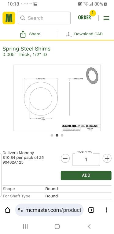

gt14rider 1,278 #1 Posted January 24 Good morning, working on a k181 . My question is what material should I want to buy from mcmaster carr, the stock shim is 15/32 x 3/4 x .005. Closest I can find is 1/2 x 3/4 x .005. Think that would work? If so , 18-8 stainless , carbon steel or spring steel . I can get 10 shims for less than 1 kohler shim. Share this post Link to post Share on other sites
Chaz54 102 #2 Posted January 24 Where are you going to be putting the shim? I’m not sure where you are referring to. Share this post Link to post Share on other sites
lynnmor 9,010 #3 Posted January 24 If you are adding the .005" shim to an existing shim, it might be better to use one shim that equals the stack you need, or two shims that are thicker than the .005". I would use the spring steel. 2 Share this post Link to post Share on other sites

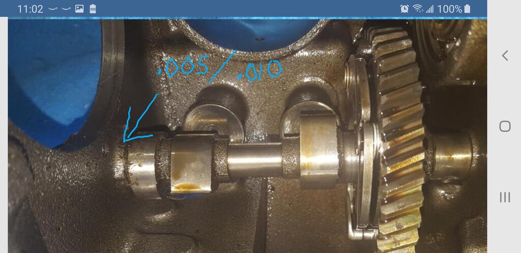

gt14rider 1,278 #4 Posted January 24 Thay go between the cam and block 1 Share this post Link to post Share on other sites
pfrederi 21,046 #5 Posted January 24 the extra 1/32 inch OD should not cause any issues in that location. 3 1 Share this post Link to post Share on other sites
gt14rider 1,278 #6 Posted January 24 (edited) @pfrederi@lynnmor What do you think of this one, maybe I'll get .005 and .010 to have on hand . Can get 25 for $10. Kohler shim 8 bucks a pop + shipping. Edited January 24 by gt14rider Share this post Link to post Share on other sites
Chaz54 102 #7 Posted January 24 The next question is, how much clearance is there should be between these two and how much is there between these two? Share this post Link to post Share on other sites
gt14rider 1,278 #8 Posted January 24 @Chaz54 spec is .005 - .010. There is about. 014 clearance now, with one .005 shim. Share this post Link to post Share on other sites
Chaz54 102 #9 Posted January 24 14 minutes ago, gt14rider said: @Chaz54 spec is .005 - .010. There is about. 014 clearance now, with one .005 shim. 49 minutes ago, lynnmor said: If you are adding the .005" shim to an existing shim, it might be better to use one shim that equals the stack you need, or two shims that are thicker than the .005". I would use the spring steel. 2 Share this post Link to post Share on other sites
ri702bill 12,808 #10 Posted January 24 30 minutes ago, gt14rider said: @Chaz54 spec is .005 - .010. There is about. 014 clearance now, with one .005 shim. I too am in favor of using one thicker steel shim to give you about .007 or so clearance. 1 1 Share this post Link to post Share on other sites
lynnmor 9,010 #11 Posted January 24 5 hours ago, gt14rider said: @pfrederi@lynnmor What do you think of this one, maybe I'll get .005 and .010 to have on hand . Can get 25 for $10. Kohler shim 8 bucks a pop + shipping. It sounds like you have .019" play without shims, a pair of .006" would give you .007" clearance or use just one .012" or .0125" would give the same and you wouldn't have the thin metal. 1 1 Share this post Link to post Share on other sites
gt14rider 1,278 #12 Posted January 25 @lynnmor just went and remeasure the camshaft end play with out the shim, measured .016 so a .010 shim should do the trick. Well I have to get a shim now, I buggerd up the .005 shim. Ok just ordered .005 and .010 shims, will be here Tuesday. Thay will have to come by dog sled. Were supposed to get between 12 to 18 inches even up to 2 foot, depending on who talk to. 1 Share this post Link to post Share on other sites

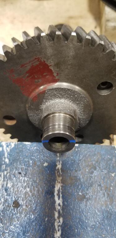

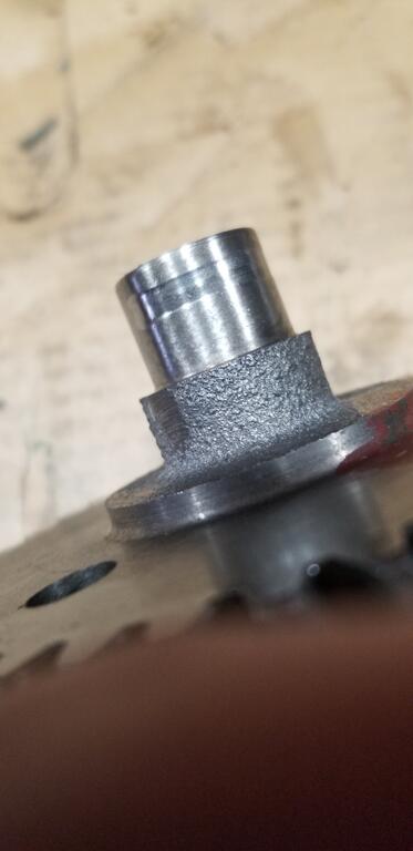

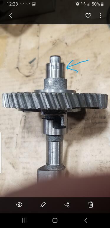

gt14rider 1,278 #13 Posted January 27 Still waiting for the shims, but look what I found. The cam lobe for the points has a dig in it. What do you think about sanding, or filling the dig out. Share this post Link to post Share on other sites
lynnmor 9,010 #14 Posted January 28 7 hours ago, gt14rider said: Still waiting for the shims, but look what I found. The cam lobe for the points has a dig in it. What do you think about sanding, or filling the dig out. If that is where the pin for the points ride you will never get the timing right. Is that the high point of the lobe? Share this post Link to post Share on other sites

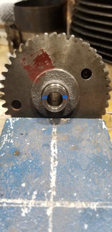

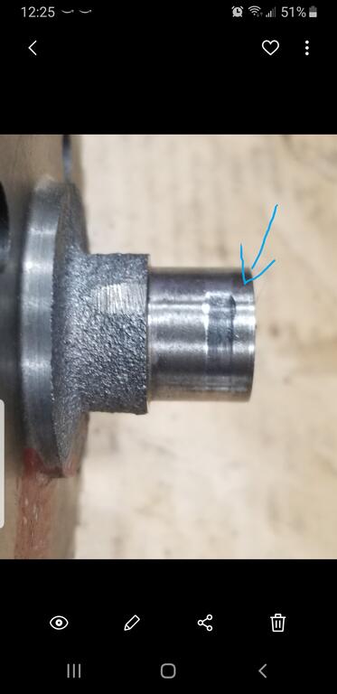

gt14rider 1,278 #15 Posted January 28 @lynnmor it' is over the high point of the lobe. Took some pic's, the blue dots is the length of the dig. Looks like I'm looking for another cam. Share this post Link to post Share on other sites
