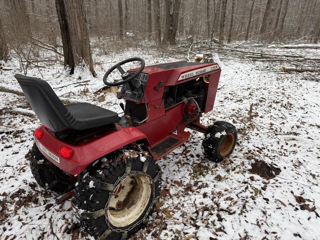

Alrashid2 476 #1 Posted January 20 Hey guys. I'm tired of getting my Wheel Horse stuck in the snow. I have zero issue plowing snow on my asphalt driveway with no chains, but my Horse lives about 50 yards downhill from the house. When we get snow, I oftentimes can't make it up the hill to the house and driveway. Beneath the snow is just forest floor, so leaves and dirt. I think I'm ready to try out rubber chains. But do they help at all in snow above dirt? How do they do in dirt/mud in the summertime? Also, would love any advice on where to get an affordable pair for tires that are 22x7.50-12. Thanks! 1 Share this post Link to post Share on other sites

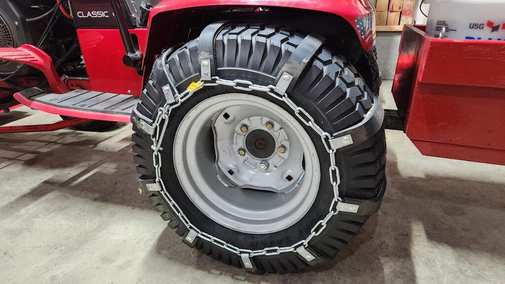

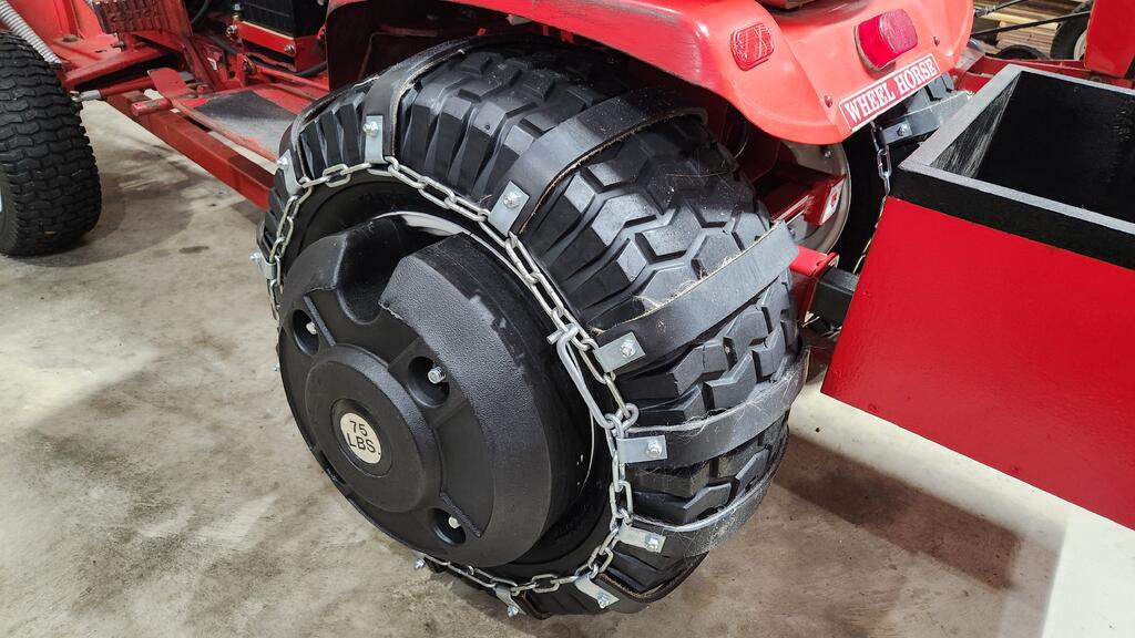

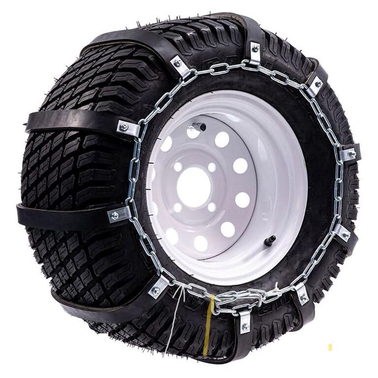

pfrederi 21,151 #7 Posted January 20 You can tighten them up by moving th connecting link from the yellow line position to the white line link. Also you will probably want chain tensioners as i have on mine. They can be rubber or springs... 2 3 Share this post Link to post Share on other sites

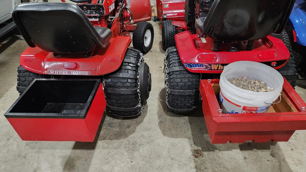

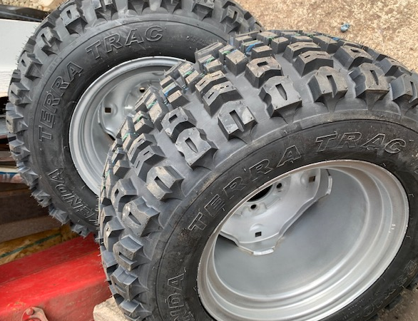

JoeM 10,268 #9 Posted January 20 Started running these terra trac also antego's and have had little trouble with out using chains on some pretty steep slopes. One tip tho is adding weight to the rear helps with anything your using. 1 Share this post Link to post Share on other sites

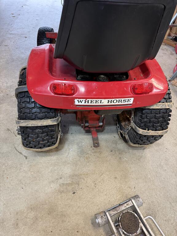

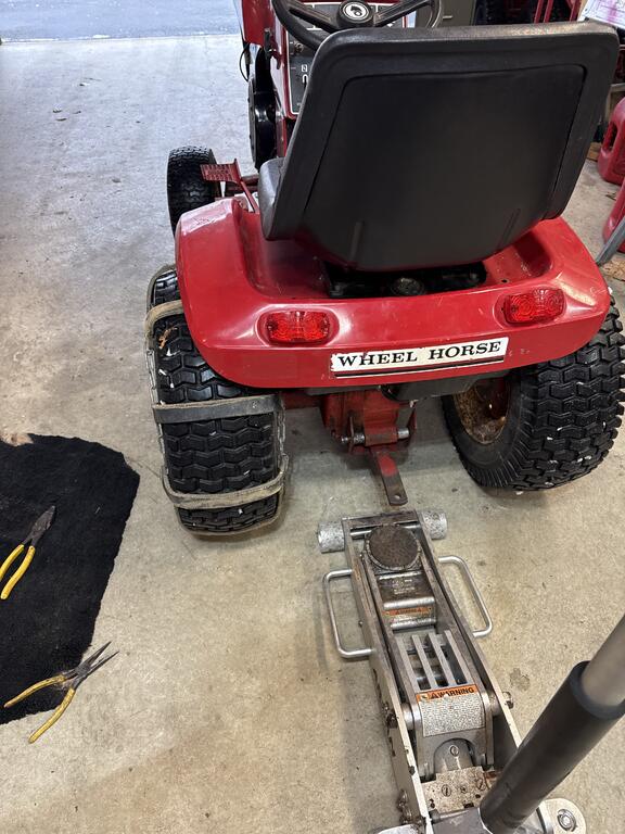

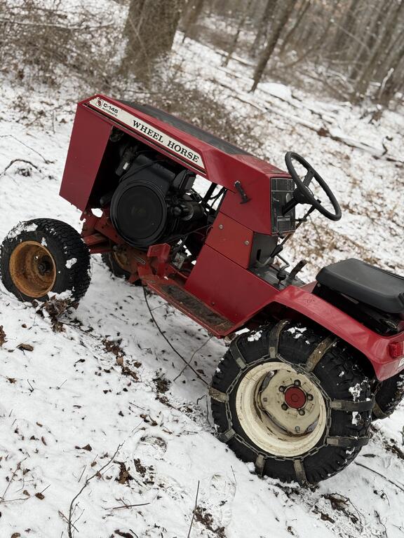

Sparky-(Admin) 26,364 #14 Posted January 21 Picked up a used set of rubber tire chains at last years WH Show for next to nothing. Unfortunately I can’t give you a proper review as I’ve only installed em and put about 25 minutes of driving time on them during a cruise thru the woods out back, no plowing or slugging though mud. Traction on that first run was great. Maybe not 2 link steel chain great but I went places out back that I would never have made it to with just tires. This tractor also has no wheel-weights, just these rubber chains. These are mounted on 23x8.5’s and there were 3-4 links left over (inside and outside) once they were on tight that I had to tidy up. I think my set would be better on 23x9.5 or maybe 23x10.5 tires. 1 2 Share this post Link to post Share on other sites

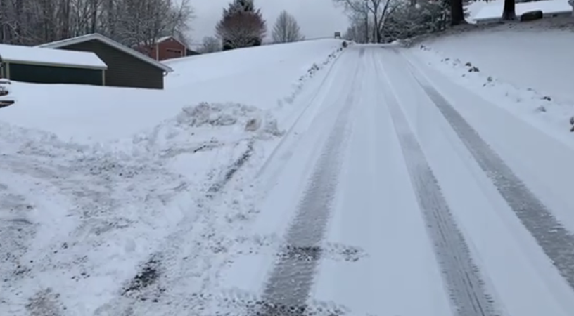

JoeM 10,268 #15 Posted January 21 test track leads up the shop in the back I think I have tried it all. at times went up through the grass and down the drive. chains are good but can make you slide if you catch it just right. those rubber chains should work well in mud and snow like you want. 1 Share this post Link to post Share on other sites

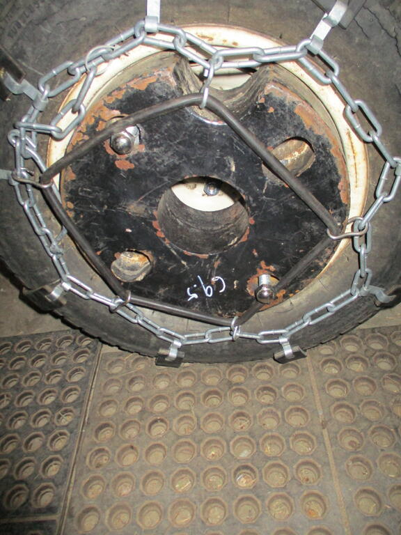

peter lena 10,065 #19 Posted January 21 @Alrashid2 https://www.google.com/search?q=tractor+supply+welded+rings&rlz=1C1CHBF_enUS866US866&oq=tractor+supply+welded+rings+&gs_lcrp=EgZjaHJvbWUyBggAEEUYOTIGCAEQRRhAMggIAhAAGBYYHjIKCAMQABiABBiiBDIHCAQQABjvBTIKCAUQABiABBiiBNIBCTE3MzI3ajBqNKgCAbACAf get a couple of these and a selection of medium hook end extension springs , like a thin straight flat screwdriver , for slide / fit placement , they also sell 12 to 15 " springs , that you can easily cut and make your own up . have found heavy tie wraps. really nail down those loose end links , lift jack on rear end , lets you verify any issues , try, tweek , try , I,M impressed with mine , and no driveway scratching ! easy improvement . pete Share this post Link to post Share on other sites
