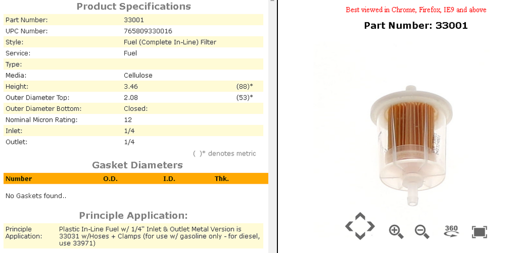

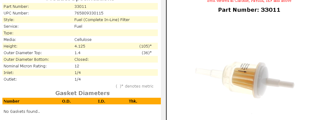

JoeM 10,120 #5 Posted January 18 I really don't change fuel filters to often, I try to use good non e fuel and keep my gas clean in the cans etc. Larger Filter WIX 33001 Smaller Filter WIX 33011 1 1 Share this post Link to post Share on other sites

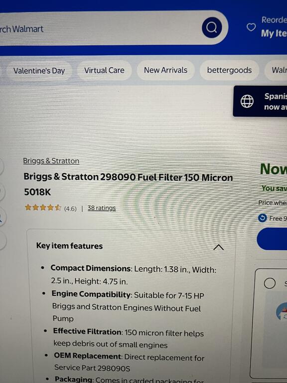

Retired Wrencher 6,901 #7 Posted January 18 (edited) Jim as rule I have been buying the Briggs & Stratton 150 Micron mini filters. There small and easy to fit any where. I buy them in bulk save time and $$$. Not much gets through a 150 Micron filter. Edited January 18 by Retired Wrencher 1 1 Share this post Link to post Share on other sites

ebinmaine 80,067 #9 Posted January 18 1 hour ago, Bill D said: I use a Briggs filter, P/N 691035. It only has 1/4" hose connections and gives a clean look when installed. I buy them in bulk. I've been using Stens for years and been ok. When those are gone we're switching to Briggs filters. The 691035 are $6.79 each shipped, at billsplaceshop.com 17 minutes ago, Retired Wrencher said: Briggs & Stratton 150 Micron mini filters These offer great protection but are not see through. Also clog more often so remember to change them more often to avoid issues. $7.79 each shipped, at billsplaceshop.com 1 Share this post Link to post Share on other sites

Retired Wrencher 6,901 #15 Posted January 20 On 1/18/2026 at 6:58 AM, ebinmaine said: I've been using Stens for years and been ok. When those are gone we're switching to Briggs filters. The 691035 are $6.79 each shipped, at billsplaceshop.com These offer great protection but are not see through. Also clog more often so remember to change them more often to avoid issues. $7.79 each shipped, at billsplaceshop.com Eric, when I like about them, they don’t take up much room also you can hide them if you want. I get them off of eBay and bulk 5 to 10 pack. I think it is. Enjoy your day buddy. Share this post Link to post Share on other sites
