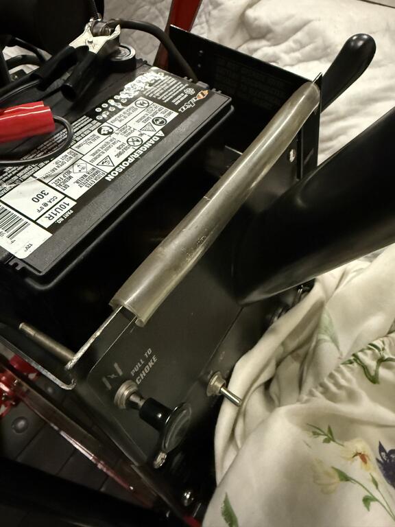

Bar Nuthin 2,308 #2 Posted January 3 I just left my neighbor's place, and he showed me how he added some cheap wire loom to the edge of his dash tower where the hood rests. Says it cured his rattling hood woes. 2 2 Share this post Link to post Share on other sites
Wishin4a416 2,561 #3 Posted January 3 I use old seat edging I save from worn out seats. Some people use split gas line. 4 2 Share this post Link to post Share on other sites
pfrederi 20,271 #4 Posted January 3 More expensive more like original and holds on pretty well. 8 1 Share this post Link to post Share on other sites

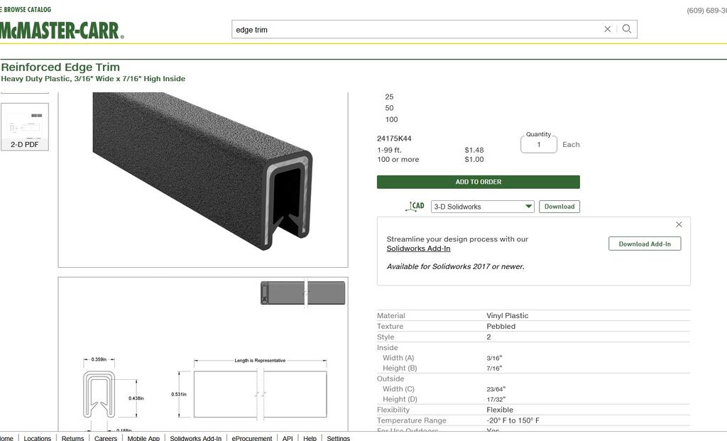

peter lena 9,850 #8 Posted January 3 @markseven look up pick up truck vinyl door trim , also go after any / all noise spots , what model ? pete Share this post Link to post Share on other sites
SylvanLakeWH 31,102 #9 Posted January 4 19 minutes ago, peter lena said: @markseven look up pick up truck vinyl door trim , also go after any / all noise spots , what model ? pete Any vinyl door trim. Works like a charm. Of course, thin strip of black gorilla tape or duct tape would also work... even cheaper... Share this post Link to post Share on other sites

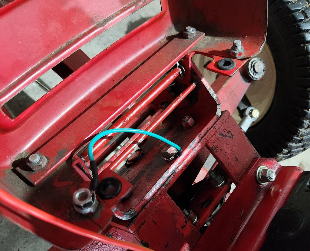

kpinnc 17,909 #10 Posted January 4 (edited) 6 hours ago, C-85 said: Years ago someone on this site recommended to use the felt side of Velcro and that works well! Used this on my tractors with a top mounted hood latch. Works very well, and is surprisingly durable. One other point- The front hood pivot can be a huge noise generator. Often times the hood pivot holes wallow out and create a great deal of rattling noise. Newer classic machines used plastic bushings that were rarely replaced over the years. Small bronze bushings work well. I also tend to remove pins and such in favor of bolts and nylock nuts in addition to some form of pivot bushing. Edited January 4 by kpinnc 1 Share this post Link to post Share on other sites
Racinbob 12,896 #11 Posted January 4 Look carefully and you'll see the flanged bushings in the pivot pin. That helped a bunch. To finish the cure for this area I added a couple of rubber grommets to prevent metal to metal contact. Note the wear that's caused on this 50 year old machine. You can get the little bumpers that push in but I went with a part that's available pretty much anywhere. 2 1 Share this post Link to post Share on other sites

Dan 312-8 504 #14 Posted January 4 On my ‘96 312-8 (pictured), and on other tractors I use a piece of clear tubing for the hood to steering tower, and as @kpinnc said, look at the nylon bushings at the hood pivot point. Those are fun to replace when working alone. 2 Share this post Link to post Share on other sites
markseven 93 #15 Posted January 4 Those little brass bushings are completely gone on mine. 3/8 × 1/2 od. ? Flanged bushing times two. Share this post Link to post Share on other sites
Dan 312-8 504 #16 Posted January 4 1 hour ago, markseven said: Those little brass bushings are completely gone on mine. 3/8 × 1/2 od. ? Flanged bushing times two. They are nylon, see attached. This is what is called for on my ‘96 312-8. Would agree, brass or bronze material would be the ticket. I definitely miss working in a machine shop. 1 Share this post Link to post Share on other sites
Racinbob 12,896 #17 Posted January 4 4 hours ago, markseven said: Those little brass bushings are completely gone on mine. 3/8 × 1/2 od. ? Flanged bushing times two. Yes, 1/2" od x 3/8" id flanged. Very easy to drill out to the 1/2" and a simple install. 2 hours ago, Dan 312-8 said: They are nylon, see attached. Th is what is called for on my ‘96 312-8. Would agree, brass or bronze material would be the ticket. I definitely miss working in a machine shop. WOW! Don't waste your time or money on these. You can get a handful of the brass for that. 1 Share this post Link to post Share on other sites
Lee1977 7,632 #18 Posted January 6 (edited) On 1/4/2026 at 8:22 AM, Dan 312-8 said: On my ‘96 312-8 (pictured), and on other tractors I use a piece of clear tubing for the hood to steering tower, and as @kpinnc said, look at the nylon bushings at the hood pivot point. Those are fun to replace when working alone. I used 1/4" rubber gas line on my 300's. Also helps the use 3/8" bolts and flat washers with locking nuts at the hinge. Might need to replace or repair worn hinges, Edited January 6 by Lee1977 2 Share this post Link to post Share on other sites
markseven 93 #19 Posted January 10 Them little brass bushings did it it. Just have to drill out to 1/2 inch . 1 Share this post Link to post Share on other sites
