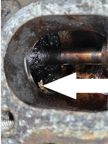

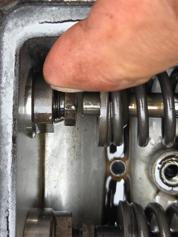

Red Stallion 231 #12 Posted December 30, 2025 Okay, so I dived in and pulled it out to adjust the valve lashings. In my heart I know that's the problem, so just commit to it. Front cylinder wasnt too bad, but the back cylinder clearance was probably 2-3mm! Adjusted them all back to .013 and .005 thou. But while I had it open I peered inside and it looks like there is a big crack around one of the valve seats? I'm no expert, but my vahue understanding is that engines and cracks generally dont go together to improve performance? Its the same valve that had the massive clearance, which makes me think its pretty toast? Is the valve seat section repairable? Or it looks like its part of the engine block casting so its new engine material? 3 Share this post Link to post Share on other sites
RED-Z06 2,720 #13 Posted January 4 I cant see the crack, but given the P220 engines nasty habit of losing intake seats on the right/rear cylinder...id pop that head off and have a look. The block typically needs to be machined to accept an oversize seat, then the seat has to be faced/cut to the right height. Share this post Link to post Share on other sites

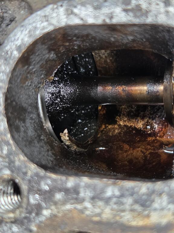

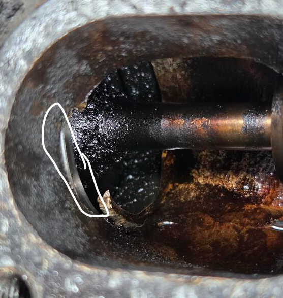

Red Stallion 231 #14 Posted January 4 If I'm not mistaken, that is the seat of the valve. And you can see the crack in the seat or the block just to the right. I still haven't done a compression test... maybe the engineering gods will shine down upon me and I'm misidentifying everything? It's not a small job to fix that, so I'm starting to have a poke around to see who can do the valve seats. Share this post Link to post Share on other sites
wallfish 20,510 #15 Posted January 4 And this looks like a piece peeling off 1 Share this post Link to post Share on other sites
Red Stallion 231 #16 Posted January 5 I'm not sure exactly what it is, but I'm not hopeful that it's going to be a positive benefit. Share this post Link to post Share on other sites
lynnmor 9,010 #17 Posted January 5 58 minutes ago, Red Stallion said: If I'm not mistaken, that is the seat of the valve. And you can see the crack in the seat or the block just to the right. I still haven't done a compression test... maybe the engineering gods will shine down upon me and I'm misidentifying everything? It's not a small job to fix that, so I'm starting to have a poke around to see who can do the valve seats. The valve needs to come out so we, or a machine shop, can see the extent of work needed. Share this post Link to post Share on other sites
Red Stallion 231 #18 Posted January 5 6 minutes ago, lynnmor said: The valve needs to come out so we, or a machine shop, can see the extent of work needed. It's on my list of next jobs... it was too disheartening to make all that progress, and then find this major issue. As you are aware, it's not a 10min exercise to get that head off, and my new head gaskets have not arrived yet. Share this post Link to post Share on other sites
RED-Z06 2,720 #19 Posted January 5 If you have a tester, do a compression test, usually you like to see 115-125 on P engines, when a seat steps out, that number will typically drop to low double digits Share this post Link to post Share on other sites
Red Stallion 231 #20 Posted January 5 7 minutes ago, RED-Z06 said: If you have a tester, do a compression test, usually you like to see 115-125 on P engines, when a seat steps out, that number will typically drop to low double digits Before I pull the head I will do a compression test. If by some miracle it does have decent compression, it really only buys me a little time before I have to fix the obvious. But at least I can drive it around the paddock once and enjoy. Share this post Link to post Share on other sites
