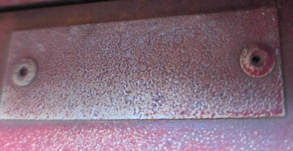

groundhog47 448 #27 Posted December 25, 2025 21 hours ago, ebinmaine said: I think it should be a riveted tag? But I'm not sure. @WHX?? or @Achto Do you know? No rivet holes on engine shroud or below main controls dash. No raised portion showining evidence of paint over. Someone went to a lot of trouble to hide this horse. 2 Share this post Link to post Share on other sites

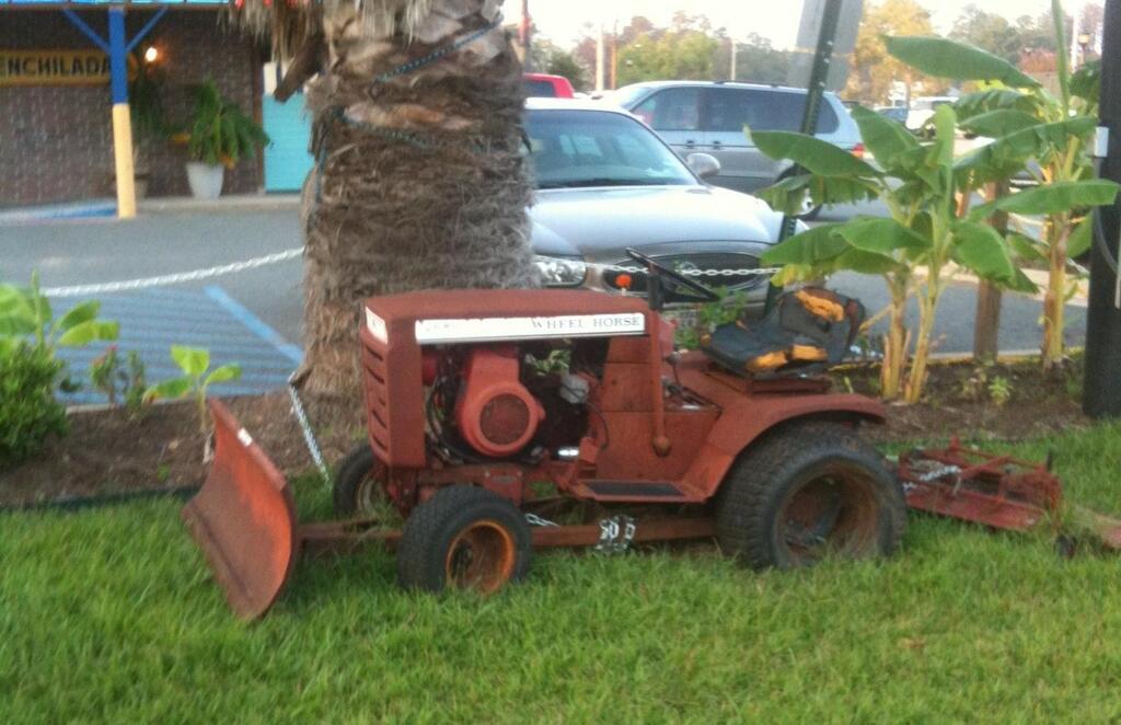

groundhog47 448 #41 Posted December 26, 2025 3 hours ago, sqrlgtr said: I suppose it could have been a cobbled together Frankenstein build. The engine type, under seat tool box and 4 speed transmission along with PTO engagement set me guessing the 65 66 years. I'll be prouud of it even as yard art like this restaurant guy Share this post Link to post Share on other sites

groundhog47 448 #45 Posted January 3 (edited) @WHX?? Steering wheel says long frame '67. Only models with that wheel were 953/1054 and 66 - 67 longs. Might find a very early 68 Raider with one. BTW those steering wheels are hen's Big battery box is pointing to a 10 or 1257. @gwest_ca Tag location @ebinmaine Tag location Ok, you guys, I like my crow cooked thoroughly cooked since I must EAT CROW. I was looking for tag too low on tower. It is riveted on just under bottom edge as told. It was heavily painted but steel wooled and brass brushed to as close to visible as could get. I found no, none, only shadow of engine tag. Starter appears off case as yellow paint. And now for rest of the story, it appears to read 1257 on tag. Thanks you guys and all the rest that helped. I learned a lesson for sure!!! Edited January 3 by groundhog47 Corrections 3 1 Share this post Link to post Share on other sites
