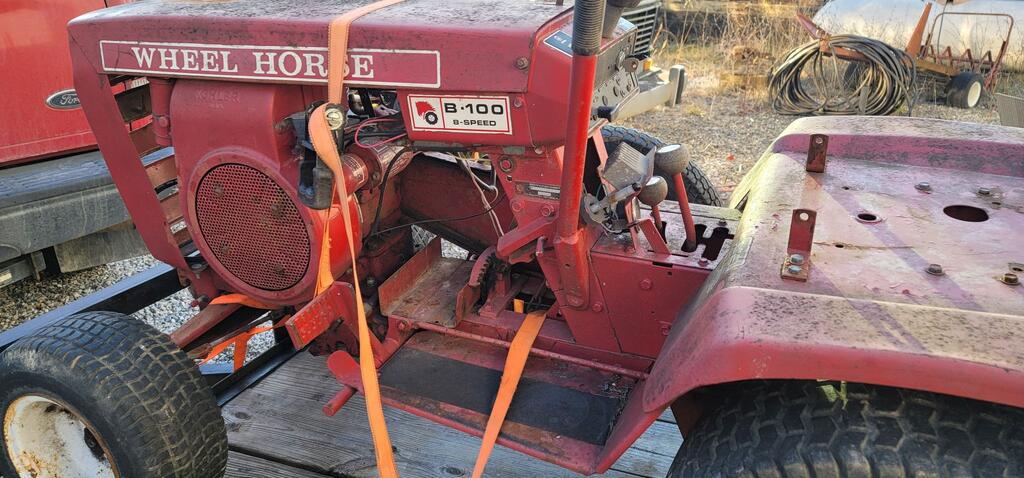

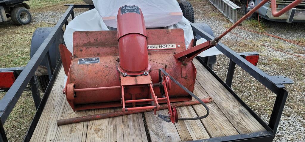

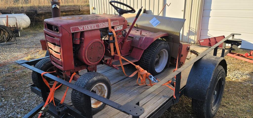

BradKahler 416 #1 Posted December 23, 2025 This tractor showed up on the forum back in 2022, Unadvertised Special? (B100) Being an enabler, Dave reached out to me and asked if I would be interested in taking ownership of it We worked out a deal and last Wednesday I drove up to Indiana to pick it up. Thanks Dave! The deal included a snow blower attachment in pretty decent shape. I'm not sure yet whether it's going to be a parts machine, or whether I will try and rebuild it. I suppose a lot depends on the condition of the hydro drive in my other B100. If the hydro drive is ok and both B100 engines run then I will likely rebuild this one. If the hydro drive is bad then I would probably rebuild around the 8-speed and make one good machine. Time will tell. 11 1 Share this post Link to post Share on other sites

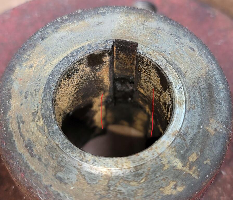

BradKahler 416 #16 Posted June 2 During the past few weeks I finally found some time to dive into the B100. Without a good engine it's not going anywhere so I started with the engine first. I tidied up the wiring a little, installed a replacement tank, fuel lines and installed a battery. It cranked over just fine and had spark. I disconnected the fuel hose at the carburetor and cranked it over until fuel started coming out. Reconnected the hose and cranked it for about 5 seconds and it started! There was no smoke and it sounded great...for about 15 seconds....and then it started sputtering. After looking things over, I found fuel pouring out of the carburetor throat. Dave had installed one of the Chinese clones and my guess is the float was sticking. I decided to borrow the carburetor from the B100 Automatic and once it was installed the engine fired right up and runs like a top!!! My biggest worry about this tractor was the engine, that worry is now over so I've started prepping the tractor for use. So far, I've finished getting decent tires on the front, found a replacement for one of the rear tires, installed a new battery, rebuilt the PTO system, replaced the hood pivot rod with one that I made, replaced the v-belt, the idler pulley, and pulled the wheel hubs to replace the axle seals. When I pulled the rear hubs I found that the key way in each hub was totally destroyed. The key way had worn to more than twice the size from original. I took the hubs to a local machinist where he cut new key ways and I added new threaded holes over the new key ways. The axles themselves appear to be in reasonable condition. They have a little wear but I think will be ok. In the attached picture, the red lines show the width of the key slot with all of the wear. Both hubs are the same. I ran into a problem today trying to install the replacement seals, SKF 11050. In order to install them I bored out a piece of pipe on my lathe to slip fit over the axle shaft. I used that to tap the seal into the housing. The problem I ran into was, apparently the entire rim of the seal didn't quite slip inside the bore so as I hammered it into the bore it tore the rim of the seal. There is no chamfer in the casting, just a nice sharp edge. So bottom line is I destroyed the first seal. I then tried to be much more cautious with the other seal and was more successful but still caught part of the seal lip and it is destroyed as well. $20 down the drain Is there some sort of trick to getting these seals installed without damage? Looking for suggestions so I'm all ears.... 1 Share this post Link to post Share on other sites
Handy Don 17,735 #17 Posted June 2 Since you have machinist skill, consider making a collar to act as a funnel for the seal as you push it into the case to keep the seal’s edges away from the case’s sharp edges? 1 1 Share this post Link to post Share on other sites
MainelyWheelhorse 3,208 #18 Posted June 2 On 12/24/2025 at 8:09 AM, ebinmaine said: You run over to see me. I'll send ya back home with lotsa stuff. I’ve seen it and experienced it…..I built an entire working tractor from parts I got from @ebinmaine and still have some left over… That reminds me, @ebinmaine.I didn’t forget about the 520 hydraulic lift setup that you’ve been storing for me either😁 I’ll be in touch. On 12/23/2025 at 7:07 PM, sqrlgtr said: Oh great someone else within 3/4 hr drive time buying Wheel Horse's. Just what I need another one infringing on my WH turf. I’d say that’s like me and @ebinmaine, but I’m pretty sure he has more of both parts and tractors so it may be the reverse😄 @BradKahler could a little grease lube it up to slip into place? Tap it in with something softer like a rubber hammer etc…It might slip enough greased so nothing catches like what happened before. 1 1 1 Share this post Link to post Share on other sites
ebinmaine 81,281 #19 Posted June 2 35 minutes ago, BradKahler said: The axles themselves appear to be in reasonable condition. They have a little wear but I think will be ok. I'm hoping you used new set screws. You'll definitely want to reset the torque on the set screws after a short amount of driving time. 36 minutes ago, BradKahler said: chamfer 4 minutes ago, Handy Don said: Since you have machinist skill, consider making a collar to act as a funnel for the seal as you push it into the case to keep the seal’s edges away from the case’s sharp edges? I've done quite a few sets of those seals. Some fought me hard. Others flew right in. I have had to hand chamfer the outer edges just a hair. 4 Share this post Link to post Share on other sites
ebinmaine 81,281 #20 Posted June 2 2 minutes ago, MainelyWheelhorse said: I’d say that’s like me and @ebinmaine, but I’m pretty sure he has more of both parts and tractors so it may be the reverse😄 Not counting anything to do with Trina's tractors... I have .... a few... 2 Share this post Link to post Share on other sites
AlexR 3,139 #21 Posted June 2 18 minutes ago, ebinmaine said: I've done quite a few sets of those seals. Some fought me hard. Others flew right in. I have had to hand chamfer the outer edges just a hair. This! I destroyed 2 seals on one axle, until I chamfered it some more with a small file. 1 Share this post Link to post Share on other sites
sqrlgtr 4,225 #22 Posted June 2 1 hour ago, BradKahler said: Is there some sort of trick to getting these seals installed without damage? Looking for suggestions so I'm all ears.... I have used saran wrap and a little oil over the ends of the axle to get seal started, but always deburrrrr everything good first. 5 Share this post Link to post Share on other sites
BradKahler 416 #23 Posted June 3 14 hours ago, Handy Don said: Since you have machinist skill, consider making a collar to act as a funnel for the seal as you push it into the case to keep the seal’s edges away from the case’s sharp edges? That has potential, I'm not sure I have the requisite skills to make something that would need to be that precise. But, your mention of the word collar got me to thinking about a 1-1/8" ID split collar that could be clamped over the seal and then tightened just enough to get it to start into the bore. I'm going to think on this one a while.... Thanks!!! 1 Share this post Link to post Share on other sites
BradKahler 416 #24 Posted June 3 14 hours ago, MainelyWheelhorse said: @BradKahler could a little grease lube it up to slip into place? Tap it in with something softer like a rubber hammer etc…It might slip enough greased so nothing catches like what happened before. I greased the axle shaft which made sliding the seal on and over the shaft. The seal is so small the only way to tap on it is either with a long punch or a sleeve that goes over the shaft, which is what I made. The issue is the edge of the seal that goes into the bore is ever so slightly larger than the bore. Its designed to compress slightly to provide a seal against the bore opening. Both the seal and the bore edges are sharp. 1 Share this post Link to post Share on other sites
BradKahler 416 #25 Posted June 3 14 hours ago, ebinmaine said: I'm hoping you used new set screws. You'll definitely want to reset the torque on the set screws after a short amount of driving time. Hubs aren't installed yet, can't until the seals are in place. Thanks for the torque reset tip. 14 hours ago, ebinmaine said: I've done quite a few sets of those seals. Some fought me hard. Others flew right in. I have had to hand chamfer the outer edges just a hair. Chamfering sounds like a pretty good idea. The original seals had a rubber outer housing, the SKF seals are steel with an edge to them. I wonder if lightly chamfering the edge of the seal might help some? 1 Share this post Link to post Share on other sites
