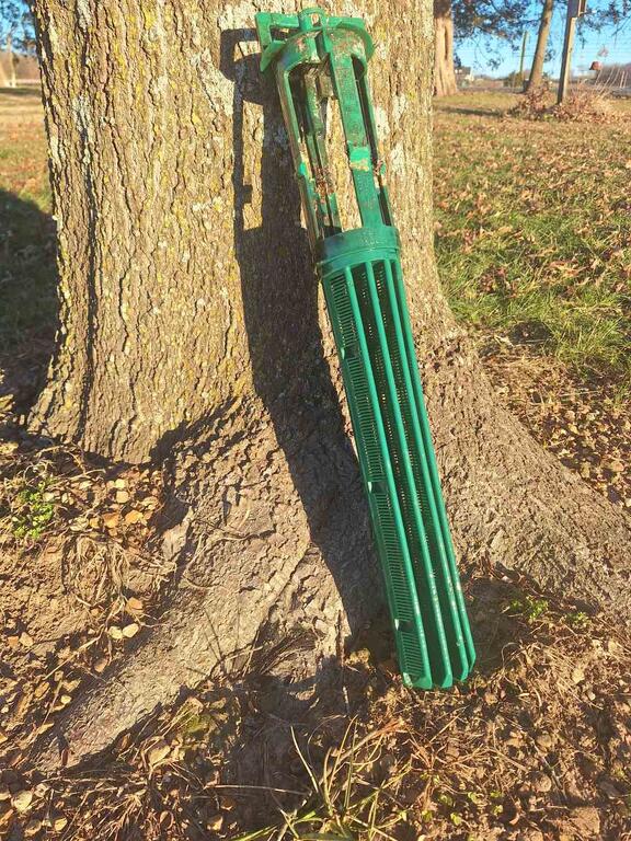

kpinnc 17,519 #33 Posted December 18, 2025 5 hours ago, rmaynard said: Also, my septic tank has no filters or screen. Just seems like something that was thought up to create another wasted cost for a homeowner. Actually I like the filter. It's just a screen in front of the leech entry, so it greatly reduces the amount of solids that may get into the leech line in case the solids tank is overfilled. My water side was relatively clear, but my filter had some sludge on it, which means the filter kept it in the tank. Since cleaning the leech system requires additional work (and expense), I'm glad my filter is there. 1 Share this post Link to post Share on other sites

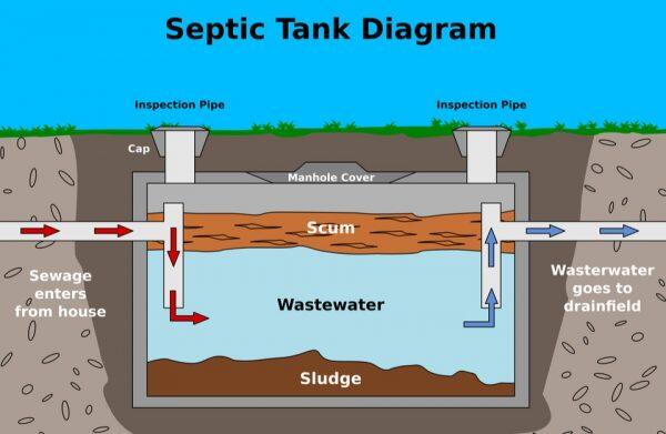

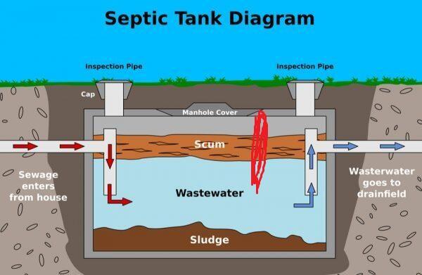

WHX?? 55,748 #35 Posted December 19, 2025 (edited) 6 hours ago, Handy Don said: blue stuff in the camper tank? No just the no stink powder but we never fece in the camper ... just midnight pee. She uses tp ... KP.s three women thing I guess. I didn't have any of that interior piping Bob. Just a concrete slab where the red line is. Slab is laying at the bottom of the tank now and will forever. When pumper dude saw it he had me go down there and pound 3" pvc in the outlet and add that outlet tee with the drop tee. Fairly easy at the time. I didn't add the inspection cleanout but could have there was a concrete plug right above it. There was other concrete plugs presumably for optional inlets that I then hyromented in as that's where roots were coming in. I took it upon myself to add the tee & grade cleanout where the inlet is but pumper told me not to add the down pipe. He then ran his suck hose all the way down the drain field & could hear stones getting sucked up. So what he does is drop a clear tube down to check how much sludge is on the bottom. If over so many inches he has to pump it. For a extra $125 of course. if not he doesn't have to pump it and save me money. Since we are empty nesters there never is over a inch but I have him pump it anyway and look around in there with his mirror. Some pumpers now they have a camera and can even look down the drain fields. 6 hours ago, kpinnc said: I'm glad my filter is there. Is the manhole right over that filter? Is it like a big plastic screen? I don't have any of that but new systems do. Buddies newer system even has some kind of basket filter thingy ??? at he inlet. I think he might even have two separate tanks? Edited December 19, 2025 by WHX?? 1 Share this post Link to post Share on other sites
kpinnc 17,519 #36 Posted December 19, 2025 58 minutes ago, WHX?? said: I don't have any of that but new systems do. Buddies newer system even has some kind of basket filter thingy ??? at he inlet. I think he might even have two separate tanks? The right side of your diagram looks just like my tank, T split and all. The left side has no T and there is a 3/4 petition wall between the two. The filter is just a plastic strainer that fits most of the length of the side going to the leech field. You just turn it 90 degrees and it comes out for cleaning. Share this post Link to post Share on other sites
