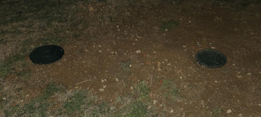

kpinnc 18,965 #1 Posted December 17, 2025 (edited) I've lived at my current address for 7 and a half years. Never had any issues with my system whatsoever. About 3AM my wife flushed a toilet, and water backed up into the bath tub. Then my kid's toilet began leaking above and below the floor around the wax seal. Last night it was about 12 degrees, so of course my wife thought something had frozen, but I had already closed off the crawl space and it was 50 degrees under the house. As it turns out, 3 women in the same house generate alot of toilet paper waste. Who knew? My septic line had plugged solid right at the tank itself, so we had to dig down to the tank and have it pumped. The soil here is solid red clay and rocks, and some doofus had set the tank lid 2 feet down. Supposed to be 6 inches per building code. Added two 18 inch diameter risers for the future, so no more digging ever. Just remove the cap and pump it out. Not to mention they allow for an inspection port as needed. Needless to say, a very crappy and expensive day. Oh well, should be less worrisome in the future. Edited December 17, 2025 by kpinnc 5 Share this post Link to post Share on other sites
WHX?? 58,134 #2 Posted December 17, 2025 (edited) No sympathy here KP... tree roots were my issue till the saw came out. 7 minutes ago, kpinnc said: 3 women in the same house Oh you poor sob... I only got one and took stock in a TP company. In WI we are required to have them inspected and pumped by a pro every three years. Did you use the nifty green plastic extensions with the domed lid? ? Jungle sells them and quite proud of them. One of these days I need to pull the trigger when I get over the price. https://www.amazon.com/gp/product/B00IEC9QU6/ref=ox_sc_saved_image_2?smid=ATVPDKIKX0DER&psc=1 Edited December 17, 2025 by WHX?? 1 Share this post Link to post Share on other sites
kpinnc 18,965 #3 Posted December 17, 2025 (edited) 6 minutes ago, WHX?? said: Oh you poor sob... I only got one and took stock in a TP company. In WI we are required to have them inspected and pumped by a pro every three years. I took a picture of the solids side of the tank, but I think it's a little gross for here. The TP was 4 feet deep in this 1000 gallon tank! It was easy to see the difference between "septic safe" paper and other types. Septic safe breaks down, many other common name brands do not. And no, we have never used any wipes or similar in our system. I'm not a fan of broad stroke regulations- but I can certainly understand the 3 year requirement. It's recommended every 5 years here, but occupancy creates wild fluctuations with that. Edited December 17, 2025 by kpinnc 1 Share this post Link to post Share on other sites
kpinnc 18,965 #4 Posted December 17, 2025 (edited) 18 minutes ago, WHX?? said: Did you use the nifty green plastic extensions with the domed lid? ? Jungle sells them and quite proud of them. One of these days I need to pull the trigger when I get over the price. The septic company sells them. They are very heavy duty as far as I can see. They come already set up in the reinforced concrete covers so they drop right into the square access holes of the tank. The outsides of mine are smooth, with the ribs inside so a little different than the jungle site- but basically the same. Yeah, about $130 each installed. But the way my arms and back feel right now? Worth every penny... No more digging! Edited December 17, 2025 by kpinnc 5 1 Share this post Link to post Share on other sites
Handy Don 17,474 #5 Posted December 17, 2025 10 minutes ago, kpinnc said: so we had to dig down to the tank Be thankful you knew where to dig! When my Dad built our house in the late 50’s he put a detailed map of the septic system in a well-labeled envelope attached to a cupboard door in the garage. During the final walkthrough he pointed it out (I was there). Years after we’d moved away, the new owner called angry and in a panic. Big backup and “where the **** is the septic tank?” The contractors are digging up all over the yard and they can’t find it. Through questioning, the new owner finally admitted he had “cleaned up” the garage and discarded the envelope not realizing its importance. My Dad gave them what he could remember and after a few hours, they did find the tank. 5 1 2 Share this post Link to post Share on other sites
kpinnc 18,965 #6 Posted December 17, 2025 1 minute ago, Handy Don said: Be thankful you knew where to dig! I had a general idea. The grass dies early August there in a perfect square. Still had to dig around a bit since all the grass is brown right now. I was very happy to finally hit concrete! 2 1 Share this post Link to post Share on other sites

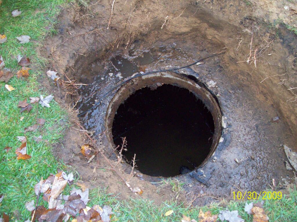

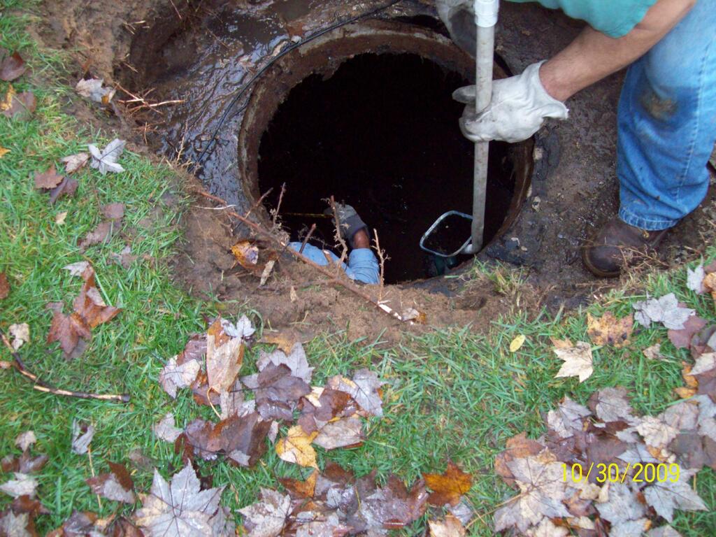

WHX?? 58,134 #13 Posted December 17, 2025 (edited) 10 hours ago, rmaynard said: some kickback on these comments, Not really Bob ... I been crapping in mine for 40 years now and the first 30 years never did anything except removing roots. Then they came out with the mandatory inspection thing. Probably a good thing as the first time I had it pumped he discovered the concrete baffle had dropped down to the bottom. I asked him how much he would charge to go down and fix it. $100 he says. He showed me how to fix it and down I went. I was much more frugal back then ... and younger.... 19 hours ago, kpinnc said: took a picture of the solids side of the tank, but I think it's a little gross for here. Ok no solids ... Edited December 17, 2025 by WHX?? 4 Share this post Link to post Share on other sites
