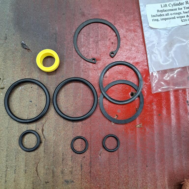

cleat 8,994 #27 Posted December 15, 2025 Here is a thread with some information on changing out the #111 O rings in the control valve. Most of my hydraulic oil leaks have came from these O rings going bad. 1 1 1 Share this post Link to post Share on other sites

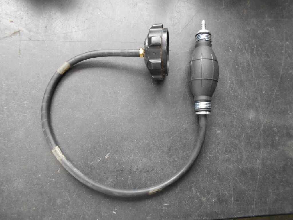

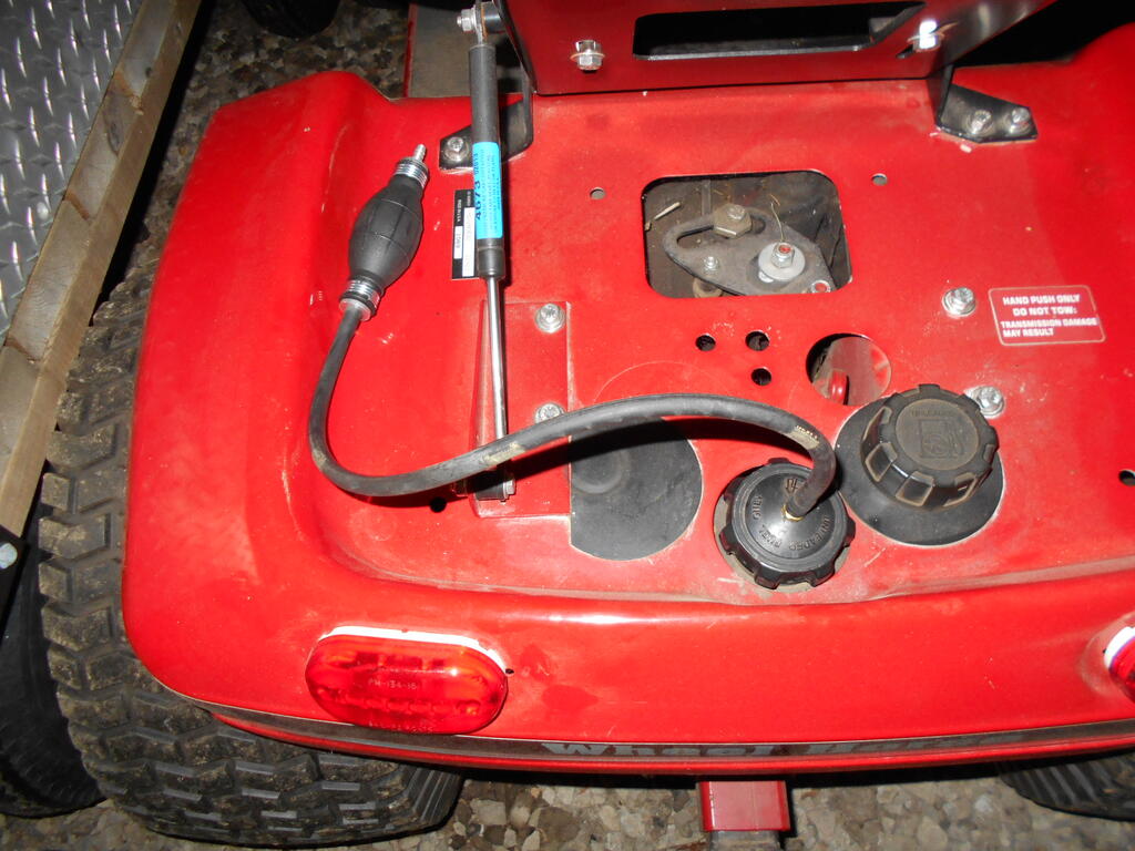

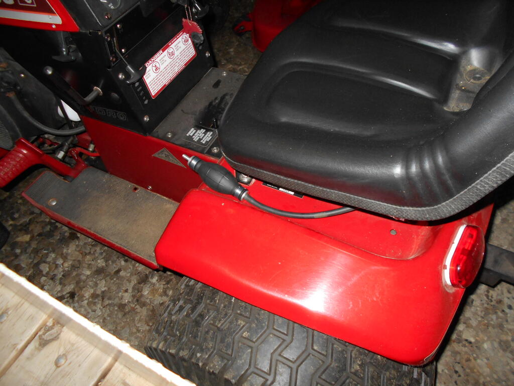

lynnmor 8,875 #31 Posted December 15, 2025 2 minutes ago, Handy Don said: Our camp tractor (518-H++) goes weeks without use. Last spring I decided to try a squeeze bulb like those on outboard motor fuel tanks. After the next two “settin” spells, one squeeze filled the filter and a then did a second squeeze for good measure. Starts were as if it had been shut down an hour ago. So far so good. Some years ago I brought up the use of squeeze bulbs on here and at least one member thought it was a joke. Here again I haven't installed one since the ones worth installing take up a lot of room and are rather expensive. Share this post Link to post Share on other sites
Handy Don 16,914 #32 Posted December 15, 2025 2 minutes ago, lynnmor said: Some years ago I brought up the use of squeeze bulbs on here and at least one member thought it was a joke. Here again I haven't installed one since the ones worth installing take up a lot of room and are rather expensive. Don't recall what I paid, but being kinda frugal, it couldn’t have been much! I have nothing against electric pumps, but since all the tractors I maintain run fine once started, I decided the “squeeze before start" was worth a try. It is a snug fit where the fuel line begins to curve up from the frame along the shroud to the pump on the Onan P218. If this doesn’t work, I’ll probably go with @wallfish’s method with a separate switch to run an electric pump only before/during startup. Share this post Link to post Share on other sites

lynnmor 8,875 #35 Posted December 15, 2025 Found it: Posted November 11, 2016 If you can find a place to fit it, I would think that a primer bulb would cure the excess cranking problem. Yes, the electric pump is a good idea, this is just another option. primer bulb 1 Share this post Link to post Share on other sites

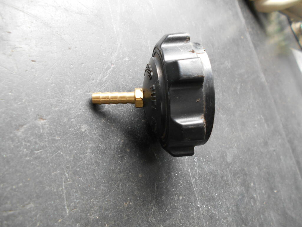

cleat 8,994 #39 Posted December 16, 2025 4 hours ago, lynnmor said: Some years ago I brought up the use of squeeze bulbs on here and at least one member thought it was a joke. Here again I haven't installed one since the ones worth installing take up a lot of room and are rather expensive. I drilled out an old gas cap then screwed in a hose barb fitting. I was then able to use a piece of hose connected to a primer bulb that I use to pressurize the tank a bit with air until I see the fuel filter fill up. Tractor will then usually start right up. Best thing is that you only need one and once the engine is running you can just remove it so it is not in the way. This works with all of my wheel horses iregardless of engine type. I have 10 tractors now so many of them sit for long periods of time. I don't think a check valve matters much because I think that over time the fuel just evaporates out of the carb. Actually I think it evaporates a bit from the tank as well because they always seem very low on fuel after sitting for a long time especially in the heat of the summer. 2 Share this post Link to post Share on other sites
WHX?? 57,273 #40 Posted December 16, 2025 10 minutes ago, cleat said: remove the hood stand side plate Nine bolts and one machine screw to get it off. Have to slide it out to the rear. Gonna be fun putting it back on. 4 minutes ago, cleat said: fuel just evaporates out of the carb. Must ... I always hope somehow it wasn't draining into the motor. Great idea on air pump .. I was thinking a schrader valve and I have this little handy air pump for Harley air shocks. Share this post Link to post Share on other sites
cleat 8,994 #41 Posted December 16, 2025 14 minutes ago, WHX?? said: Nine bolts and one machine screw to get it off. Have to slide it out to the rear. Gonna be fun putting it back on. Must ... I always hope somehow it wasn't draining into the motor. Great idea on air pump .. I was thinking a schrader valve and I have this little handy air pump for Harley air shocks. Anything that puts just a little air in. It doesn't take much. I have taken the cap off then blow into the tank as well but a little pump seems healthier and potentially less embarrassing. Share this post Link to post Share on other sites
Ed Kennell 46,462 #42 Posted December 16, 2025 I use primer bulbs on all mine unless there is evidence the fuel pump is failing. Then I go directly to an e-pump with an on/off switch. Both work well for instant starts. You do need to buy the expensive bulbs. The cheapos get hard and rot at the fittings. 1 1 Share this post Link to post Share on other sites

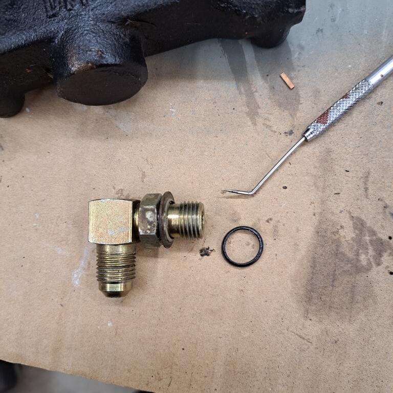

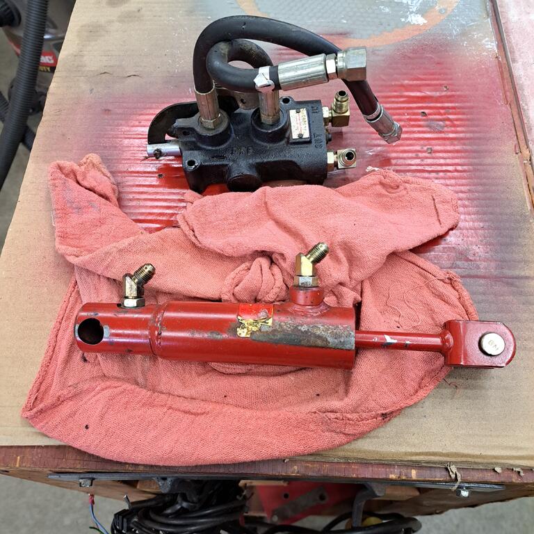

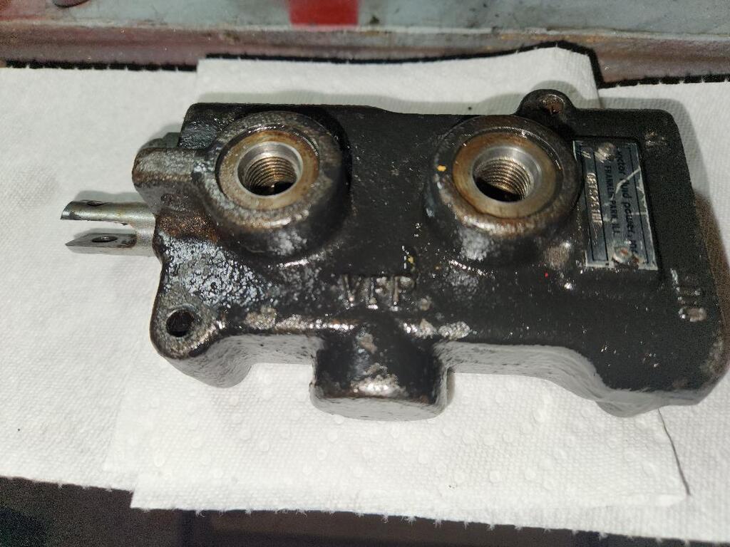

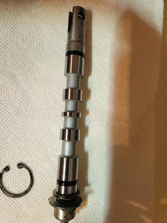

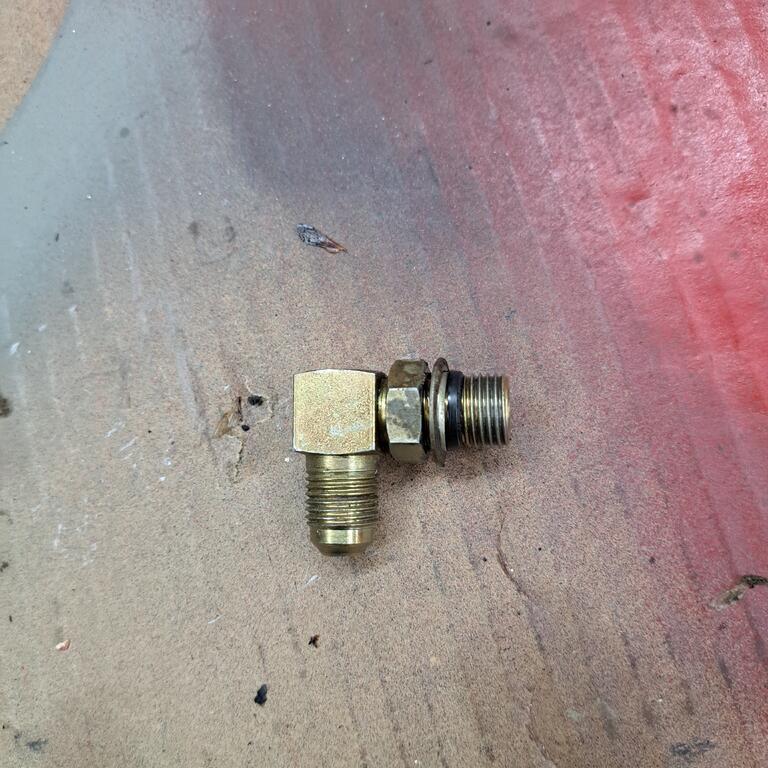

WHX?? 57,273 #44 Posted December 17, 2025 Not much done today but cleaned up and valve ready to go back in.. The donor JIC/ORB 90 fittings needed to come off for the crimped ORB fittings. The tractor is a 91 and the donor I think is a 96 so definitely a production change in hoses. Are those two small o rings in you kit @lynnmor for the ORBs? Don't need to guess they should always be replaced. Share this post Link to post Share on other sites
lynnmor 8,875 #45 Posted December 17, 2025 Yes, you should have one for each fitting on the cylinder. 1 Share this post Link to post Share on other sites

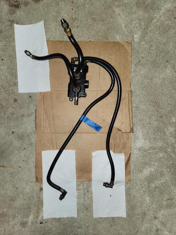

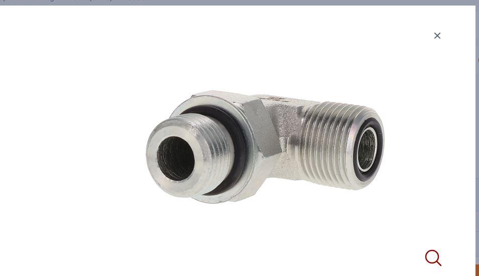

WHX?? 57,273 #46 Posted December 17, 2025 7 hours ago, lynnmor said: Yes, you should have one for each fitting on the cylinder. I plan on using them on the valve since the donor cylinder has JIC fittings that look to be leak free and match up with the hoses on the donor valve. Is this considered a ORFS fitting then? I been doing a lot of reading on the site Lynn posted. I would have preferred to leave these on the donor valve but would have had to change the supply/return hoses to the hydro. I think those hoses went on a Bronco 14 @Achto and I restored. Share this post Link to post Share on other sites
Achto 32,035 #47 Posted December 17, 2025 11 minutes ago, WHX?? said: I think those hoses went on a Bronco 14 @Achto and I restored. May be correct, I've slept since then so I'm not sure anymore. 2 Share this post Link to post Share on other sites

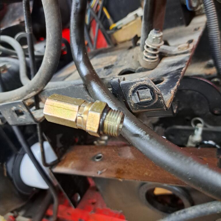

pfrederi 20,823 #48 Posted December 18, 2025 That is an ORB. O ring and thin washer In tho picture ORB on the left ORFS on the right. 1 Share this post Link to post Share on other sites

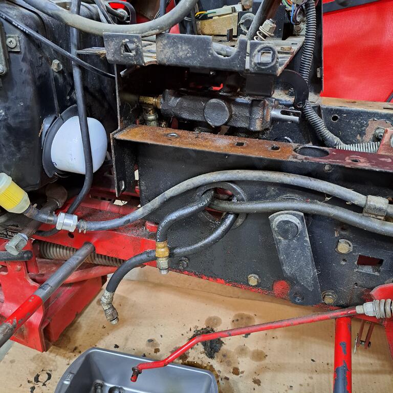

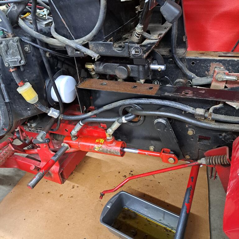

WHX?? 57,273 #49 Posted December 18, 2025 (edited) Done & ready to button back up. No leaks. Not a terrible procedure but not fun. As usual removing 30 pounds of stuff to get at 1 pound. Would have been much easier without a cab on. Cleat is still my hero for getting the spool out with the valve in place. Even moving the front plate forward not much room in there. Note the clearance to the oil filter. Edited December 18, 2025 by WHX?? 2 Share this post Link to post Share on other sites
sqrlgtr 3,171 #50 Posted December 18, 2025 1 hour ago, WHX?? said: Done & ready to button back up. No leaks. Not a terrible procedure but not fun. As usual removing 30 pounds of stuff to get at 1 pound. Would have been much easier without a cab on. Cleat is still my hero for getting the spool out with the valve in place. Even moving the front plate forward not much room in there. Note the clearance to the oil filter. hope dat aint you Wifes meatloaf pan in the floor full of oil 2 Share this post Link to post Share on other sites
