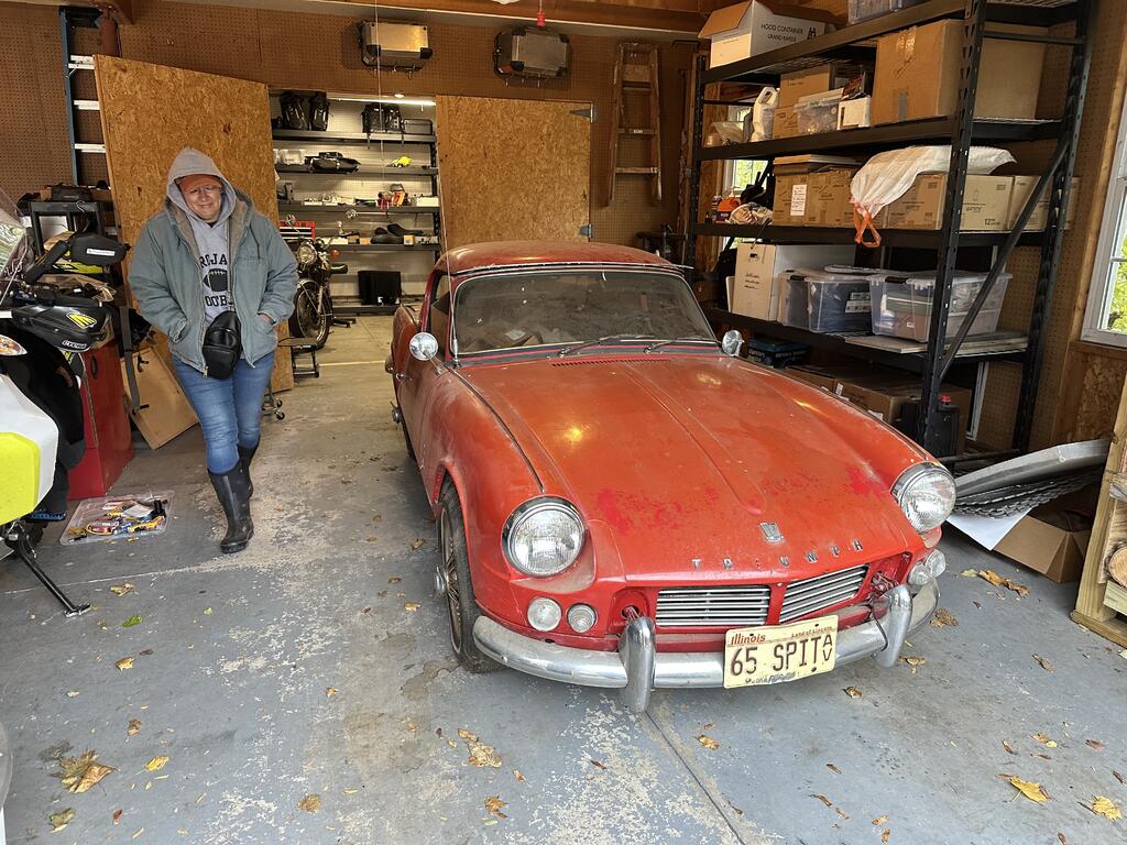

Pullstart 71,235 #1 Posted November 13, 2025 We didn’t know what we were getting, we just knew it was free to us. And small. My memory told me it was red, but maybe dark green. It had been 8-10 years since I had seen it. 4 1 3 Share this post Link to post Share on other sites
Pullstart 71,235 #2 Posted November 13, 2025 The previous owner had it for 12-15 years, untouched. It was last registered in 2004 in Illinois. I got it to run yesterday on spray! It sounds great and there is bright hope! 4 1 1 Share this post Link to post Share on other sites

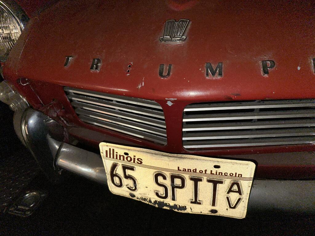

Achto 32,692 #3 Posted November 13, 2025 57 minutes ago, Pullstart said: So this is a TRUMP model H ?? 2 Share this post Link to post Share on other sites
squonk 48,119 #4 Posted November 13, 2025 25 minutes ago, Achto said: So this is a TRUMP model H ?? Guaranteed to leave you stranded by the side of the road with an empty wallet! 2 4 Share this post Link to post Share on other sites

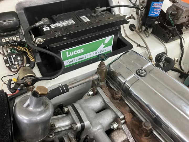

ri702bill 13,055 #5 Posted November 13, 2025 Lucas electrics??? Haha - don't get it wet!!! 3 Share this post Link to post Share on other sites

squonk 48,119 #9 Posted November 13, 2025 40 minutes ago, ri702bill said: Lucas electrics??? Haha - don't get it wet!!! 4 Share this post Link to post Share on other sites

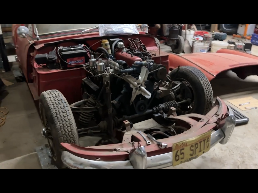

Pullstart 71,235 #18 Posted September 4 I was left alone unsupervised last night… I started brainstorming. The engine runs, but the cooling system, is very crunchy. Literally, the coolant has dried into a crunchy substance. I have a perfectly good, fresh built, .030” over 4.3L V6 Chevy engine, an NV3500 5 speed, and lots more GM based parts than Triumph. The engine and transmission out of the way would help to be able restore the floor. At least that’s my story. The radiator has plenty of room to move forward and down, to clear the hood. I believe the steering rack will be the limiting factor to lower the engine down, but people have made V8s work, I should be able to deal with a V6. I know how to find out… 1 1 1 Share this post Link to post Share on other sites
Handy Don 17,474 #19 Posted September 4 Will any weight difference between the two fully-installed engines affect front suspension dynamics? Is the rest of the drive train stout enough? Share this post Link to post Share on other sites
Pullstart 71,235 #20 Posted September 4 56 minutes ago, Handy Don said: Will any weight difference between the two fully-installed engines affect front suspension dynamics? Is the rest of the drive train stout enough? 1 hour ago, Pullstart said: I know how to find out… Share this post Link to post Share on other sites
Pullstart 71,235 #21 Posted September 4 (edited) Without being 100% smart alek about this, they did install a v6 in later models. Weight wise, this front end is a bit dainty, but has a coil over setup. Maybe a bit beefier spring? I don’t plan to break records, road or track, just have fun and increase drivability. Edited September 5 by Pullstart 1 2 Share this post Link to post Share on other sites
lynnmor 9,040 #22 Posted September 4 My BIL installed a 305 Chevy small block in one, quite a project but he built many stock cars over many years. The goal was to keep it looking stock and he managed that with only minor visual clues. As I remember the entire drive train was changed out and the exhaust manifolds came from a Tahoe. Don't remember many details and he and his wife are long gone. 1 1 Share this post Link to post Share on other sites
SylvanLakeWH 32,501 #23 Posted September 4 No worries @Handy Don... A call has been pre-emptively placed to 911... 1 3 Share this post Link to post Share on other sites
8ntruck 9,296 #24 Posted September 4 @Pullstart you might want to look into Trimuph GT 6 drivetrains to see if they are the same as Spitfires differential and transmission wise. The GT 6 were a straight six powered coupe version of the Spitfire. That six was longer than the four, so you might get some ideas of what the factory did to cram it in under the hood. If there is enough width, I'd think that the V6 would be a better fit. My impression of the drivetrain in the Spitfire I had can be summed up as being 'dainty'. The tranny and diff would work behind your V6 - for a while. If you kept the stock sized tyres, they would act as a fuse to protect the drive train. Might want to check the final drive ratio to see if it would play well with the V6 as well. Share this post Link to post Share on other sites
953 nut 69,296 #25 Posted September 4 2 hours ago, 8ntruck said: The GT 6 were a straight six powered coupe version of the Spitfire The roof on the coupe probably reduced the strain on the frame. You probably will need to box the frame or add some plates to it when adding power to a convertible. 1 Share this post Link to post Share on other sites
