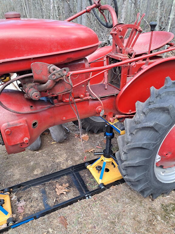

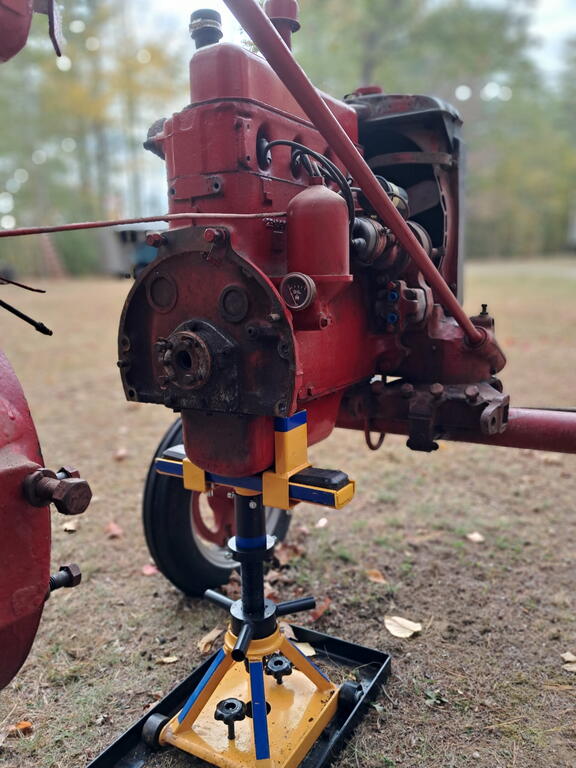

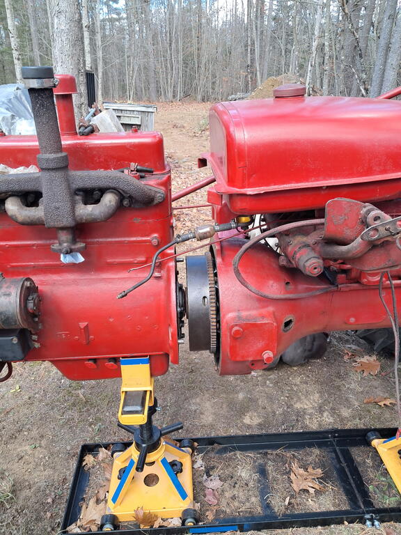

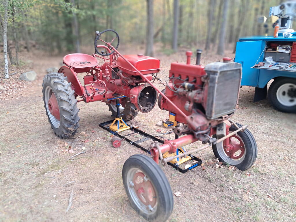

Handy Don
1 hour ago, JCM said:
Ingenious jack/support system!
  • Like 6
  • Thanks 1

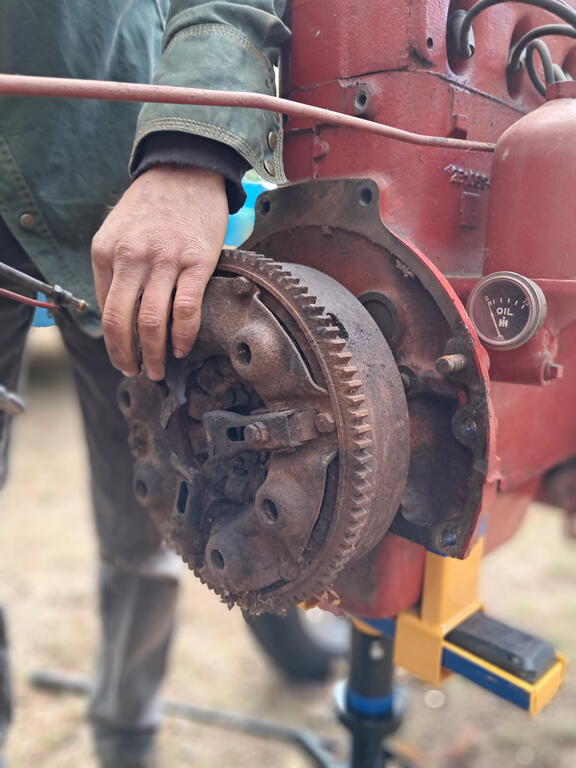

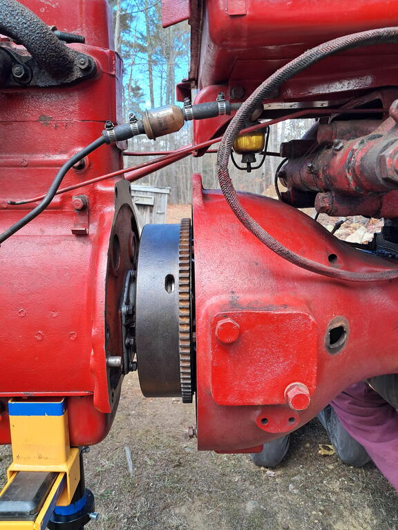

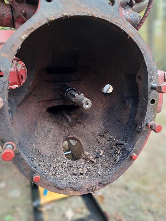

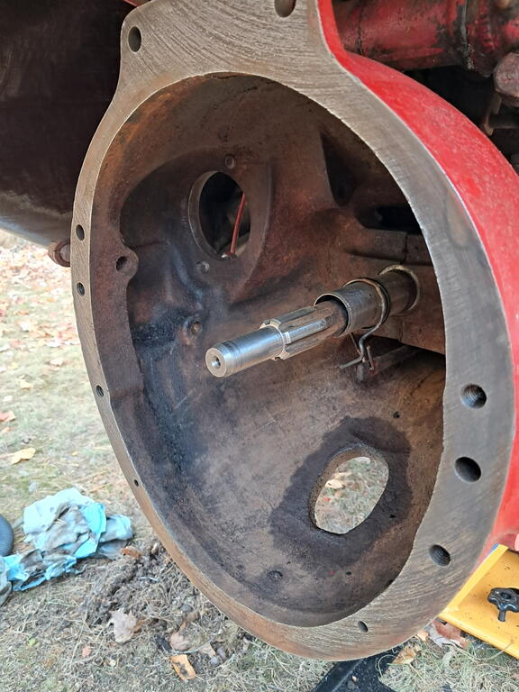

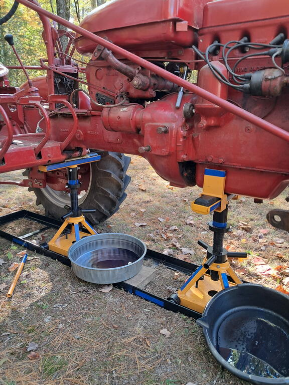

JCM
Going back together pics.
  • Like 3
  • Excellent 3
  • Thanks 1

Bill D
Please tell us more about it.  Who makes it?
JCM
Sorry but I don't have that answer. That was brought here to do the clutch job. I believe he has 3 or 4 of those set ups. I did not see a name on that equipment.   @Bill D

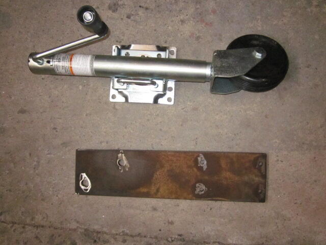

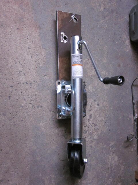

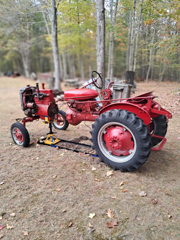

T-Mo

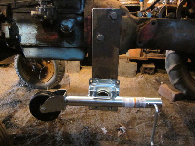

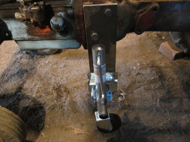

When I split my Farmall B, I bought a heavy duty trailer jack from TSC, the kind with the double casters.  Bought a piece of heavy duty 1/2 steel plate and boltedi it to the jack to kit.  Then place that against the tractor, to see where the two implement holes were on the transmission torque two.  Drilled two holes just below that point.  Then bolt the plate with the jack bolted on to the tractor.  After splitting the tractor, just roll the back half away from the front.
I hope you wedge the front axle before you split the tractor.
https://www.tractorsupply.com/tsc/product/traveller-14-in-2000-lb-dual-wheel-trailer-jack-1227931
Below is similar to what I did to split my B.
  • Excellent 3
JCM
Yes @T-Mo front axle was wedged before the split. Zoom in above the left front axle and you will see a 4x4 block doing it's job.
  • Like 1

squonk

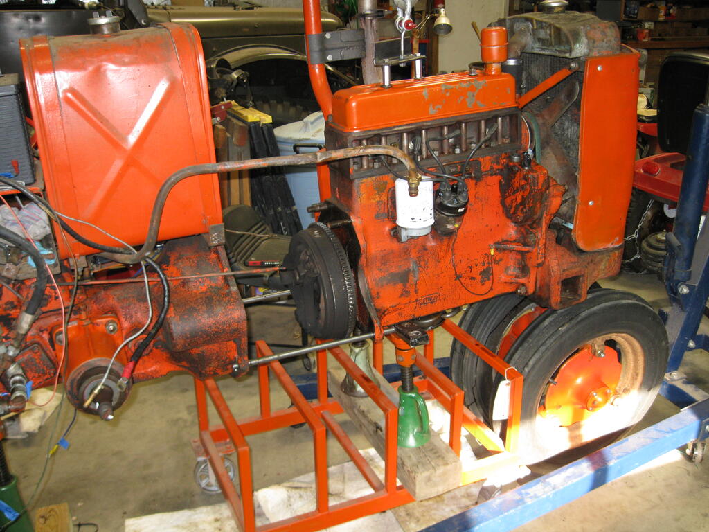

When I split my Dad's Allis B I used a chain fall on the front, engine crane on the rear. I had to replace the center section so I used an old air/hyd axle jack for that

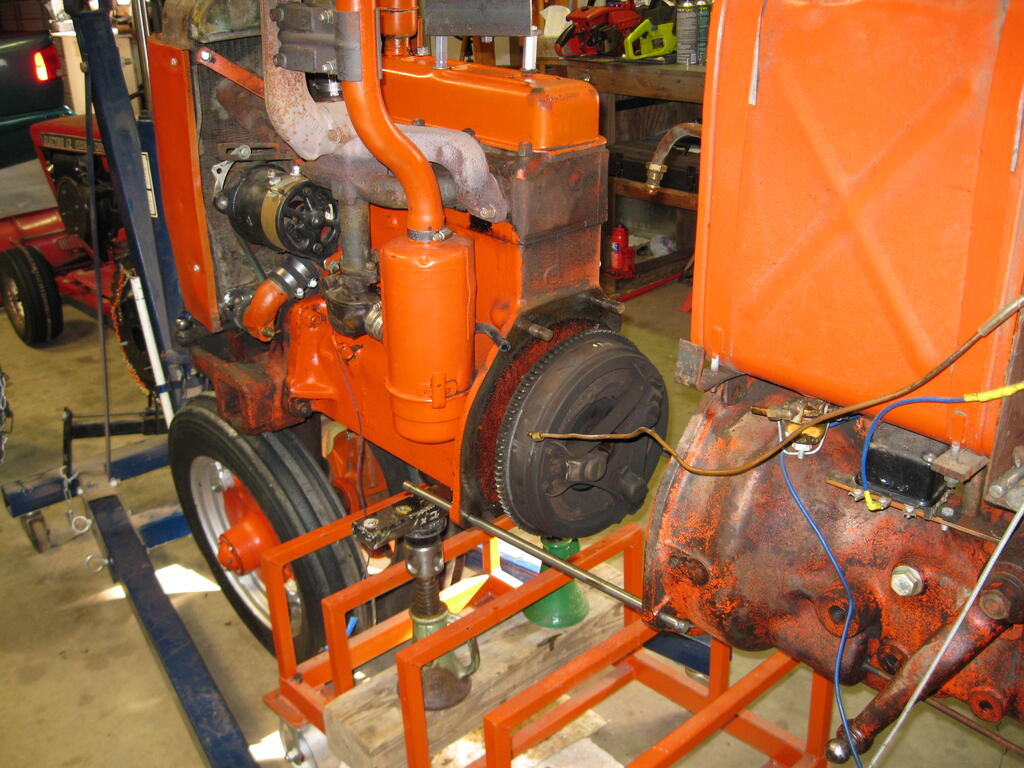

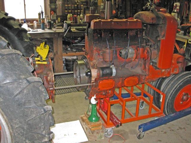

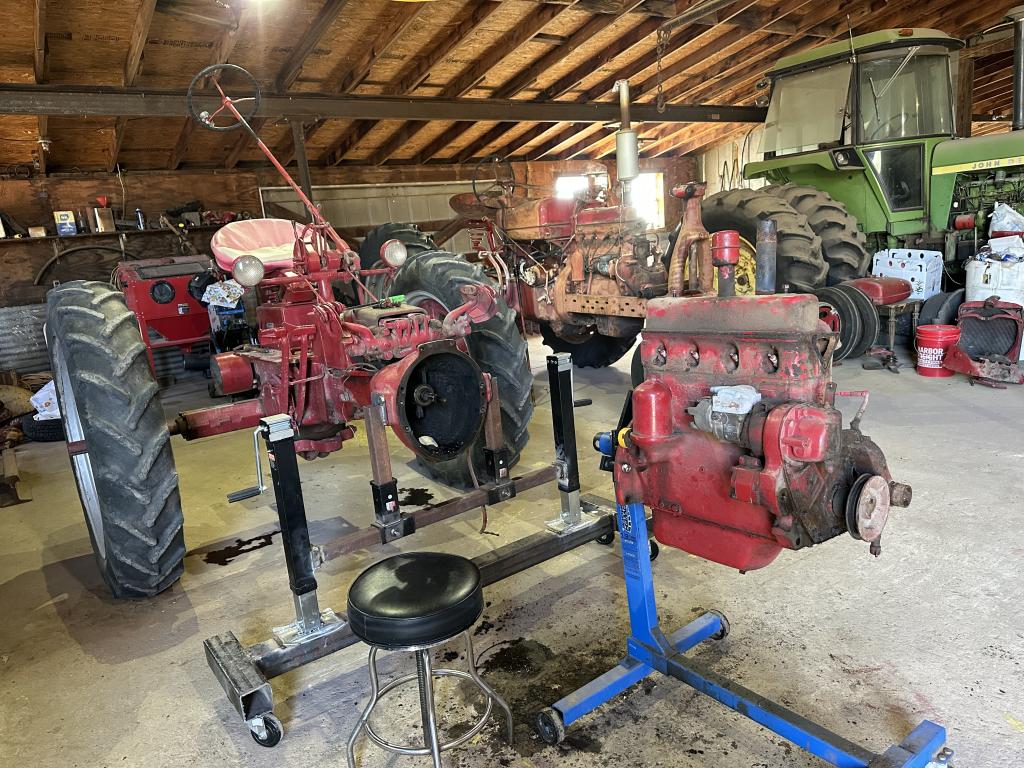

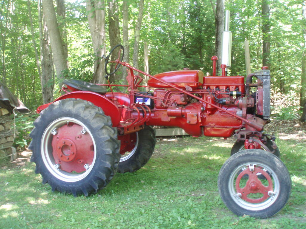

ClassicTractorProfessor

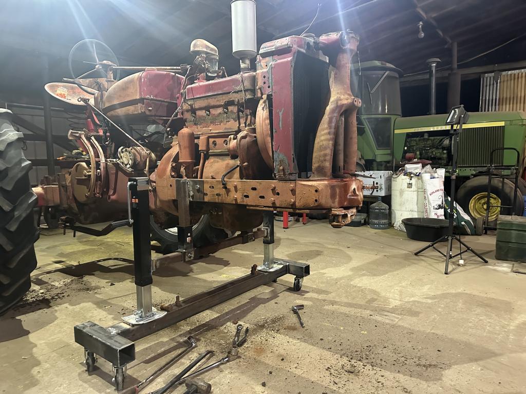

I did something very similar to what @T-Mo did when I built my splitting stands, but engineered them a bit differently so that with different adapters they would work on several different tractors. Here they are under my M when we swapped the wide front axle out for a narrow, and again under my C when I pulled the engine for a rebuild
IMG_3542_Original.jpeg.20380aa445ece3c6dc5b4ac8a6ef35a5.jpegIMG_4233_Original.jpeg.fb04da4f9eda69bfdb7d1090c99b6ee8.jpeg
@JCM good looking Super A you have there. Those smaller Farmalls are some of my favorites. Recently picked up this 1940 A from my late friend Rodger’s collection and got it running again. It’s probably my favorite tractor out of all of them.

oliver2-44
I saw Steiner has those for sale
  • Like 2
JCM
I received a parts order from Steiner last week along with a nice several brand tractor parts catalog and noticed those were available.   :handgestures-thumbupright:
