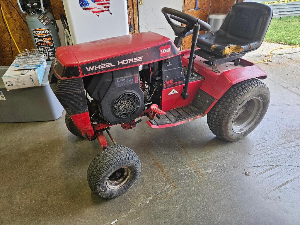

Derek W 31 #1 Posted October 26, 2025 I finally remembered that I hadn't shared a pic of my "new to me" 312-8. It's got some rust but, all in all, it's in pretty good condition and it runs real well. I'm currently hunting around for a muffler for it because the exhaust pipe looks like it was ripped off. The tractor came with a large "stack" style muffler but I don't want to use it. I'd really rather have an exhaust and muffler that sits closer to the engine. Anyway...here's a picture of my Wheel Horse 3 1 1 Share this post Link to post Share on other sites

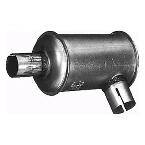

953 nut 67,468 #3 Posted October 26, 2025 Several people have been using a Gravely muffler and are happy with it. 3 Share this post Link to post Share on other sites
gwest_ca-(File Mod) 12,369 #4 Posted October 27, 2025 Description: Muffler - Found on older garden tractors with 12 Hp thru 16 Hp engines. Measures: 8-1/4" L X 3-3/4" OD; Inlet ID: 1-5/16", Outlet ID: 1-1/4" Replaces Gravely 11203, 18543 and 20259700 1 Share this post Link to post Share on other sites

gwest_ca-(File Mod) 12,369 #12 Posted October 28, 2025 14 hours ago, gwest_ca said: Description: Muffler - Found on older garden tractors with 12 Hp thru 16 Hp engines. Measures: 8-1/4" L X 3-3/4" OD; Inlet ID: 1-5/16", Outlet ID: 1-1/4" Replaces Gravely 11203, 18543 and 20259700 If I remember correctly the 16hp Gravelys were a twin cylinder so twin mufflers - one for each side. I would not want to use a single muffler on anything larger than 12hp. 1 Share this post Link to post Share on other sites

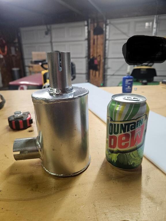

Derek W 31 #13 Posted October 30, 2025 I appreciate the muffler suggestion. I went ahead and ordered one and it arrived today. It's smaller than I thought it would be but that's a good thing. I held it in place and I like the look. I just need to get some tubing and get this welded up. 3 Share this post Link to post Share on other sites
