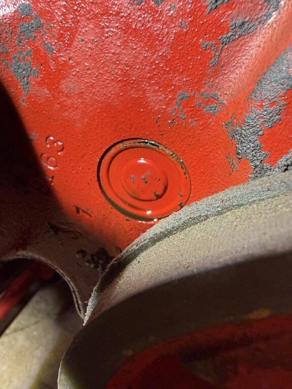

thekevin 51 #1 Posted October 24, 2025 This is on my 69 Raider 12. When I got it the transaxle was full of water. It didn't have any fluid in it at all, just water. I drained all of the water out and then filtered some used motor oil I had and filled the trans up with that to try and combat any rust that might have been in there. I did that last night and when I went out to the garage today I had a lake of oil in the floor. I power washed off the trans and it is leaking out from around the cap bearing. I am not interested at all in tearing this thing down. What are the chances I can seal it from the outside and at least slow it down enough just to use thing as a mower. 1 Share this post Link to post Share on other sites
kpinnc 19,107 #2 Posted October 24, 2025 10 minutes ago, thekevin said: What are the chances I can seal it from the outside and at least slow it down enough just to use thing as a mower. May be pretty good. The trouble will be cleaning the cap bearing enough to get something to stick to it. Does it have a pin hole from corrosion or what? Odd that it never moves but somehow started leaking. Share this post Link to post Share on other sites
wallfish 20,744 #3 Posted October 24, 2025 11 minutes ago, thekevin said: What are the chances I can seal it from the outside Clean, clean, clean it. No oil residue left at all. Then clean the oil off! LOL (Nothing will stick to oil) Use some sand paper after that to remove the paint or at least rough'n it up. Seal it with an oil resistant compound such as Seal-All or one of the Permatex oil resistant products and then press a washer of the appropriate size into that sealant to cover and protect it. Yes you could use something like JB-Weld epoxy too but that epoxy stuff gets hard so the next guy will certainly have a much harder time cleaning it off to change the plug. That's just worth of backyard hammer mechanic advise to get'er done. 4 2 Share this post Link to post Share on other sites
WHX?? 58,388 #4 Posted October 24, 2025 Like KP said getting it clean enough. JB weld might work. Guessing you might be putting a band aid on a bullet hole tho. Something caused it to crack and if you don't find out what it is more damage may happen. 5 1 Share this post Link to post Share on other sites
thekevin 51 #5 Posted October 24, 2025 I am wondering if it maybe was the water in it freezing and pushing it out like a freeze plug. 3 Share this post Link to post Share on other sites
WHX?? 58,388 #6 Posted October 24, 2025 Possible... corrosion from the water and wear due to lack of oil doesn't help. Be interesting to see the rest of the bearing and the shafr beyond. Any signs of other seals leaking? Share this post Link to post Share on other sites

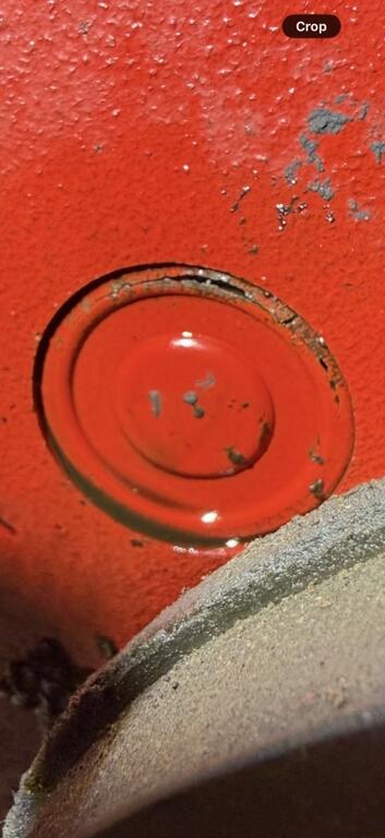

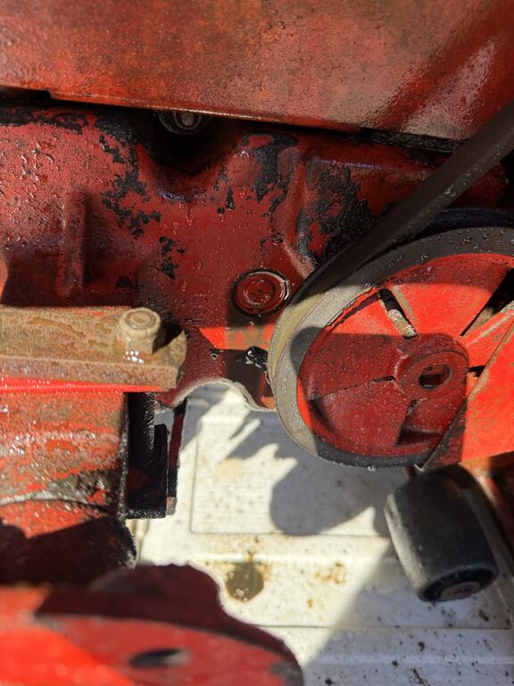

thekevin 51 #7 Posted October 24, 2025 I was able to get a better pic of it and it's way worse than what I thought. The axle bearing and the other cap bearing behind the main drive pulley are also leaking a little bit as well. This isn't looking good. 4 Share this post Link to post Share on other sites
kpinnc 19,107 #8 Posted October 24, 2025 (edited) Wow. I say split and fix the right way. Either a heck of alot of pressure or corrosion did that. Or both... If the outer caps are deformed like that, you have to wonder if other sections internal of the race are as well. If either of those needle bearings fail, that main shaft will misalign and could destroy the transmission. Short term you can clean it well and spackle on some Flex Seal or similar. You just want to hold the oil in it. I wouldn't use anything epoxy-like because of the difficulty it could cause later. Edited October 24, 2025 by kpinnc 2 1 Share this post Link to post Share on other sites
ri702bill 13,393 #9 Posted October 24, 2025 4 hours ago, kpinnc said: If the outer caps are deformed like that, you have to wonder if other sections internal of the race are as well. If either of those needle bearings fail, that main shaft will misalign and could destroy the transmission. Any loose needles inside the Unidrive will surely find their way into the mesh of gear teeth at the wrong time and irrepairable damage will occur to the gears. You MAY wish to drain the oil now and look at what comes out - needles or metal chunks mean it's time to open it up Having that much water in it may have also help gum up the fork detent mechanism too. 4 Share this post Link to post Share on other sites
ebinmaine 81,281 #10 Posted October 24, 2025 6 hours ago, thekevin said: . This isn't looking good. IMHO and experience this bearing is trash. Using a transmission like this will only compound your issues. It needs to come apart. 5 1 Share this post Link to post Share on other sites
squonk 48,427 #11 Posted October 24, 2025 You're wasting time trying to seal it. Tear it down and replace ALL the bearings or get another transmission 4 1 Share this post Link to post Share on other sites
