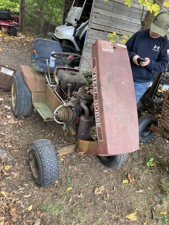

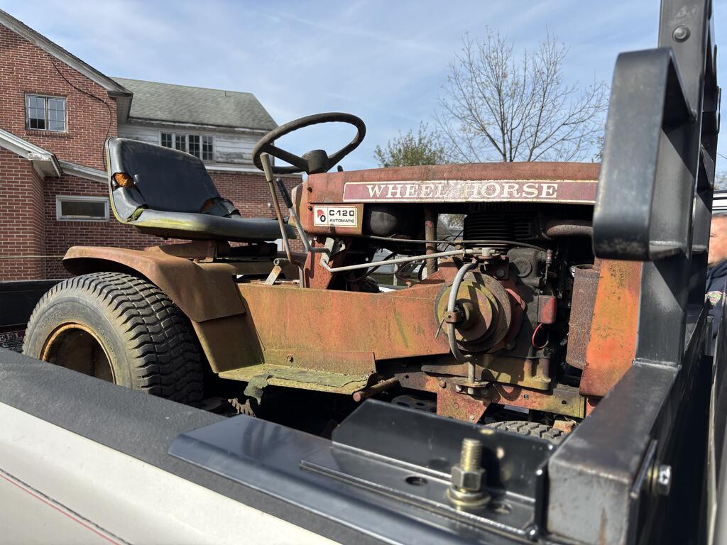

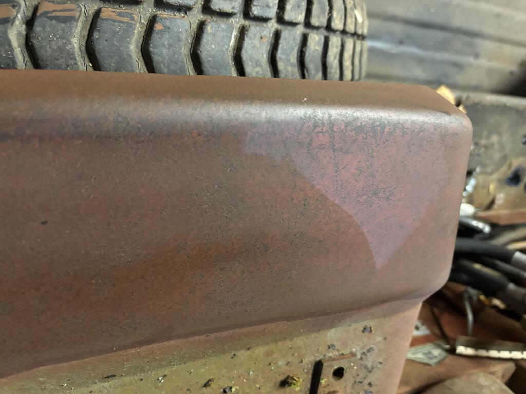

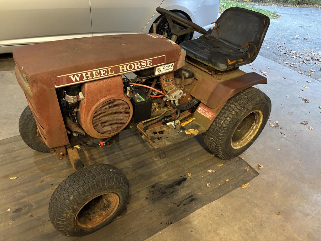

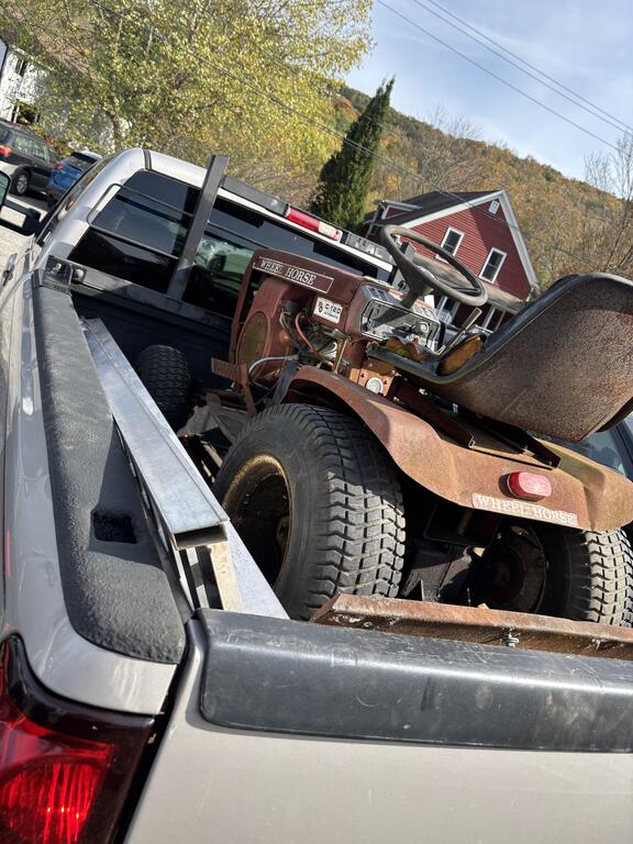

TonyToro Jr. 2,560 #1 Posted October 23, 2025 This past weekend I acquired this tractor from one of the tractor pulling families. They said it ran 4-5 years ago. (Maybe I believe it) Anyway, Over this past week me and @TonyToro have replaced a few ends on the battery cables, new solenoid, good used starter as ants were coming from the old one, all new fuel lines, new ignition switch, carb cleaning, rebuilt the metal Kohler fuel pump, new spark plug and changed the oil. Today we finally got everything put back on and within a few minutes it fired right up. It also came with a snowplow which I believe is a 48”. Needs a good degreasing and a PB blaster and scotch brite pad cleaning. We did a little on the fenders and it came out pretty good and at least smooth. Going to run it for a little bit and change the oil again as it was very black. More additions to come soon as this will mostly be a plowing snow and dozer blade work tractor. Enjoy the pictures! IMG_1006.mov 6 11 Share this post Link to post Share on other sites

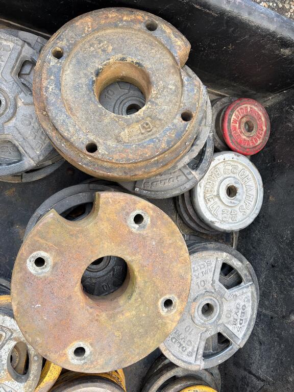

TonyToro Jr. 2,560 #10 Posted November 1, 2025 (edited) Completely forgot to post pics of the wheel weights but here they are. Could not find any marks or labels besides a 61 Edited November 1, 2025 by TonyToro Jr. 3 Share this post Link to post Share on other sites

oliver2-44 11,847 #13 Posted November 5, 2025 On 11/1/2025 at 11:50 AM, TonyToro Jr. said: Completely forgot to post pics of the wheel weights but here they are. Could not find any marks or labels besides a 61 Those look similar to Sears/Craftsman weights I have. 33lb. Share this post Link to post Share on other sites
TonyToro Jr. 2,560 #14 Posted November 5, 2025 7 minutes ago, oliver2-44 said: Those look similar to Sears/Craftsman weights I have. 33lb. Definitely more then that I weighed those are are about 60 a piece. But maybe by sears I’ll have to do a little more research. Share this post Link to post Share on other sites
