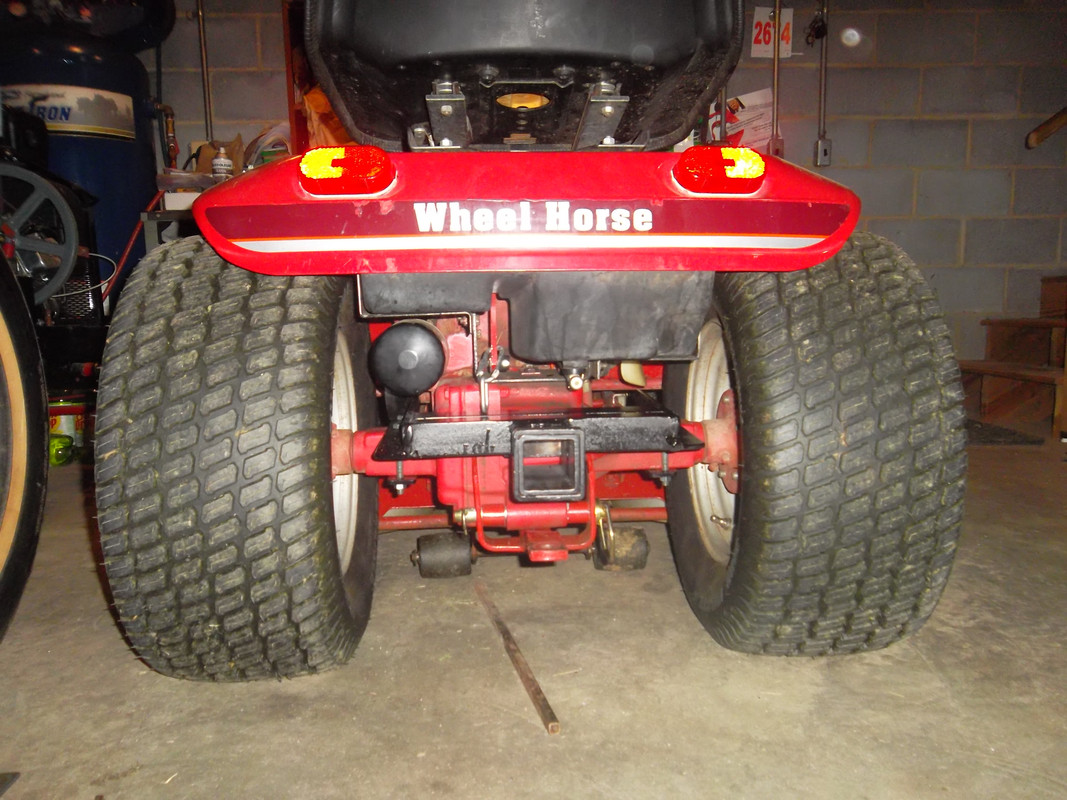

Lee1977 7,462 #16 Posted October 10 It's not a C-175, but this is the location of the trans. filter on an Eaton. 1 1 Share this post Link to post Share on other sites

953 nut 63,105 #20 Posted October 10 If it is a Sundstrand it would be a 90-1173 as pictured below. The push valve is circled for you. Now go buy it and remember, 3 1 Share this post Link to post Share on other sites
