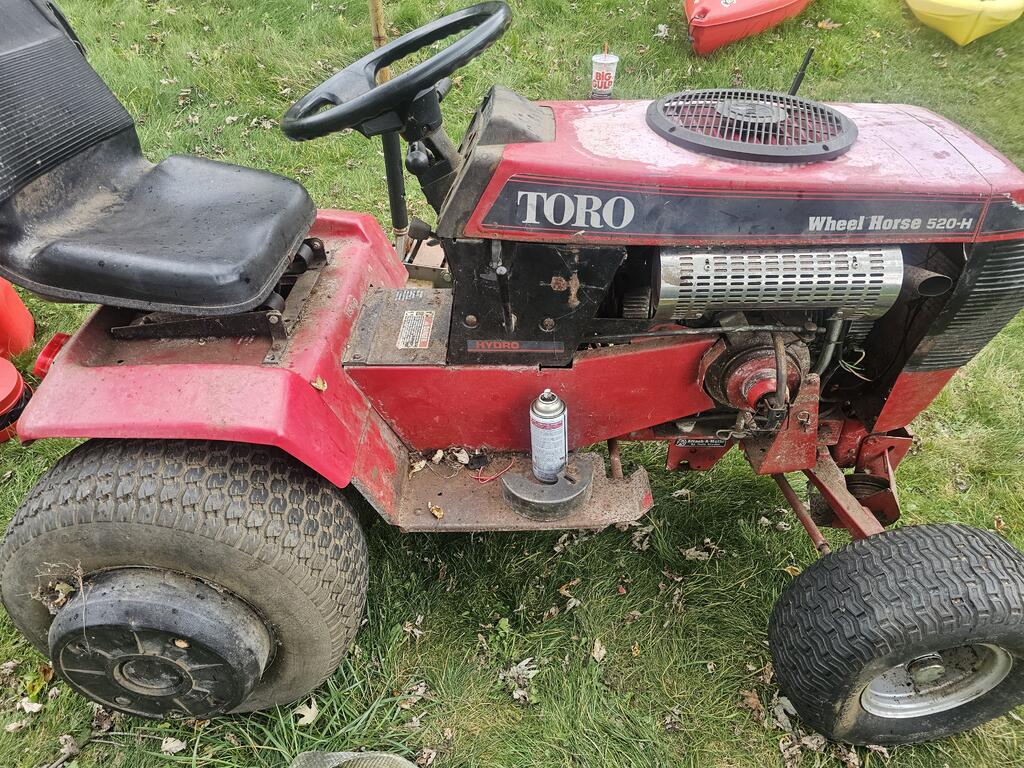

iR8Leprechaun 47 #1 Posted October 7, 2025 I liberated a 520H from a neighbor's shed after probably 18 years of dormancy. Think it is a '93. They parked it because the ignition coil was bad. I spent a few hours searching for any parts that may have been removed before. After I got it home I started troubleshoot everything. First thing I did was track down service/owners manuals and parts diagrams. Ignition coil test confirmed it was faulty. It was only sending spark to one plug. With that confirmed, I moved on to check out fuel system. Tank doesn't leak. Lines are surprisingly good. Fuel pump, no pumpy. Ordered one of those too. Also threw a prefilter in the cart too. Thanks to the speed of the jungle megacorp, I got the parts by noon the next day. I installed the not-so-perfectly fitting coil, and the near perfect fitting fuel pump. Thankfully I knew well enough to pump whatever the fuel pump sent out first into a jar instead of the carburetor. It was unholy. After I was satisfied that it was good gas, I hooked it up to the filter and gave it a crank. It fired right up like it was parked the day before. Smoked like a sonuvagun for a minute, then it stopped and just ran beautifully. After I was satisfied that the engine was good I moved around and started looking at everything else. Tires were dry rotted. Headlights didn't work. Gauges don't work. Hydraulics work. It moves forward and reverse. I spent the better part of day 3 trying to get headlights sorted while I wait for new tires. After all, this is going to be a snow mover first. I started with the bulbs. One good, one bad. Switch was also toast. Jumped the lines to bypass the switch and got 12v to the lights. Still no light. Power to fuse block was good. Fuse was good. Still getting 12v to lights, with no light. Figured loose connection was to blame, squeezed every blade connection and added a bit of wire to the fuse legs to fit the block better. There was light! Installed new switch and lights still worked, success. Gauges still don't work. Well, the HP% Gauge works. And voltage moves, but is wildly inaccurate. Oh well, it runs without them, they will have to wait, unless y'all know some easy fixes. On to the PTO. Here is where I am having a real issue. I can figure out a fair bit on my own without outside guidance, but the PTO setup is all new to me. Is the outer part that attaches to implements supposed to free spin until activated at the lever? I don't really know. Here are a few pictures I grabbed this evening. Serial number is pretty hard to read. 4 5 Share this post Link to post Share on other sites
lynnmor 9,081 #3 Posted October 7, 2025 9 minutes ago, iR8Leprechaun said: Here is where I am having a real issue. I can figure out a fair bit on my own without outside guidance, but the PTO setup is all new to me. Is the outer part that attaches to implements supposed to free spin until activated at the lever? I don't really know. The PTO pulley will spin rather freely when the PTO isn't engaged, you may need to adjust that little brake pad so there is .012" clearance with the lever engaged. That brake does next to nothing and many ignore it. The trunnion is upside down, the pin should go across the top, perhaps you have a loose pivot bolt. Share this post Link to post Share on other sites
parsonsponyz 420 #4 Posted October 7, 2025 What lynmoor said The PTO pulley will spin rather freely when the PTO isn't engaged, you may need to adjust that little brake pad so there is .012" clearance with the lever engaged. That brake does next to nothing and many ignore it. When you have an attachment hooked up it won't spin. 1 Share this post Link to post Share on other sites
iR8Leprechaun 47 #5 Posted October 7, 2025 18 minutes ago, lynnmor said: The PTO pulley will spin rather freely when the PTO isn't engaged, you may need to adjust that little brake pad so there is .012" clearance with the lever engaged. That brake does next to nothing and many ignore it. The trunnion is upside down, the pin should go across the top, perhaps you have a loose pivot bolt. I'll swap the trunnion tomorrow. The brake pad was at about .013 when I put gauges on it. I just assumed the pully would free spin when not engaged. As it is now, turning the PTO will turn the engine over as well. I'm going to pull the clips off and see if I can pull it off, may be seized on. Share this post Link to post Share on other sites
JCM 11,470 #6 Posted October 7, 2025 Nice to see someone saving another 520 instead or parting it out. Good luck with it. Great tractor when properly maintained. 1 2 Share this post Link to post Share on other sites
iR8Leprechaun 47 #7 Posted October 7, 2025 5 minutes ago, JCM said: Nice to see someone saving another 520 instead or parting it out. Good luck with it. Great tractor when properly maintained. I'm trying to save it. It seems pretty solid except for the little things that drive you crazy and when you dig into them you find even more wrong. Maybe in the spring I'll be able to strip it down and really get it going. For the time being, it runs, moves in both directions, and doesn't leak a drop. So I'll take it. 2 Share this post Link to post Share on other sites
Ed Kennell 47,946 #9 Posted October 8, 2025 1 hour ago, iR8Leprechaun said: may be seized on. I never saw one seized. You should see it move in and out when you engage/disengage the PTO lever. Could be the rod is set too short and not allowing it to disengage. to the 1 Share this post Link to post Share on other sites
iR8Leprechaun 47 #10 Posted October 8, 2025 Just now, Ed Kennell said: I never saw one seized. You should see it move in and out when you engage/disengage the PTO lever. Could be the rod is set too short and not allowing it to disengage. to the I totally disconnected the rods and swung the hoop? Out of the way. It was still turning the whole engine. Maybe it just needs a load out on it without being engaged, it did sit for almost 20 years. 1 Share this post Link to post Share on other sites
Ed Kennell 47,946 #11 Posted October 8, 2025 (edited) Maybe try inserting a thin putty knife between the PTO face and the clutch disc. Edited October 8, 2025 by Ed Kennell 1 Share this post Link to post Share on other sites
702854boy 1,245 #12 Posted October 8, 2025 3 minutes ago, iR8Leprechaun said: I totally disconnected the rods and swung the hoop? Out of the way. It was still turning the whole engine. Maybe it just needs a load out on it without being engaged, it did sit for almost 20 years. You may have to take it off and replace the bearings and I'll tag @peter lena so he can explain as I've seen it called, the Greasy Pete treatment. 2 Share this post Link to post Share on other sites
kpinnc 19,107 #13 Posted October 8, 2025 24 minutes ago, Ed Kennell said: Maybe try inserting a thin putty knife between the PTO face and the clutch disc. Also a common practice in my shop is to see how far into the woods I can throw that little brake pad. They fly surprisingly well... The only time it does anything remotely beneficial is if you have no belt on the PTO it will slow the bell down when disengaged, and it won't freewheel when you shut down the engine. It also makes changing implements or replacing a drive belt no longer "tool free". 1 4 Share this post Link to post Share on other sites
oliver2-44 11,847 #14 Posted October 8, 2025 (edited) The PTO on my C101 was seized when I got it. it had set several years. I soaked it with kroil a few days, then worked it with a putty knife and but some small spots of clutch material stayed rust attached to the the PTO face. Rust can have a tight grip! I suggest you replace the fuel hose, even if it looks good on the outside. Ethanol fuel dissolves or makes them crumble from the inside. Also the Molex 9 pin electrical connect is a known corrosion/overheating problem on that machine. While replacements are available new, some have removed them and just soldered the wires together. Edited October 8, 2025 by oliver2-44 1 Share this post Link to post Share on other sites
WHX?? 58,388 #15 Posted October 8, 2025 4 minutes ago, kpinnc said: throw that little brake pad Agreed ... supposed to be their mandatory nowadays blade brake. 38 minutes ago, iR8Leprechaun said: it just needs a load out on it without being engaged Agreed as well ... hopefully just a little stuck. It should slide right off. All parts in the bell are available yet. You came to the right place for all things 520. I have five of them and many others here have them. 2 Share this post Link to post Share on other sites

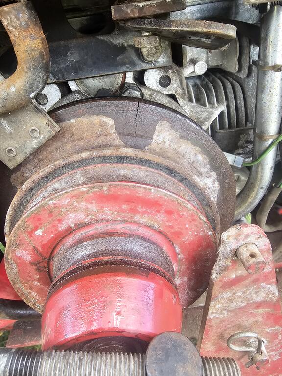

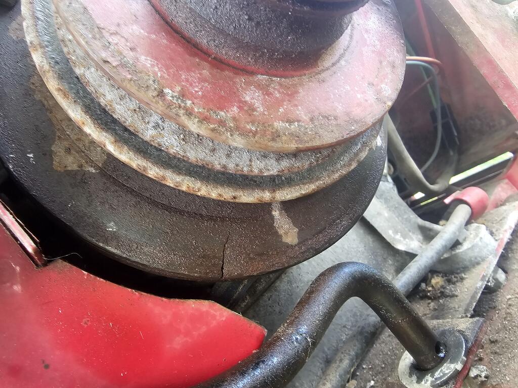

iR8Leprechaun 47 #20 Posted October 8, 2025 It is definitely seized on. The pulley is also cracked in a couple places. Once I pull it off, assuming I can, I'll grind them out and weld it back. Unfortunately, I don't have a lot of what this tractor really needs. Money. Or time. Snow will fly soon enough. Share this post Link to post Share on other sites
Bill D 3,213 #22 Posted October 8, 2025 Cracked in three places. The thrust bearing end is just about snapped clean off. Never seen that before. 1 Share this post Link to post Share on other sites
iR8Leprechaun 47 #23 Posted October 8, 2025 Got it off. Slide hammer FTW. Clutch plate also has a Crack. Needle bearings look ok. Need some grease, but they roll ok. The pulley actually had 3 cracks. Can't figure why it would Crack so many places. Still think I'm going to grind and weld and grind some more. Unless I can find a whole setup for reasonable price. This is all basically a charity project, so I'm not trying to be cheap, buuutttttt I can't afford to be thorough either. At least not right now. Share this post Link to post Share on other sites
