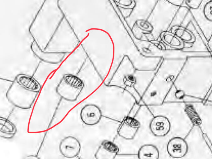

TonyToro Jr. 2,200 #6 Posted September 28, 2025 So I have verified it’s missing this bearing too. I ordered this from WH parts and more. Does the bearing get put in from the inside or the outside of the case? Share this post Link to post Share on other sites
stevasaurus 23,533 #7 Posted September 28, 2025 From the outside toward the inside. The bearing is pressed or tapped in enough to make room for the seal (1/8"). A cap bearing is pressed or tapped in until flush with the ounside of casting. 1 Share this post Link to post Share on other sites

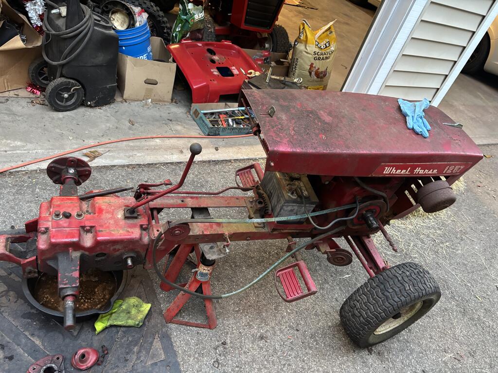

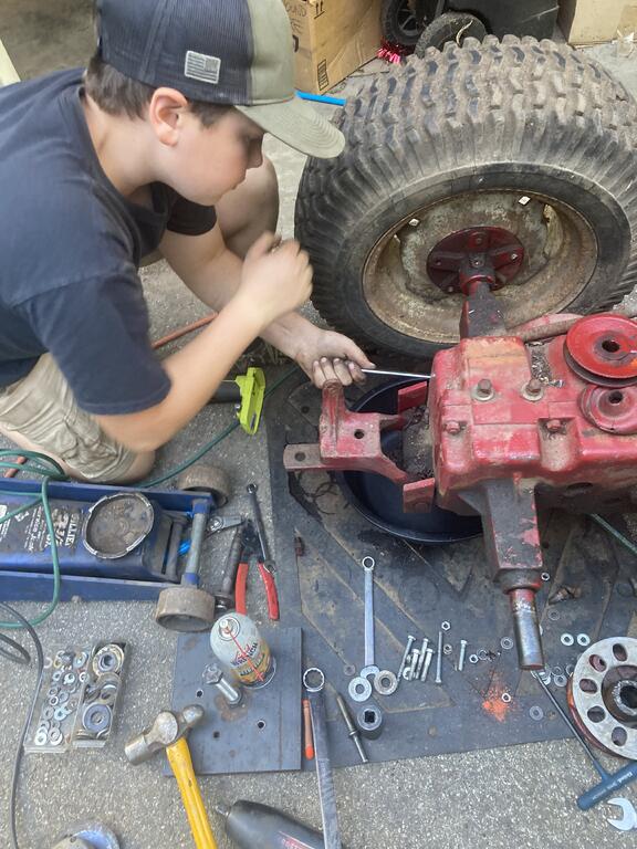

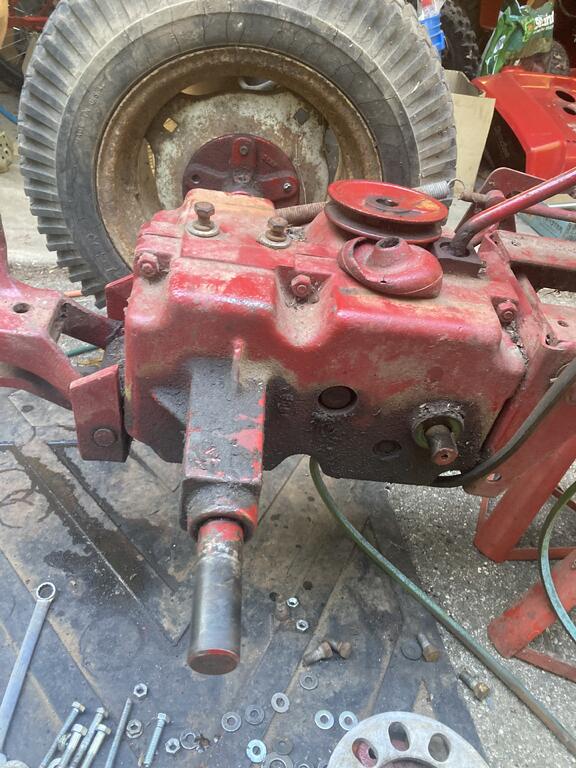

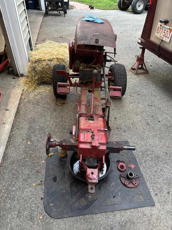

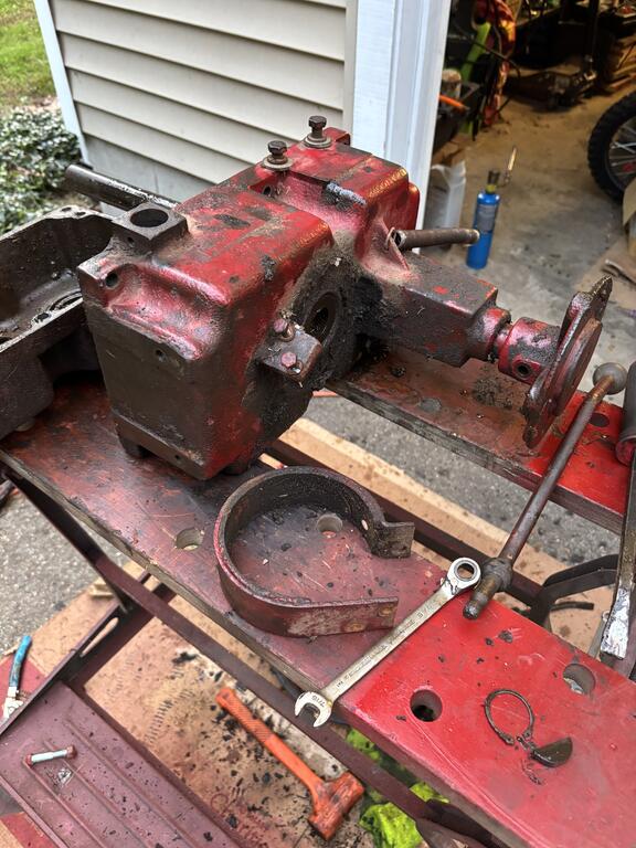

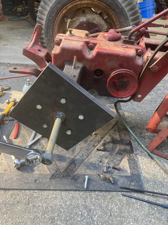

TonyToro Jr. 2,200 #8 Posted September 28, 2025 Today we dug into it. First got the hub and drive pulley off. Then got the hitch pin to move some so we will smash the rest of that out tommorow. Then drained the water from the transmission and soaked all the bolts so we can remove the transmission tommorow and really dig into it. And in one of the pictures you can see how the brake rod is missing that bearing Here’s the pics! 1 4 1 Share this post Link to post Share on other sites
953 nut 63,527 #9 Posted September 28, 2025 Great hub puller. Looking forward to your progress. Share this post Link to post Share on other sites

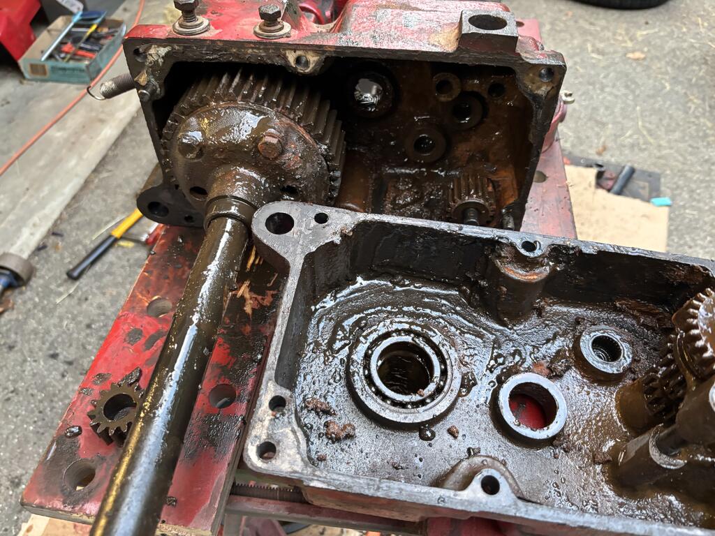

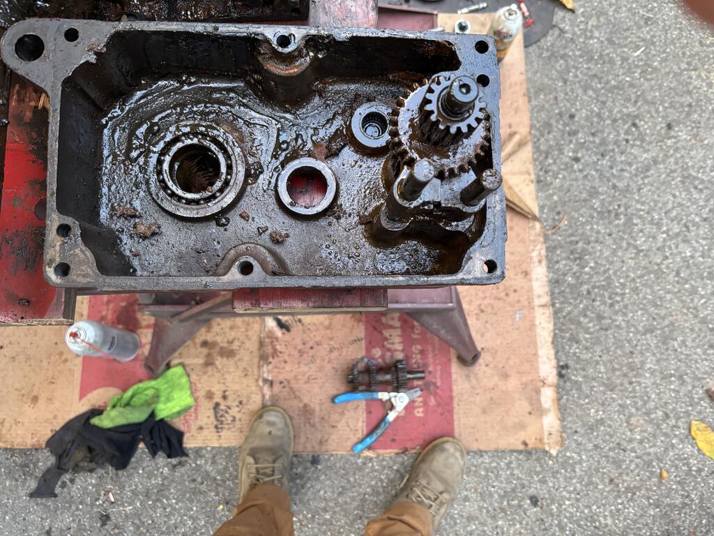

stevasaurus 23,533 #10 Posted September 29, 2025 Actually, missing that cap bearing could be causing your locked up trans issue. The large gear on that shaft is on that end, just on the other side of that hole there. Great pictures...thanks 1 Share this post Link to post Share on other sites
TonyToro Jr. 2,200 #11 Posted September 29, 2025 So I’m kinda glad we pulled the transmission. Look at the pictures @stevasaurus I think you are right. Nothing else seems to be broken. Hopefully the bearing will be here by Thursday. I have the gears and parts socking right now to hopefully clean them. Tommorow I’m going to fully clean the transmission and the inside. 1 1 Share this post Link to post Share on other sites
