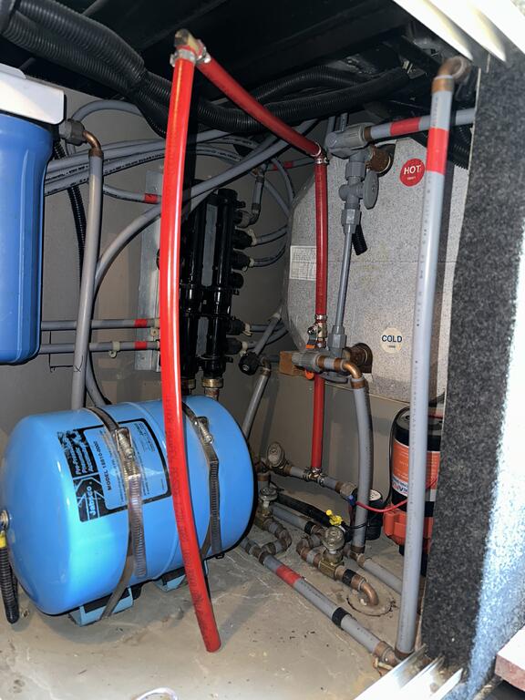

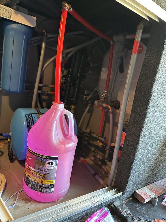

Pullstart 71,241 #75 Posted November 6, 2025 Last weekend, some friends came over to camp in the driveway with their RV one last time before winter. We messed around with the WTFPOS / Dy NASTY getting the water flowing well and running some through the tanks. I wanted to drain the black and grey waters before winter but didn’t have much in there to do so. Once we got the mud out of the filter cartridges, and a clog blown out of the cold manifold with some air pressure, I was ready to make winterization modifications. There are low point drains for the fresh water tank, cold and hot water lines, and they even drain the water heater. I then cut the tube between the tank shut off valve and pump, installed a tee and anther valve, then a hangman style suction tube. It works great to slide into a jug of pink and send it through the system! 2 Share this post Link to post Share on other sites
