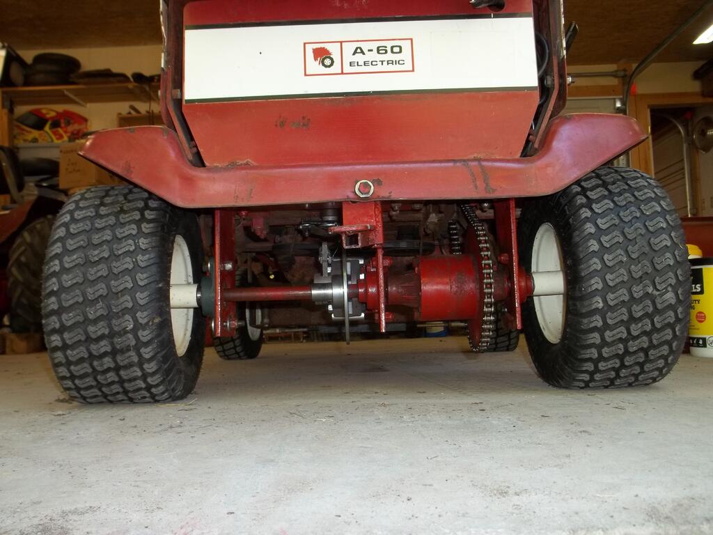

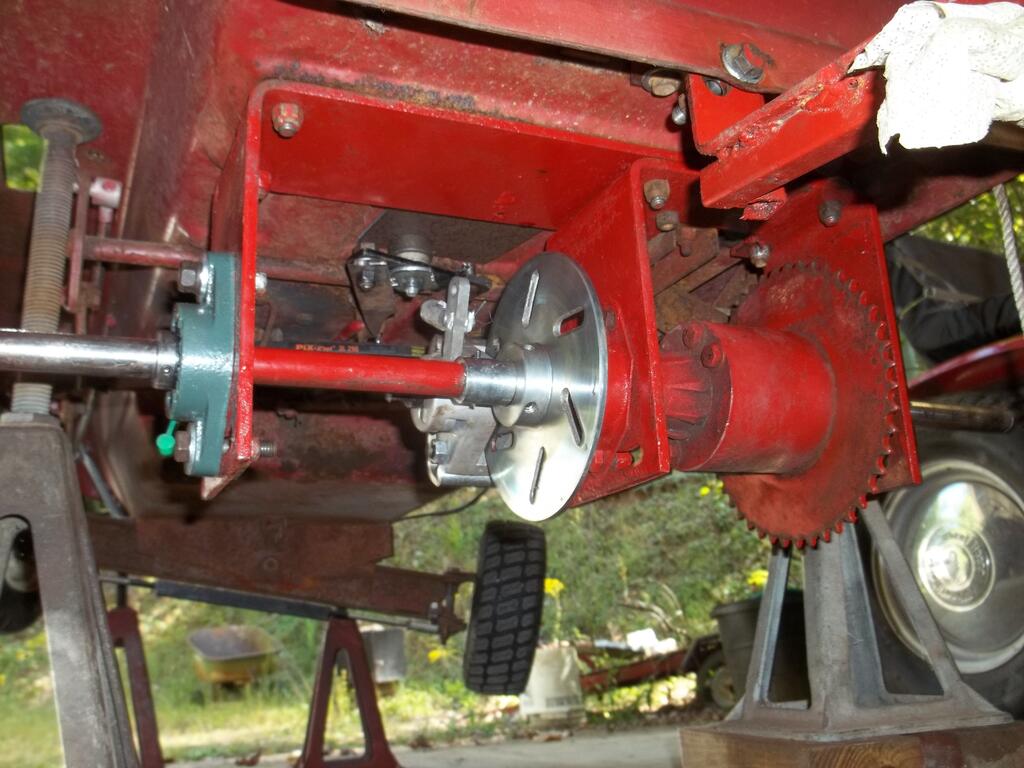

953 nut 69,337 #1 Posted September 18, 2025 My A-60 Electric Wheel Horse has a chain final drive from the transmission to the differential. The master link on the chain gave out so I had my wife tow me to the shop. Since the brakes are on the transmission I had no brakes which got me to thinking. I have a rather steep driveway up to the house and if the chain had let loose there it would be a coaster ride with no way of stopping other than hitting a tree. Not a desirable alternative. I looked the situation over and decided to add a disc brake to the rear axle. Took a little bit of measuring and shade tree engineering but the outcome was well worth it. The disc is much better than the brakes mounted to the Peerless Transmission. 4 15 Share this post Link to post Share on other sites
SylvanLakeWH 32,524 #2 Posted September 18, 2025 Very cool! How about a bit of detail on how you did it? Go cart disc brake? Whats the pillow block for on the left? 1 Share this post Link to post Share on other sites
lynnmor 9,040 #3 Posted September 18, 2025 I guess there is a differential at the chain end which will give one wheel braking and possibly some unpredictable action. Not trying to rain on your parade, just do some slow speed panic stops on various surfaces to see how it behaves. 1 Share this post Link to post Share on other sites

ri702bill 13,068 #7 Posted September 18, 2025 A nice addition indeed. How is it actuated - cable, rod , what ever? Stock brake pedal?? Since there is no apparent chain enclosure, does the chain get full of dirt & clippings?? That disc would be a perfect candidate to be split to allow assembly and removal withour pulling the axle. Has to do that with face & box cams years ago on a fully manual machine with a center line shaft. 1 Share this post Link to post Share on other sites
953 nut 69,337 #8 Posted September 18, 2025 10 hours ago, lynnmor said: I guess there is a differential at the chain end which will give one wheel braking and possibly some unpredictable action. Not trying to rain on your parade, just do some slow speed panic stops on various surfaces to see how it behaves. If the traction at each tire is equal the breaking action will also be applied to both wheels through the differential. With the transaxles on Wheel Horses the tire with the least traction receives the most stopping power. I already did the panic stop test and both rear wheels grabbed. 10 hours ago, SylvanLakeWH said: How about a bit of detail on how you did it? The entire rear end was removed for this modification. Once the axle was out of the carrier I was able to slide the disc onto the axle and position it where I wanted it, the disc has a one inch hole and the axle is 3/4" so a steel bushing was needed and since I couldn't use a key to the shaft I drilled a shallow hole in the axle where the set screw goes in to obtain a good contact. Also used red Loctite on the set screw. A bracket was fabricated to secure the brake caliper mount to the middle axle support and then it was just a matter of connecting the linkage. The rod going to the brakes on the Peerless transmission pushes back so a pivoting lever had to be used to pull the caliper's rod but that just took a bit of time and scrap metal that I already had in my junk storage. Go cart disc brake? Yes Whats the pillow block for on the left? The axle bearing on that end was a bit noisy so I replaced it. 1 1 2 Share this post Link to post Share on other sites
