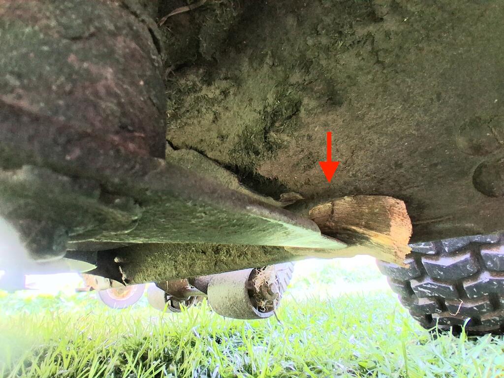

cdeturk 5 #1 Posted September 16, 2025 I start the Raider 12 6 Speed and activated the PTO. The mower acts as if there is excessive drag on the mowing system. The PTO and mower deck turns but you can hear the engine slowing and it eventually conks out. With the mower off, I rotated the belt by hand on the mower deck. While there is friction, it does not seem to be excessive. Here is the odd thing: I rotated the belt by hand at the POT-with the belt side facing the driving being pushed in the down position. There is excessive drag when doing that. I do not understand how there can be no drag when I rotate the belt on the deck, which also turns the PTO, and there is excessive drag when rotating the PTO belt. Any thoughts? 1 Share this post Link to post Share on other sites

953 nut 64,108 #4 Posted September 16, 2025 back off on the belt tension a bit and check the pullies that the drive bely passes over on the way to the mower deck. Could be bearings are going bad on one of these pullies. 1 Share this post Link to post Share on other sites
cdeturk 5 #5 Posted September 17, 2025 Thank you 953 nut. I did that and found that the center pulley, the horizontal one above the center blade, seems to be the culprit. It is very hard to turn. Do you have any advice on what to do now? I assume I should remove that pulley but I'm not sure what happens after that. Share this post Link to post Share on other sites
953 nut 64,108 #6 Posted September 17, 2025 Sounds like it is time to remove the deck, take out the spindle and replace the bearings on it. If your mower deck is the late 1960s or early 1970s deck with hard to find parts it may be more practical replace the deck with a newer one with easy to find blades. @squonk, @rjg854 and others live in the Finger Lakes area and may be able to help you find one. Share this post Link to post Share on other sites

cdeturk 5 #8 Posted September 18, 2025 Found it the source of friction. Thank you, gentlemen. 1 1 2 Share this post Link to post Share on other sites
953 nut 64,108 #9 Posted September 18, 2025 Stuck by a stick. 1 Share this post Link to post Share on other sites
kpinnc 17,150 #10 Posted September 19, 2025 4 hours ago, cdeturk said: Found it the source of friction. That has absolutely never, ever, ever happened to me. But I have wrapped a foot-long piece of rebar around a spindle, wound up a garden hose the wrong way, and picked up more hay bailing twine than I believe has ever been used in this state. And one 5lb piece of wayward tree root... But NEVER what you have pictured! 3 Share this post Link to post Share on other sites
Handy Don 15,934 #11 Posted September 19, 2025 23 hours ago, cdeturk said: Found it the source of friction. 19 hours ago, kpinnc said: That has absolutely never, ever, ever happened to me. ... But NEVER what you have pictured! New one on me, too. So far my fav is the wire fence that came wrapped up in a flail mower that I bought. PO complained that it didn’t cut very well. 2 Share this post Link to post Share on other sites
