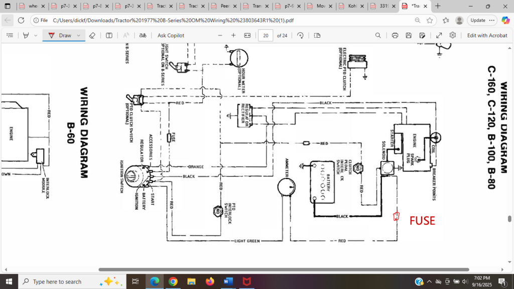

algonac muscrat 0 #1 Posted September 16, 2025 Long story short, I accidentally grounded out my ignition switch. It fried two wires which I am replacing,but. I can't find a wiring diagram so I can make sure i don't make a mistake. I've owned this baby since new, and I know the ignition connector has never been messed with, however every digram I find, does not agree with the ignition switch connector wiring. I've got 4 wires to the switch top is red, orange and green(burnt) next two down and black lower left. Doesn't match anything I've found. 71-10k801-3339. Help! and thanks. Share this post Link to post Share on other sites

gwest_ca-(File Mod) 12,557 #4 Posted September 16, 2025 The switch connector has a unique shape with one wire position say on top with two rows of wires positioned below it. Handy to know what goes to what so one can probe into the rear of the connector without disturbing anything else. There are 2 diagrams with one using an electric pto. Sounds like you are viewing the connector from the front. The diagrams are viewed from the rear of the switch. 1 3 Share this post Link to post Share on other sites
953 nut 70,654 #5 Posted September 16, 2025 The green wire that burned comes directly from the battery through the amp meter. I would suggest adding a fuse on the RED wire coming fro the battery to protect the rest of your wiring from any further damage. 1 1 Share this post Link to post Share on other sites
8ntruck 9,420 #6 Posted September 17, 2025 (edited) Take a close look at the ammeter. As @953 nut says, the battery power goes through the meter. The meter is usually held in the dash with a metal 'U' shaped bracket that bolts on to the terminals of the meter. There are insulating bushings in the mounting holes in the bracket. If those bushings break down, you can get a short through the bracket to the dash, which is ground Others have found that the ammeters develop an internal short. Edited September 17, 2025 by 8ntruck 1 Share this post Link to post Share on other sites
