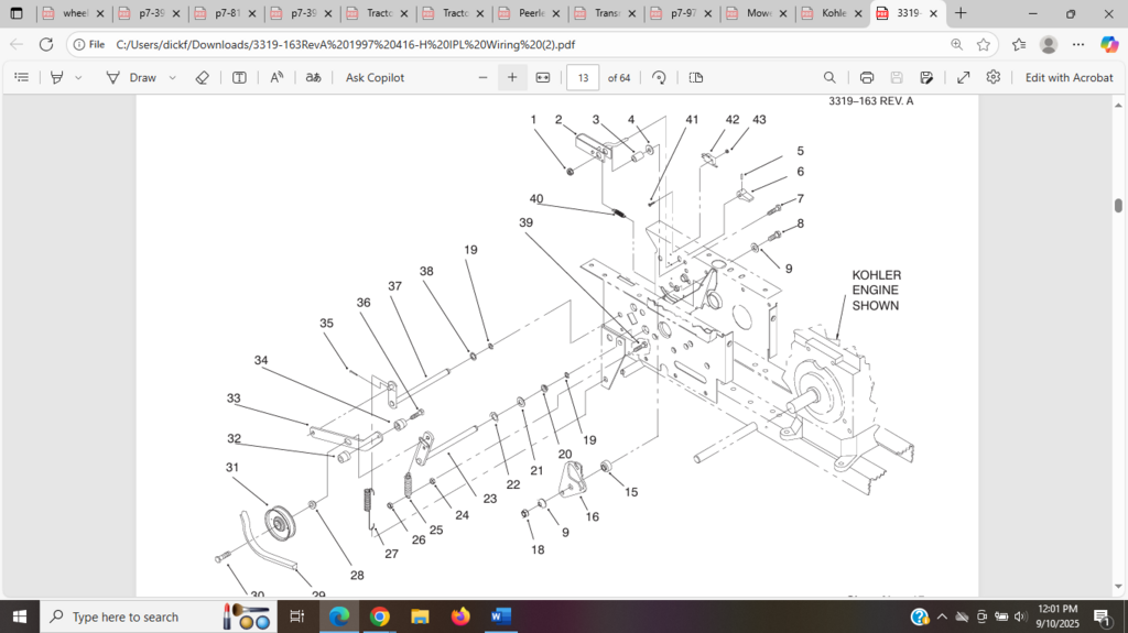

Pat Marchwick 94 #1 Posted September 10, 2025 Living in cold weather can make starting a motor that is connected to a hydraulic pump harder. The models with the pull up double handle belt tensioner release lever allows the engine to start without having to turn over the hydraulic pump. What models or years was this built into the machine? Can this be added to the newer style machines like a 520h with the steering wheel forward reverse lever. I use a two stage blower in the winter for snow removal and it works great for that but would start easier with that belt release option. thank you in advance for your reply’s. Share this post Link to post Share on other sites

kpinnc 19,081 #9 Posted September 10, 2025 10 hours ago, Pat Marchwick said: The models with the pull up double handle belt tensioner release lever allows the engine to start without having to turn over the hydraulic pump. I'm gonna be the naysayer... While in theory this is what was intended, I've never seen one release enough tension to start the engine without spinning the hydro. It will engage the park brake, but it doesn't allow for the engine pulley to freewheel. 1 Share this post Link to post Share on other sites
953 nut 70,541 #10 Posted September 10, 2025 @cleat is doing a restoration on a 416 (same as a 520 with a smaller Eaton). He may be able to give us some information on the interaction between the parking brake and belt tensioner if any exists. 1 Share this post Link to post Share on other sites
Lee1977 7,813 #11 Posted September 11, 2025 My 1989 520-H has the release. I can't say it's complete free, but it won't move even with the parking bake not engaged. Share this post Link to post Share on other sites
WHX?? 58,378 #12 Posted September 11, 2025 (edited) 2 hours ago, kpinnc said: seen one release enough tension All four of the tractors I have with it release it enough KP but yeah correct belt & idlers. You mention snow duty Pat. Des the tractor sit and wait awhile for snow and then start hard with lots of cranking? I guess I ask it 'cause that what my 520 snow machines do. I know what your saying tho the cold oil can actually snub the motor out. They say running synthetic oil helps. Edited September 11, 2025 by WHX?? Share this post Link to post Share on other sites
cleat 9,413 #13 Posted September 11, 2025 (edited) 3 hours ago, 953 nut said: @cleat is doing a restoration on a 416 (same as a 520 with a smaller Eaton). He may be able to give us some information on the interaction between the parking brake and belt tensioner if any exists. Sorry, no release on this or any of my current machines. The release (I believe just on older machines) just lifts the idler pulley up a bit to slightly loosen the belt with no interaction with the parking brake that I am aware of. Edited September 11, 2025 by cleat 1 Share this post Link to post Share on other sites
Ed Kennell 47,866 #14 Posted September 11, 2025 4 hours ago, kpinnc said: I'm gonna be the naysayer... While in theory this is what was intended, I've never seen one release enough tension to start the engine without spinning the hydro. It will engage the park brake, but it doesn't allow for the engine pulley to freewheel. I gotta disagree. I definitely hear the load on the engine increase when I engage the belt. Most noticable at low temp starts. 3 1 Share this post Link to post Share on other sites
Ed Kennell 47,866 #15 Posted September 11, 2025 4 hours ago, kpinnc said: I'm gonna be the naysayer... While in theory this is what was intended, I've never seen one release enough tension to start the engine without spinning the hydro. It will engage the park brake, but it doesn't allow for the engine pulley to freewheel. I gotta disagree. I definitely hear the load on the engine increase when I engage the belt. Most noticable at low temp starts. 1 Share this post Link to post Share on other sites
kpinnc 19,081 #16 Posted September 11, 2025 37 minutes ago, Ed Kennell said: I gotta disagree. I definitely hear the load on the engine increase when I engage the belt. Most noticable at low temp starts. Maybe I just don't use my tractors as often in very cold weather. Snow is very light here and temps are milder overall. OEM belts are also not available, so this may contribute as well. For my use, the release did nothing to reduce hard starts. As such I removed the linkages and replaced with sprung belt tensioning. 2 Share this post Link to post Share on other sites
