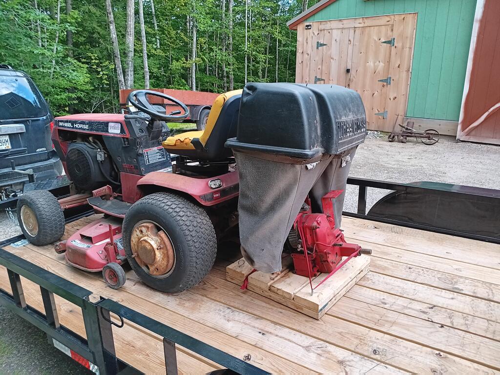

ebinmaine 80,078 #1 Posted August 30, 2025 (edited) Well folks I have this here newly acquired 1994 520H that I knew before purchase does not run. PO states "it clicked" and that was it. I'd like it to back off the trailer under it's own power if possible. Where do I start? @JCM @MainelyWheelhorse @OldWorkHorse @Stepney @Maz91 Edited August 31, 2025 by ebinmaine Corrected year Share this post Link to post Share on other sites

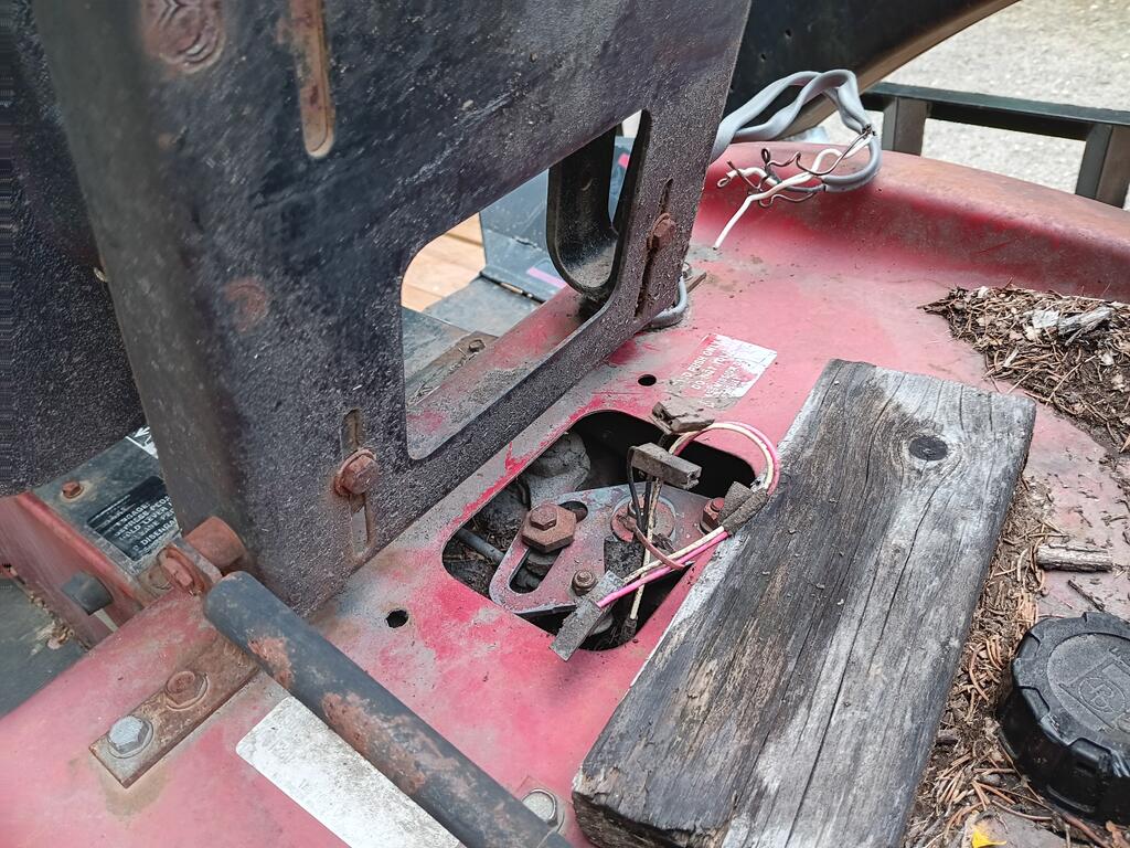

lynnmor 8,970 #2 Posted August 30, 2025 2 minutes ago, ebinmaine said: Well folks I have this here newly acquired 1992 520H that I knew before purchase does not run. PO states "it clicked" and that was it. I'd like it to back off the trailer under it's own power if possible. Where do I start? @JCM @MainelyWheelhorse @OldWorkHorse @Stepney @Maz91 See that light blue wire in the bottom right of your photo? Check for 12 volts between it and ground when you turn the switch to start. Download the demystification guide to see the starting circuit simplified. The seat switch and PTO switch should pass current. 2 1 Share this post Link to post Share on other sites

ebinmaine 80,078 #21 Posted August 31, 2025 Well. Here's a problem... Fuses should not look like a lava bubble. 1 Share this post Link to post Share on other sites
lynnmor 8,970 #22 Posted August 31, 2025 40 minutes ago, ebinmaine said: Well. Here's a problem... Fuses should not look like a lava bubble. If you want to replace the fuse block, Google DORMAN 85668, RockAuto has them for $4.04, and they are available from many auto parts stores for varied prices. A vendor has covers for the fuse block to keep the water and debris out. The contacts are plain brass and corrode making a bad connection that gets hot. Of course you likely aren't interested in the block and can simply install inline fuses as wanted. 1 Share this post Link to post Share on other sites
MainelyWheelhorse 3,008 #23 Posted August 31, 2025 @ebinmaine what does it look like under the fuse? If it’s good, I’d clean it out, and you may be able to swap the fuse to a good one to get it off the trailer. Then strip it down. 1 Share this post Link to post Share on other sites
ebinmaine 80,078 #24 Posted August 31, 2025 16 minutes ago, MainelyWheelhorse said: @ebinmaine what does it look like under the fuse? If it’s good, I’d clean it out, and you may be able to swap the fuse to a good one to get it off the trailer. Then strip it down. It's trashed. Melted. Kaput. The whole end of the actual fuse holder is trash. Also the wire for the VR broke off with a light grazing touch. This wiring is so delicate I've decided to abort the mission. ... for now. 1 Share this post Link to post Share on other sites
