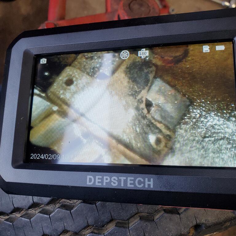

Cjwv1975 117 #14 Posted August 23, 2025 Bought a cheap one on Amazon last night and got today. Tab and gear are all there and its a metal gear too. Looks like some gunk around weights and was able to hit it with some penatrating oil from governor shaft hole. Ill wait a few hrs and see. So if weights move its basically me screwing with linkage setup till its good. 1 Share this post Link to post Share on other sites

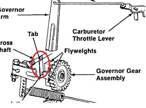

rmaynard 17,612 #15 Posted August 24, 2025 22 hours ago, Cjwv1975 said: Tab and gear are all there and its a metal gear too. I see the gear and fly weights, but where is the cross shaft and tab? Share this post Link to post Share on other sites
Cjwv1975 117 #16 Posted August 24, 2025 1 hour ago, rmaynard said: I see the gear and fly weights, but where is the cross shaft and tab? They are there I just didnt get them in that picture. Its running but I think theres an electrical issue or fuel issue. It'll run for about 10minutes than stop. I can get it to run very briefly with choke but thats it after. I gave up on it for the wknd lol. Share this post Link to post Share on other sites
