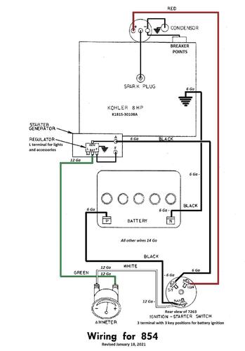

Wiring Color pdf
1 page 267KB

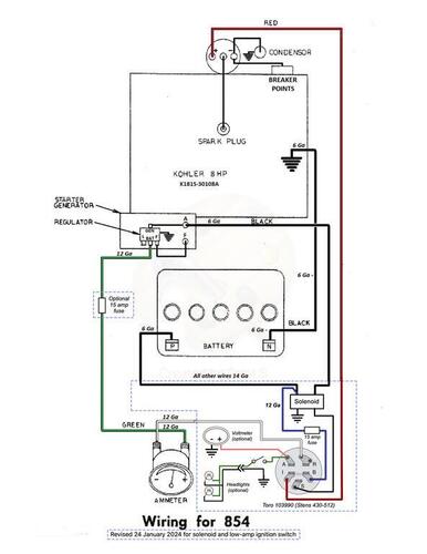

Wiring with solenoid and light duty ignition switch Color pdf
1 page 80KB

Ignition switch 4988 (5/8"-32 threads) replaced by 7263 (9/16"-24 threads)

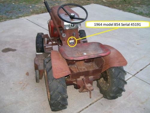

1964 model 854
1964 serial numbers that have shown up for the 854
