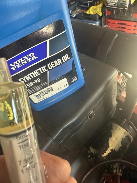

nylyon-(Admin) 8,638 #1 Posted August 11, 2025 Quick tip to fully lubricate your throttle or choke cables. Remove the cable from the engine side. Stick a ¼” vacuum hose over the end of the cable. Using some sort of a syringe which fits on the vacuum line, inject oil or grease into the cable. I used marine gear oil to help with potential water intrusion. Gently squeeze the oil into the cable until it comes out the other end. Work the cable back and forth and viola, cable is fully lubricated. 6 3 4 Share this post Link to post Share on other sites

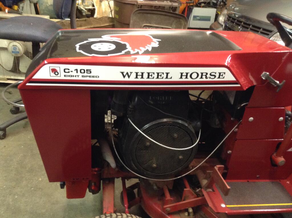

C-85 778 #4 Posted August 12, 2025 Although not very fashionable, I've stripped off all the black plastic outer sheathing on the cable and then soaked the whole cable with oil. I have long thought the black plastic sheathings tends to hold moisture within it and can't escape causing it to rust and fail, that's what I do and what it looks like. Here's a sample. C-85 2 Share this post Link to post Share on other sites

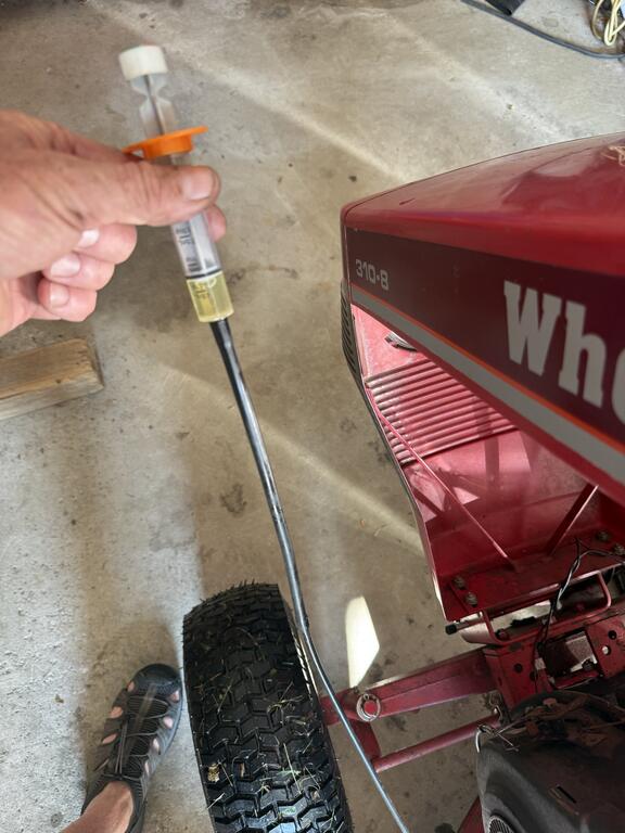

nylyon-(Admin) 8,638 #6 Posted August 12, 2025 Going to do the 310’s tomorrow, I’ll take some pictures to show how it works. Share this post Link to post Share on other sites

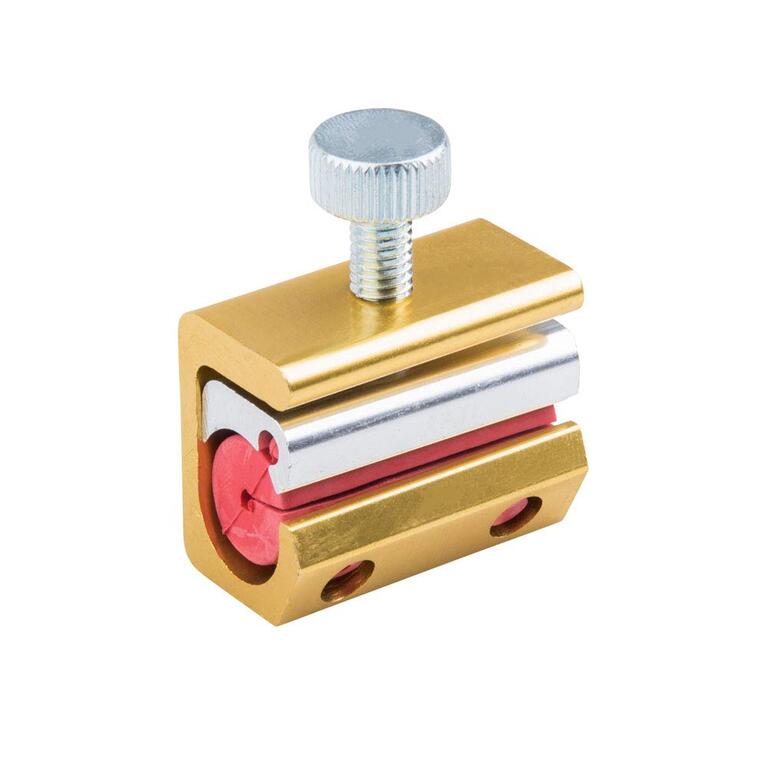

Cee245 850 #7 Posted August 12, 2025 I've had luck with these. I've had several over the years. Usually from losing them, but they hold up well enough. You put it over the end of the cable amd secure it, wrap with a rag cuz its messy and let it run down cable by gravityof possible. I've just used wd40. I was able to free up the choke cable on 2 tractors I recently picked up. 2 Share this post Link to post Share on other sites

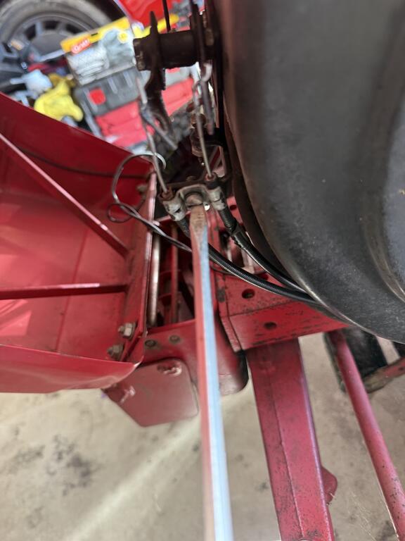

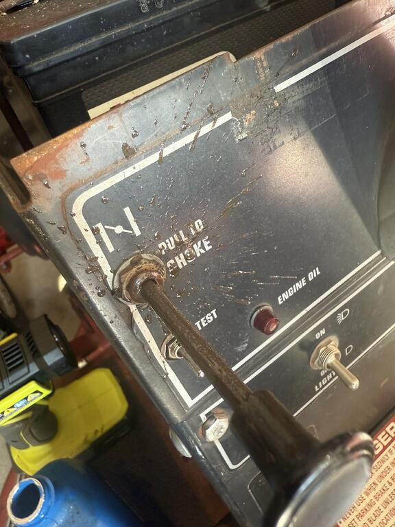

nylyon-(Admin) 8,638 #10 Posted August 12, 2025 Easy to do start by removing the cables from the engine side. On the 10HP Magnum this is 1 screw Add your lubricant of choice to your syringe, I am using a bicycle brake bleeding syringe, but I think a child medicine syringe would work as well. Hint: Don’t add more than you are willing to clean up should the host pop off, or you have leak somewhere. On the cable you will be lubricating, slide the ¼” vacuum tube over the end. Apply firm pressure to the syringe pushing the oil into the cable while working the control on the dash until you see clean oil coming out. Put the cables back on and you’re done. This tractor took all of 10 minutes for the throttle and choke cables. I will probably make this an annual maintenance item should keep the cables moving easily and free from rust. 1 Share this post Link to post Share on other sites
peter lena 9,642 #11 Posted August 12, 2025 @nylyon @ri702bill @JoeM@Cee245@C-85 you are right there , for spring pull assist !# 10 picture ! rectifier mount 2 bolts just above that , add a small piece of PREFORATED metal to bolt point , have any light extension springs to experiment with ? prorated metal to multi holed cable mounts , outer edge for leverage advantage . every time you , move throttle / choke the spring pulls against it , try spring swap for more / less drag assist , every time you move the lever its spring assisted , to close no more hack saw dragging noise . thats what I have . you have the lubrication assist , now add the spring pull , dare you to try it ! talk to me , pete Share this post Link to post Share on other sites

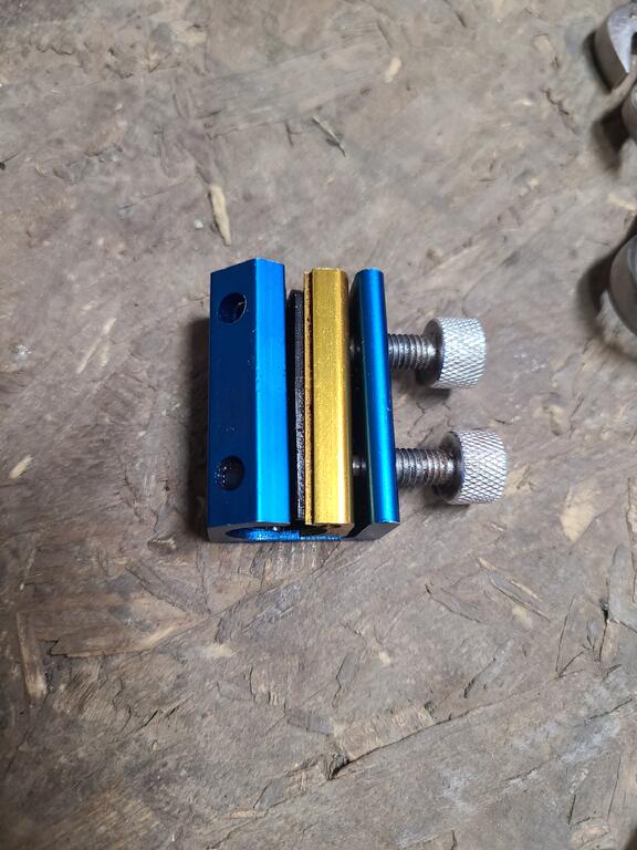

Retired Wrencher 6,262 #12 Posted August 13, 2025 On 8/11/2025 at 8:52 AM, nylyon said: Quick tip to fully lubricate your throttle or choke cables. Remove the cable from the engine side. Stick a ¼” vacuum hose over the end of the cable. Using some sort of a syringe which fits on the vacuum line, inject oil or grease into the cable. I used marine gear oil to help with potential water intrusion. Gently squeeze the oil into the cable until it comes out the other end. Work the cable back and forth and viola, cable is fully lubricated. Nylon I have been using one of these for a very long time. It was originally made for motorcycles, but I’ve been using it on snowmobiles and all my tractors. It works very well. Just my two cents Nylon. Share this post Link to post Share on other sites
nylyon-(Admin) 8,638 #13 Posted August 13, 2025 Same concept Share this post Link to post Share on other sites
