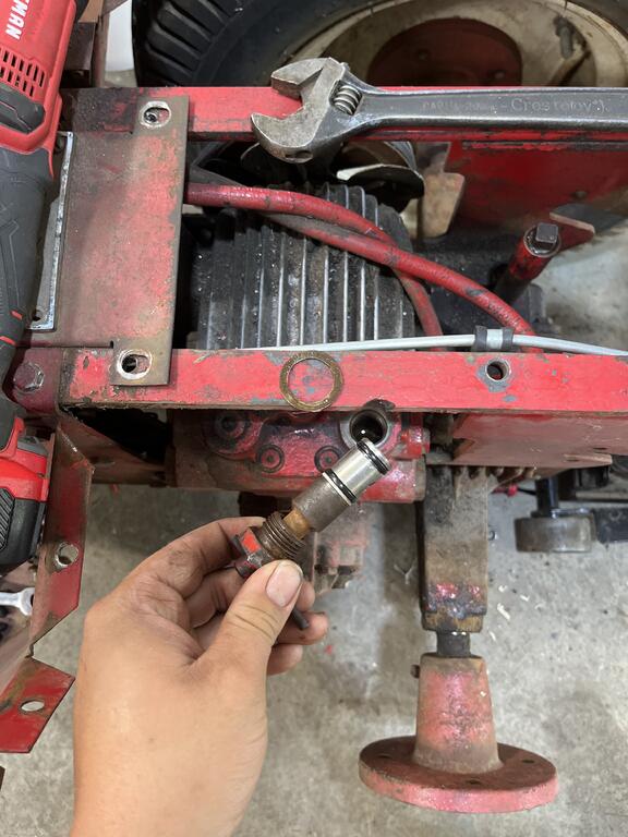

953 nut 69,255 #3 Posted August 11, 2025 The Tow Valve is probably open which allows you to push or pull the tractor around. Once it is closed the transmission will probably operate well. It is not easy to get to but the attached thread should be helpful. Share this post Link to post Share on other sites
Gettysburg Axel 22 #4 Posted August 11, 2025 Thank you for the advice on the tow valve I did change the direction it was facing and still wasn’t moving. It did feel like it could go further. Should the valve stop turning when it is closed? Share this post Link to post Share on other sites
stevasaurus 23,856 #5 Posted August 11, 2025 edited...sorry, my 876 turns in to work and turns out to roll free. Share this post Link to post Share on other sites
pfrederi 21,146 #6 Posted August 11, 2025 (edited) NO the valve is a port valve turn it 180 degress. Handle should face front to back if it does not roll turn it another 180 Edited August 11, 2025 by pfrederi 2 Share this post Link to post Share on other sites
Gettysburg Axel 22 #7 Posted August 11, 2025 So with some messing around I kept turning the valve until it moved. The current position is the only spot it will move. It’s about a 1/6th or so past where it should be. Share this post Link to post Share on other sites
meadowfield 3,190 #8 Posted August 12, 2025 it should in theory drive at 12 and 6 o clock, roll freely and 9 and 3, and perhaps bypass and leak a bit anywhere in between! 1 Share this post Link to post Share on other sites
953 nut 69,255 #9 Posted August 12, 2025 11 hours ago, Gettysburg Axel said: I kept turning the valve until it moved Could be in need of a bit of cleaning and new "O" Ring. The tow valve is not well sealed from the elements and can be a bit rusty. This photo is from the other post I attached earlier. Share this post Link to post Share on other sites

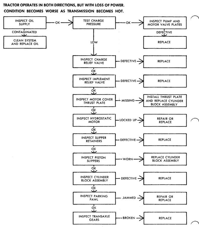

953 nut 69,255 #12 Posted August 18, 2025 6 hours ago, Gettysburg Axel said: On flat surfaces it move around fine. Going up hills it slows to a crawl at full throttle and the direction lever full forward. Couple of possibilities come to mind. The acieration valve springs take a pounding and probably are contributing to this problem. The manual shows where they are located and Lowell @wheelhorseman has them in stock, link attached. The other prospect is the pump and slippers needing a little TLC, @daveoman1966 did a great tutorial on this. https://wheelhorsepartsandmore.com/product/transmission-acceleration-springs-2-7052-9215-2-7264-9858/ Share this post Link to post Share on other sites
