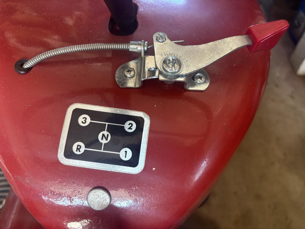

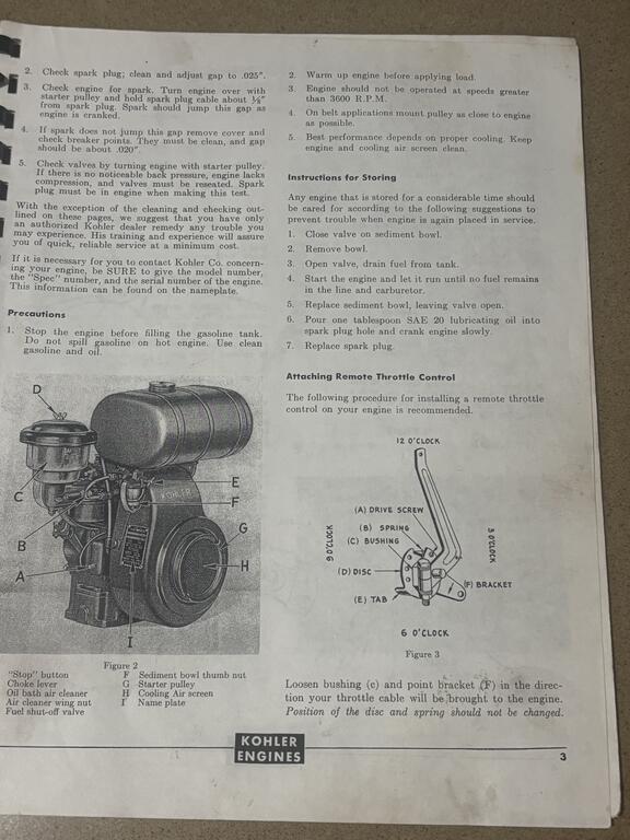

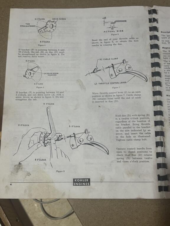

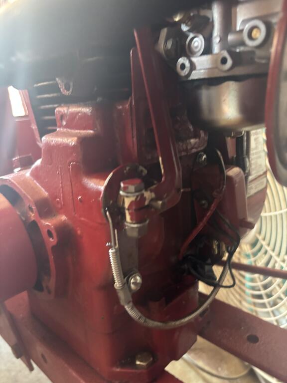

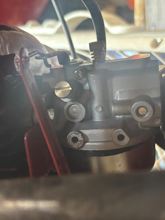

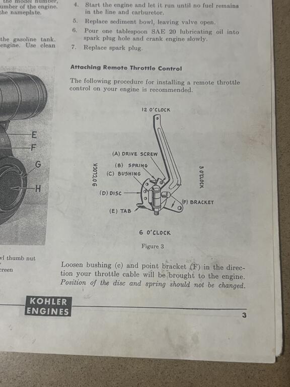

Lane Ranger 12,092 #1 Posted August 3, 2025 Ok. I have been having a difficult time setting my throttle on an RJ i have. I put a NOVA II electronic ignition on this one so it starts second or third pull of the recoil every time! But i use this old k90 kohler manual for yhe guidance. See pics below. i think my governor setting is what is causing me issues with getting the throttle to set correctly. It will idle fine. When i turn throttle handle to increase speed/engine. It will die out. The carb linkage looks correct like my other rjs. The only thing i recall i may have missed is getting the ring on governor at 12 o'clock while manipulating the governor arm and rod to tighten the brass nut behind the governor arm. I may also need to loosen ghe throttle cable in the ring to properly set at 12 o’clock but i have not done that - just thought of it looking at the picture! Lots if things to do in one step at the same time either two hands! I do have the correct thing wrench for hhe governor brass nut behind the governor arm snd that helps s lot! Any suggestions or guidance on setting this throttle/governor from Red Square members would be appreciated! I normally do not touch these governors when setting throttle but this one requires it! 1 Share this post Link to post Share on other sites
wallfish 20,510 #2 Posted August 3, 2025 Throttling up and dying probably doesn't have anything to do with the governor setting. The governor controls RPM when the engine goes under load. I would normally call it a bad condenser first but I believe that Nova replaces both the points and condenser, so next thing would be fuel delivery. I'm not familiar with using those Nova things as all of my K90/91s still use points and condenser set ups. Start the engine and try throttling it up slowly by hand at the carb. You should feel the gov arm pushing back trying to close the carb. If you can throttle it up that way it might be the cable is opening the throttle too fast because there isn't an extension arm on that disc 3 1 Share this post Link to post Share on other sites
953 nut 68,501 #3 Posted August 3, 2025 An engine with retarded timing will start but not respond to the throttle well. If you have the instructions for the NOVA ignition system I would check the timing sequence first. 2 1 Share this post Link to post Share on other sites
Lane Ranger 12,092 #4 Posted August 3, 2025 41 minutes ago, wallfish said: Throttling up and dying probably doesn't have anything to do with the governor setting. The governor controls RPM when the engine goes under load. I would normally call it a bad condenser first but I believe that Nova replaces both the points and condenser, so next thing would be fuel delivery. I'm not familiar with using those Nova things as all of my K90/91s still use points and condenser set ups. Start the engine and try throttling it up slowly by hand at the carb. You should feel the gov arm pushing back trying to close the carb. If you can throttle it up that way it might be the cable is opening the throttle too fast because there isn't an extension arm on that disc Start the engine and try throttling it up slowly by hand at the carb. You should feel the gov arm pushing back trying to close the carb. thanks John ! Good info! Share this post Link to post Share on other sites

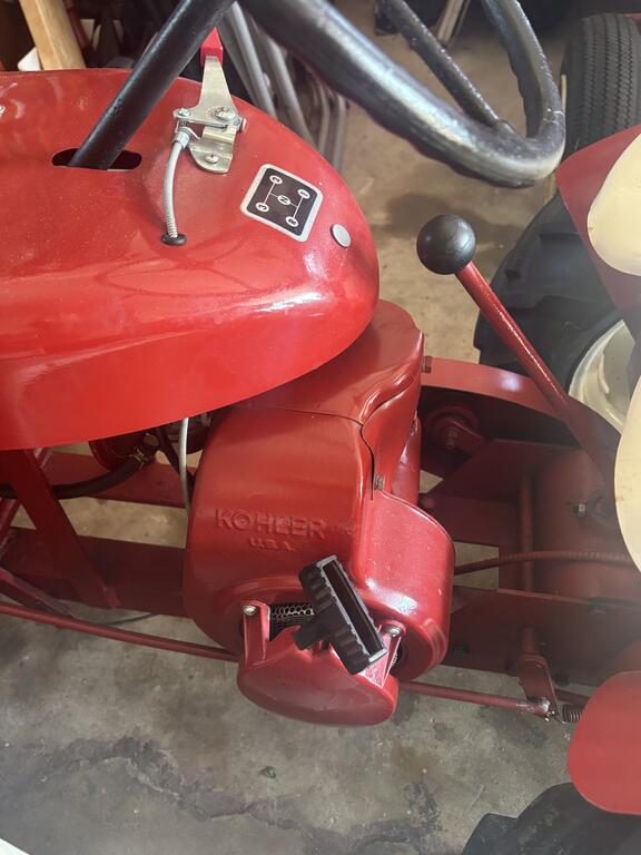

oliver2-44 11,694 #5 Posted August 4, 2025 On 8/3/2025 at 8:54 AM, Lane Ranger said: O Is that shiny carb a newly installed aftermarket? If it is, that could be the problem. They sell the same aftermarket carb to fit K90 through K181. That's a cylinder displacement of 8.9 to 18.8 cubic/in, which is way to large a range. 1 Share this post Link to post Share on other sites
